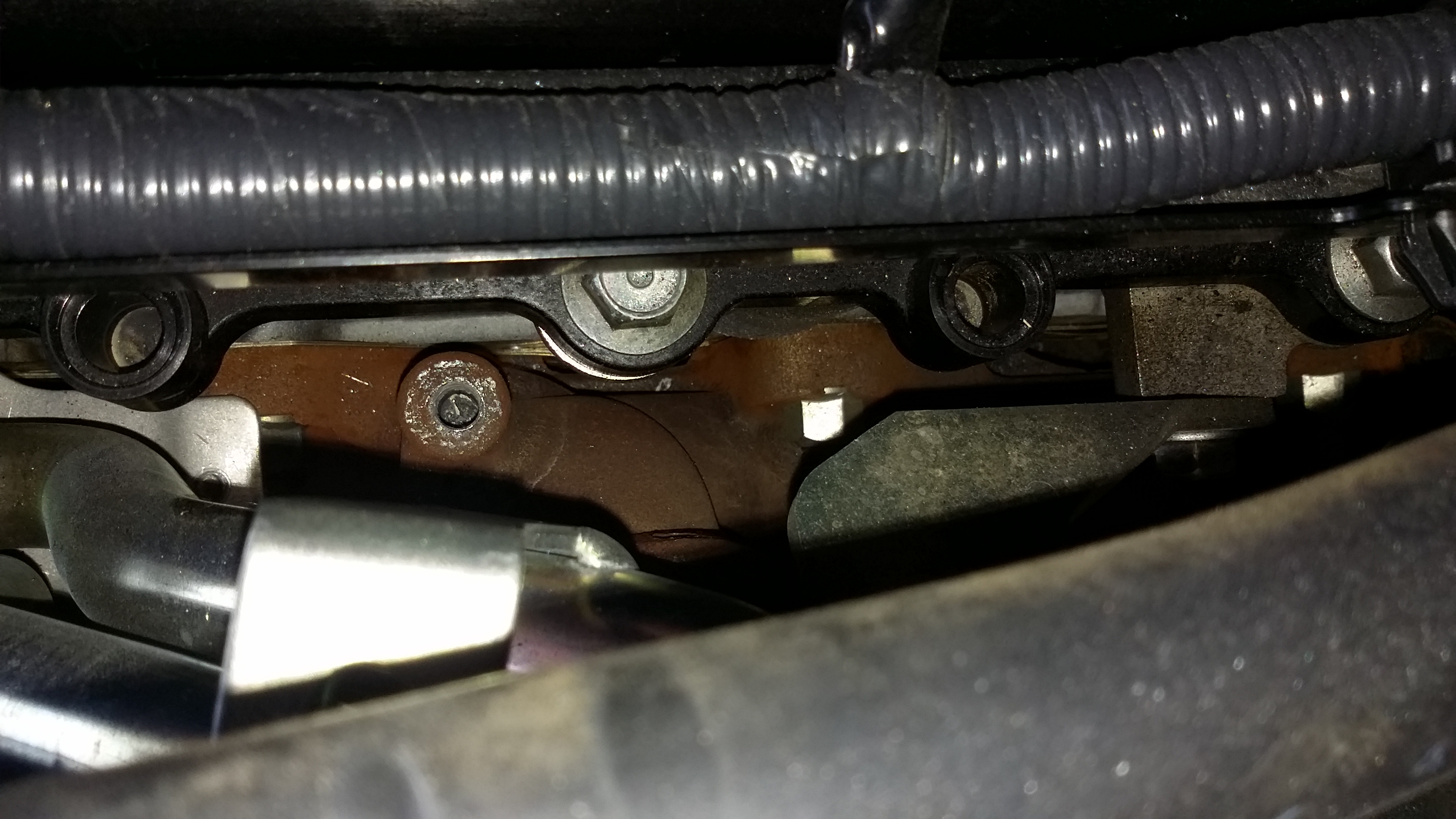

I started stripping the manifold heat shields today. Boy, what a job. There is like no space to work. Lyk of ek aangerand was as jy na my arms kyk :rolling:
I dont no where to fit the probe now. There is barely a header and then the turbo bolts on. And on top of the manifold runs alot of pipes making acess difficult. I must atmit. Im in a jam. Post turbo seems to be the easiest way to go. I dont want to remove the manifold, turbo or water pipes. :helpsign: :helpsign: :helpsign:

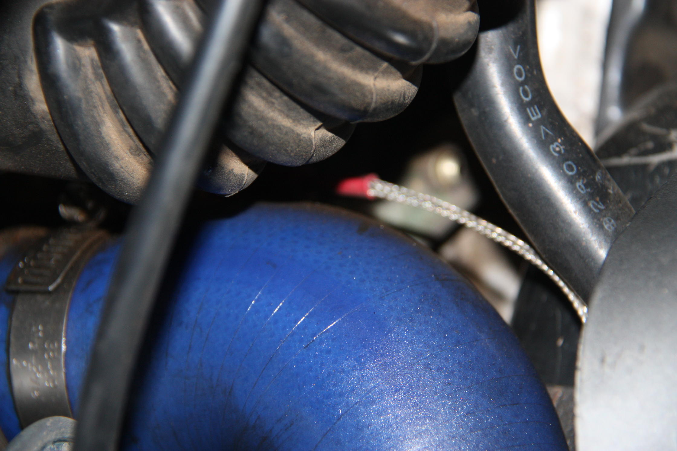

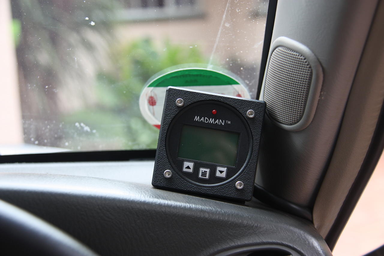

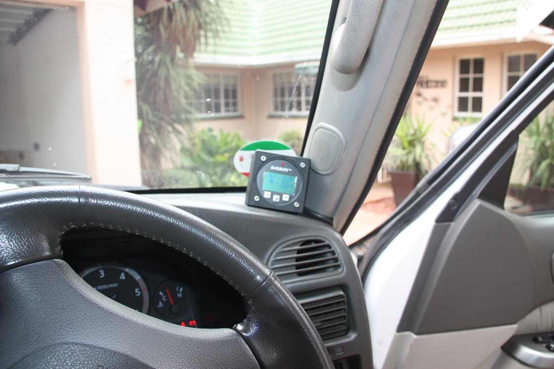

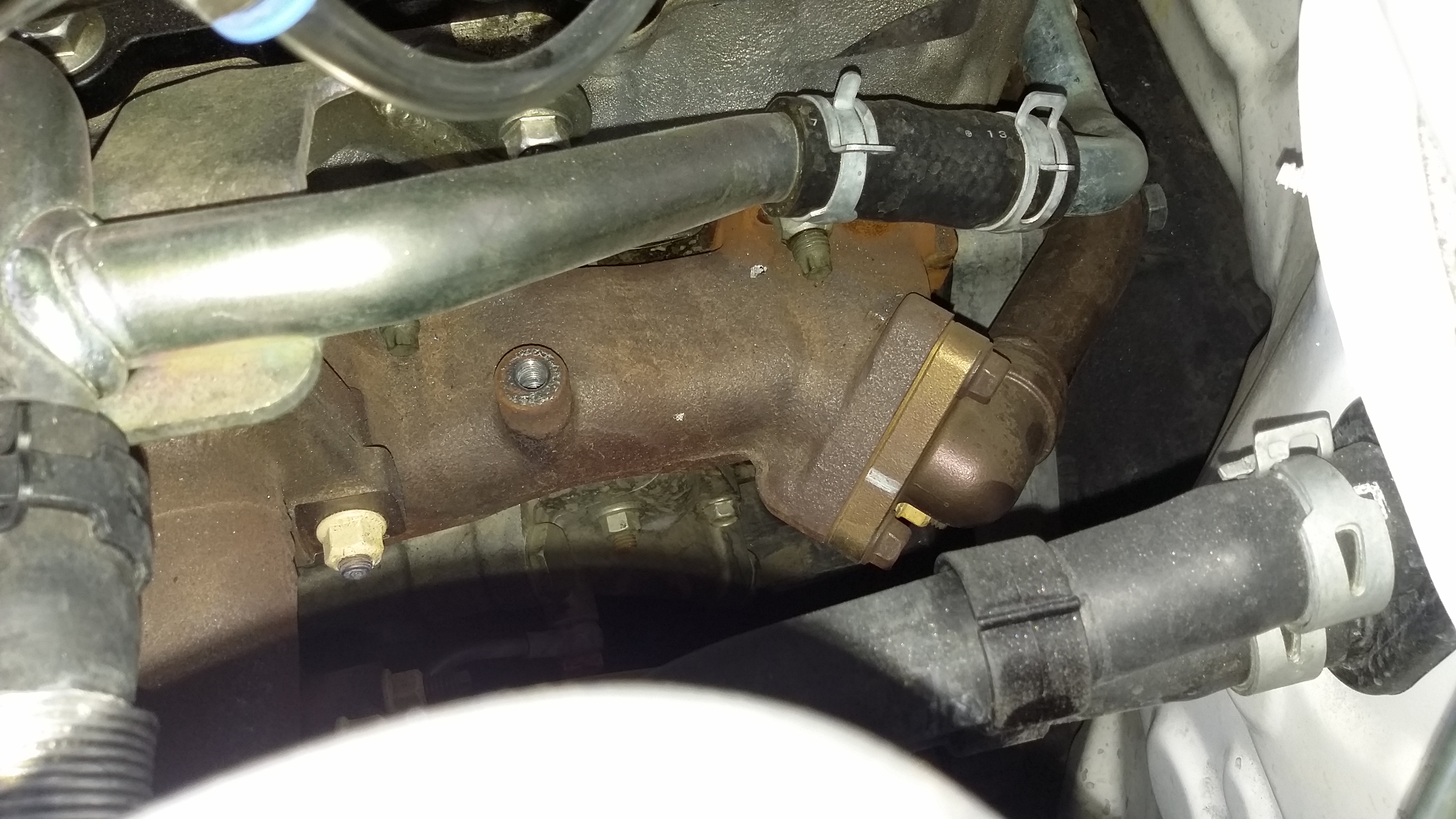

Hey Josh, here is where my unit was fitted on the dash, also there is a pic of where the probe was put, but not a very "up close" shot - maybe it will help with some ideas.
Placement on the dash
Madman 2.JPG (120.4 KiB) Viewed 3465 times
You can see where it has been put on the exhaust manifold.
The EGT sensor was installed before the turbo.
EGT cable.JPG (318.81 KiB) Viewed 3465 times
Dash mount.
Dash mount.
Madman gauge.JPG (120.25 KiB) Viewed 3465 times

I thought the probe would be to long for the manifold when I looked at it. I will then just put mine between no.3 and 4 cylinder. I thought it will be useless if it is not at the place where all the gas comes together. They recommend at the collective point.

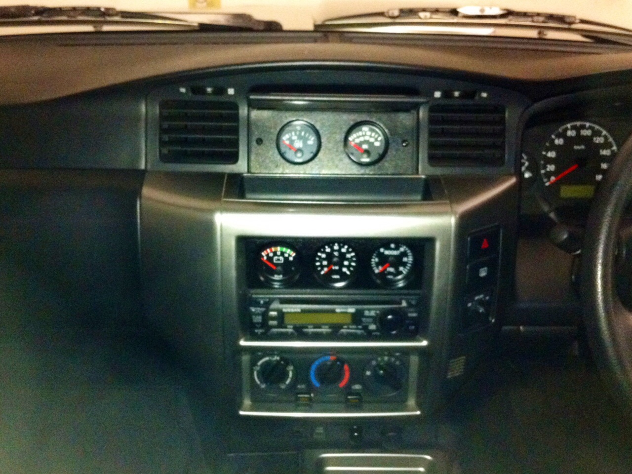

I removed my complete EGR system and fitted blank off plates to both the exhaust and inlet manifold connections. I then fitted my exhaust gas temperature probe to the exhaust manifold blank off plate which now displays the exhaust temperature of number 4 cylinder which probably also runs the hottest.
The 5 gauges I fitted to my Patrol are voltage, EGT, boost, oil pressure and oil temperature..my apologies for the poor picture quality!!
5 VDO gauges fitted
5 VDO gauges fitted

Daniel, awsome man. Looks great :clap: Your guage idee in the top cuby hole is what I had in mind. Thanx :thumbup:

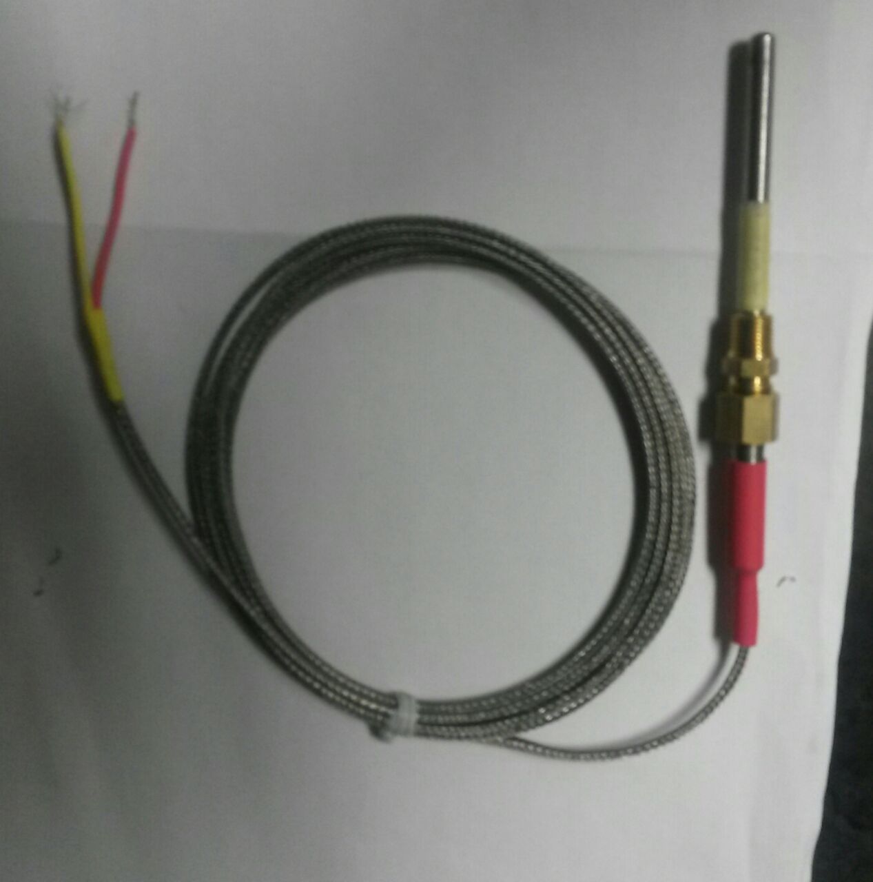

Can the madman egt probe be cut shorter? What is the tape for around the shaft? Does anyone know :think:

Thanks Joshua, the tape is only there to keep the brass fitting in place so remove the tape. One cannot shorten the probe....there is a compression fitting within the brass fitting so you must let approximately 20 mm of the probe protrude within the manifold before tightening. Hope this helps?

I just read the instructions on madman website. They have a nice pic on how the probe come together.
