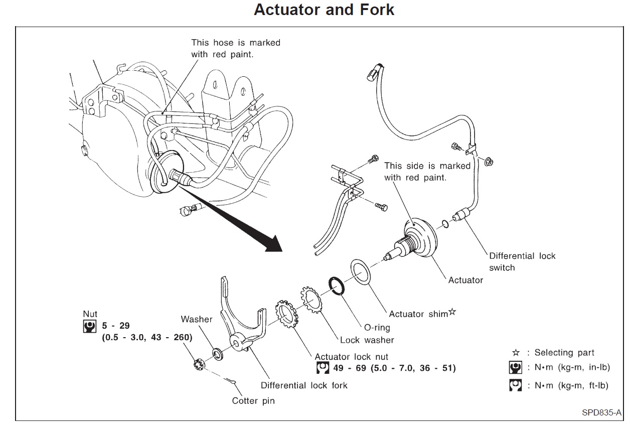

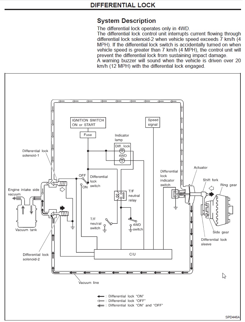

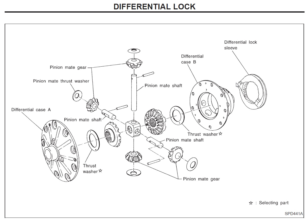

Anyone have an exploded view/diagram of a GU rear axle they can post....please :redface:
My rear diff-lock is occasionally releasing with a bang since I got and I suspect damage similar to the pics posted in this post: http://www.patrol4x4.co.za/viewtopic.ph ... 777#p41377
After sorting the gears out I will give the vacuum system some attention as well, as that might be the real reason why the damage happened in the first place.

Re: Rear Axle Exploded View Needed
Post by David »
Hope this helps...
