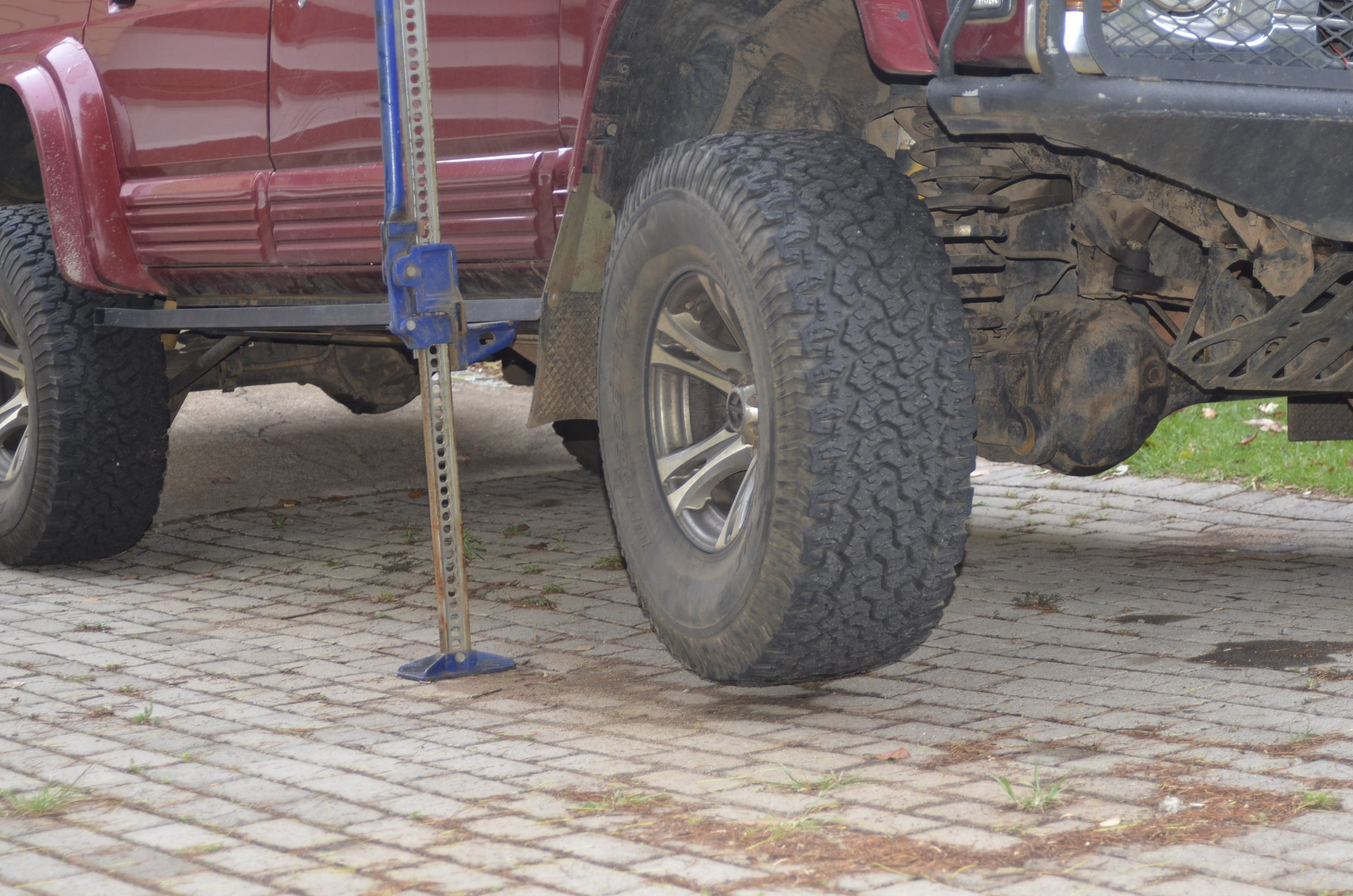

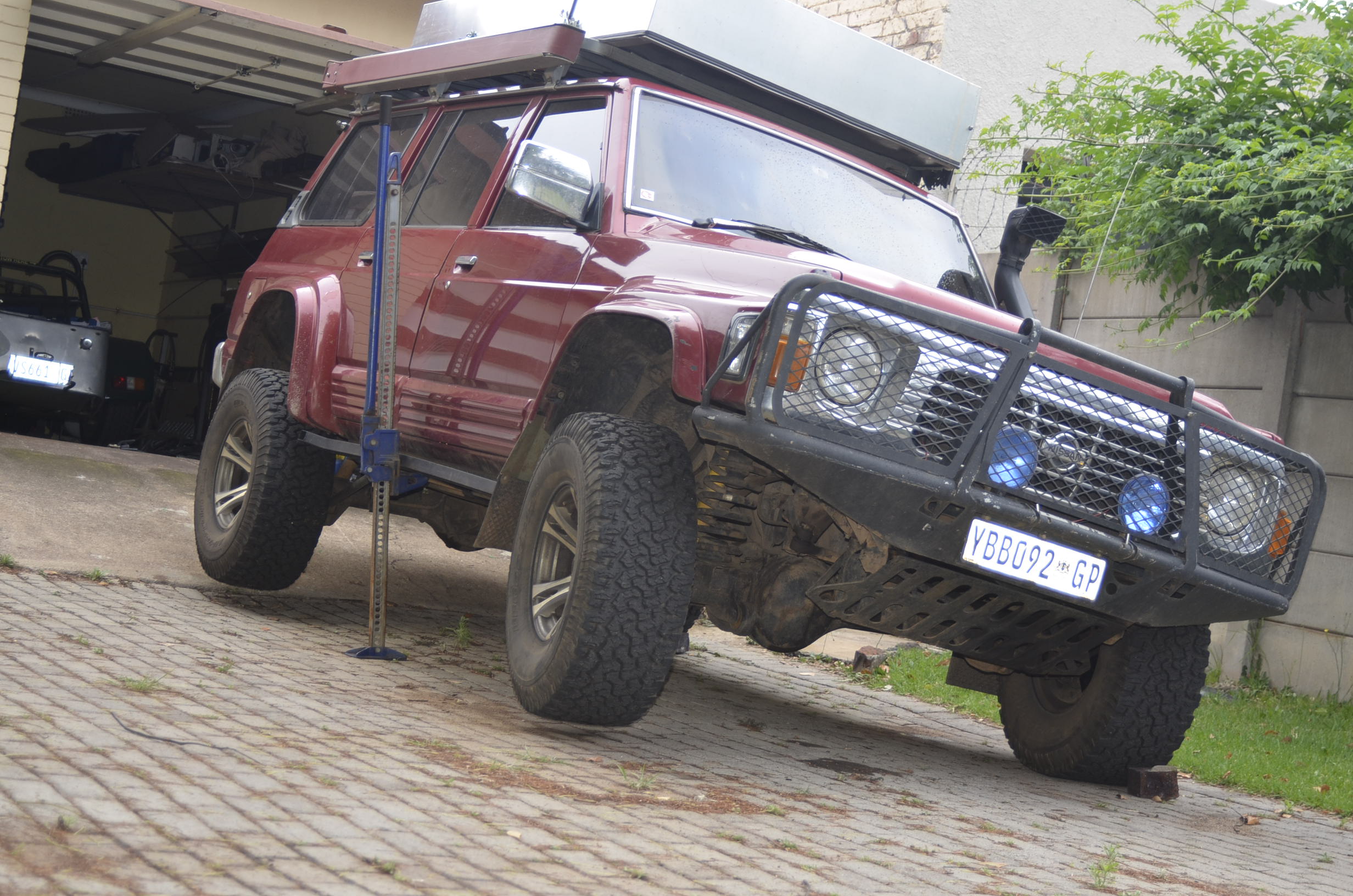

- Posts: 6137
- Has thanked: 1125 times
- Been thanked: 1036 times
Re: Rocksliders
David, I am afraid you have caught me out.
Those lifting points are effectively useless. The problem is that as the car lifts, the points twist relative to the ground.
The result of this is that when you woler the car, the jack touches it. They might however still be usefull as recovery points?
However it is possible to jack on the rocksliders themselves:
- Been thanked: 473 times
Re: Rocksliders
very impressive Peter !!!!.... both wheels off the ground !!!
