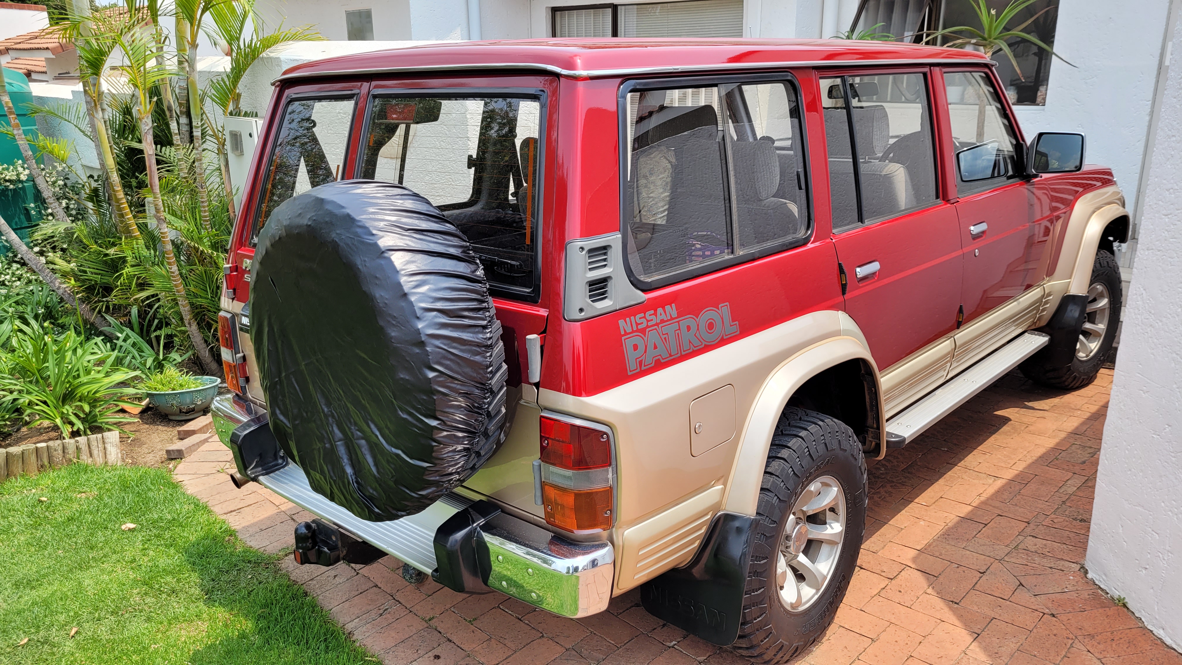

3) In my view there is NO better looking vehicle in this world than a RED GQ and you have it [me too]

this mine ONLY RED WILL DO

how about sharing some more pics of the beaut...
