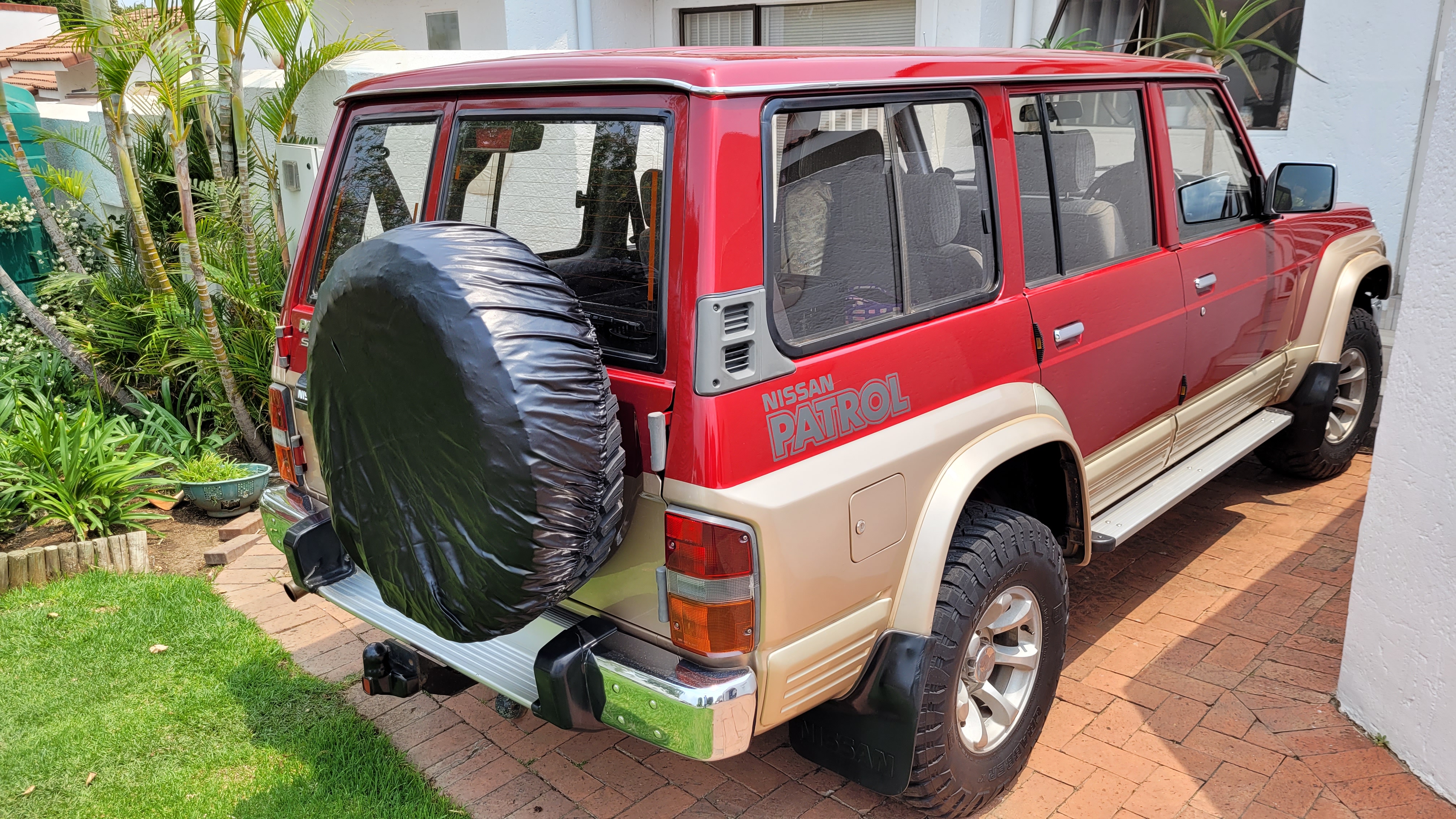

My name is George Ainscough, and i have recently acquired a 1995 Patrol SGL Y60.
I would like to give her a full service, and would like to know the recommended oils for the diffs, transfer case and gearbox, there are differing views ( as usual) on what types to use.

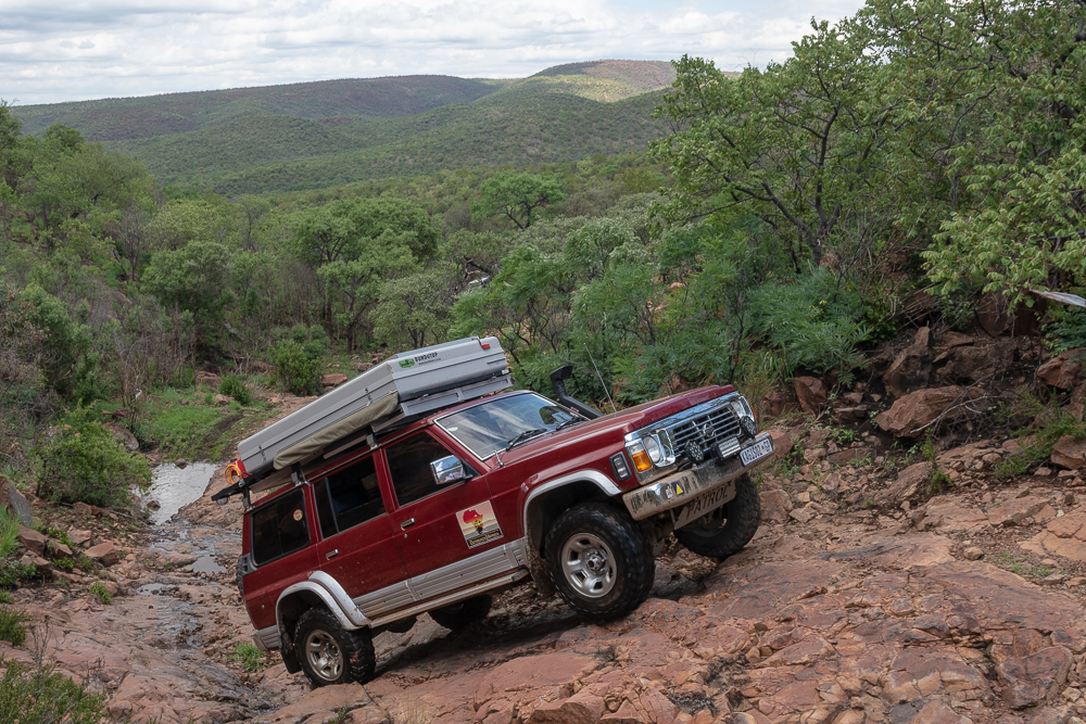

this mine ONLY RED WILL DO
