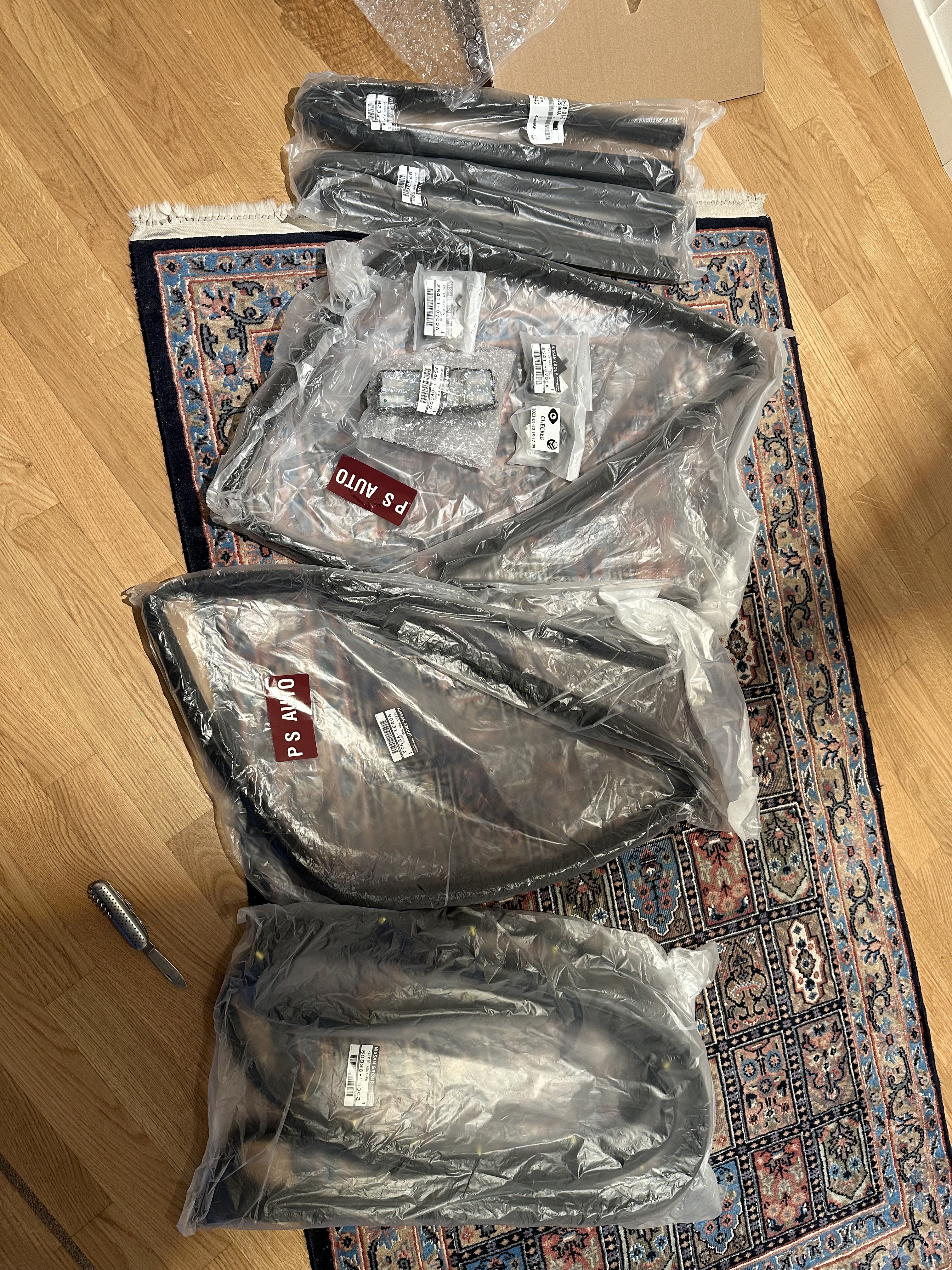

Hi SJC,
it was quite a search for me but I finally found them at partsouq.com in Dubai.
The last time I looked (which was more than a year ago) the rubbers were ridiculously expensive (about 2700 ZAR/rubber) but now they were about half which I decided is not cheap but okayish.

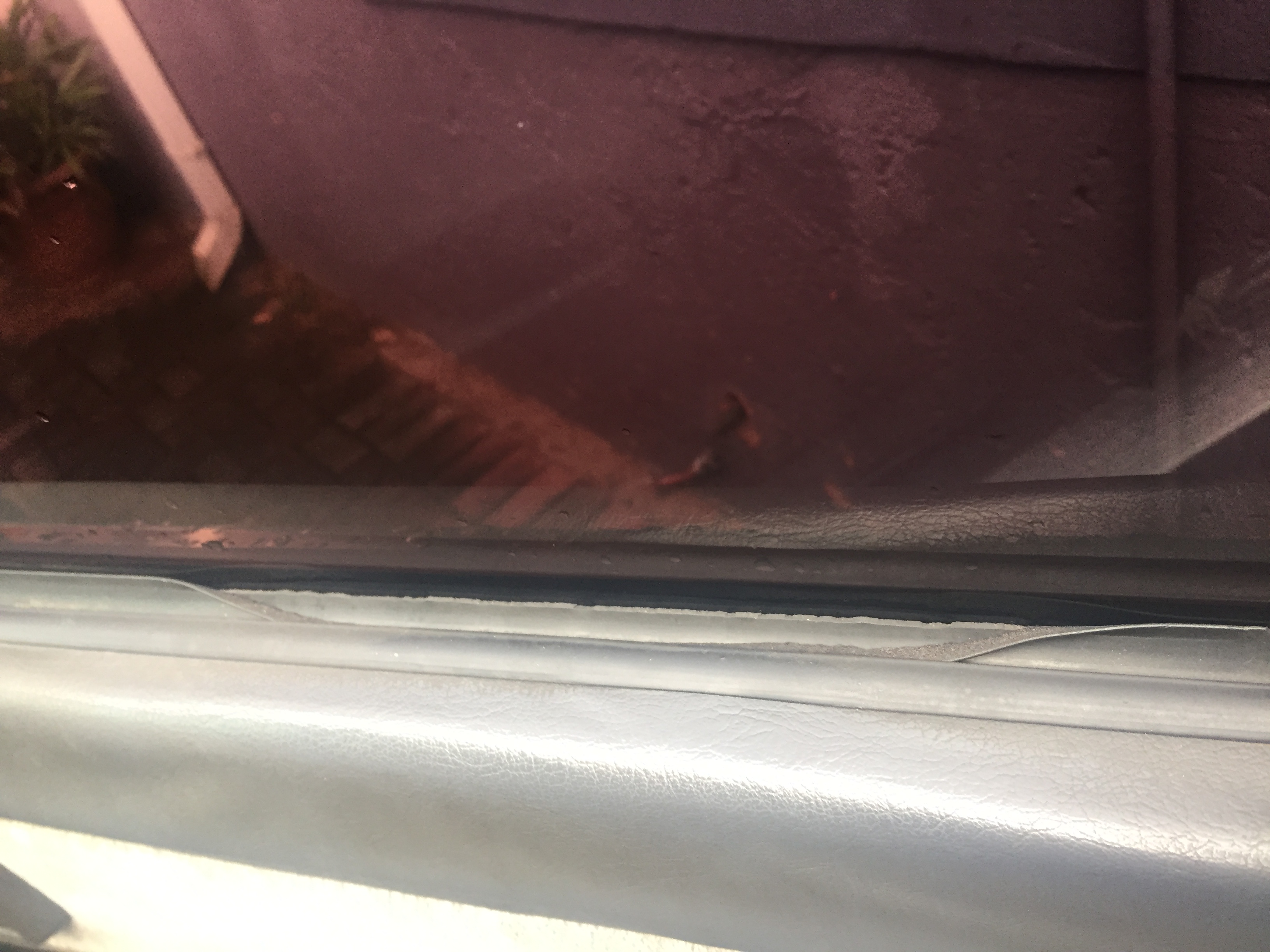

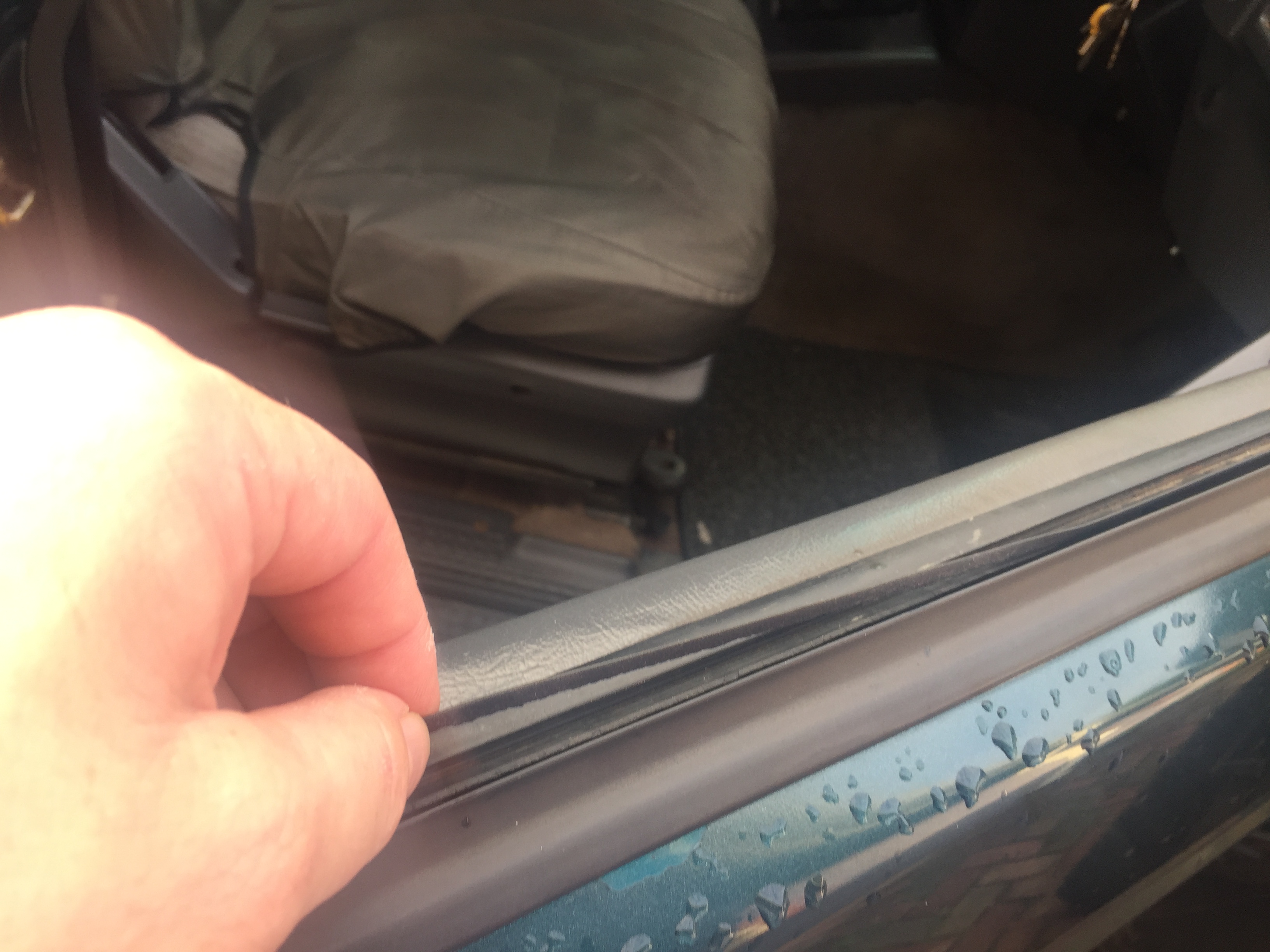

I even got the wind rubber for the drivers side, which is the one you touch when you open and close the window - mine is a bit torn.
The parts are original and arrived in great condition, perfectly packed.
So I'll post an update when they are in.
