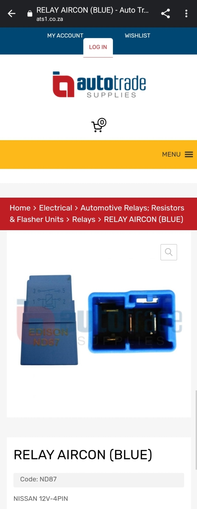

This is the relay that you need...ND87. ATS sell to Midas. You might have to get your local Midas to order one for you.
https://ats1.co.za/product/relay-aircon-blue/
