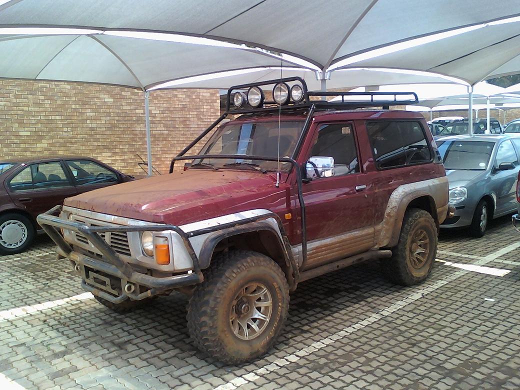

Re: ENGINE CONVERSIONS
Freakazoid
I drive a small Gq SWB patrol, and would like to get some more power to the wheels.
What would you install and were would I be able to get the motor?
82 Safari SOA
92 Patrol SWB
92 Patrol SWB
