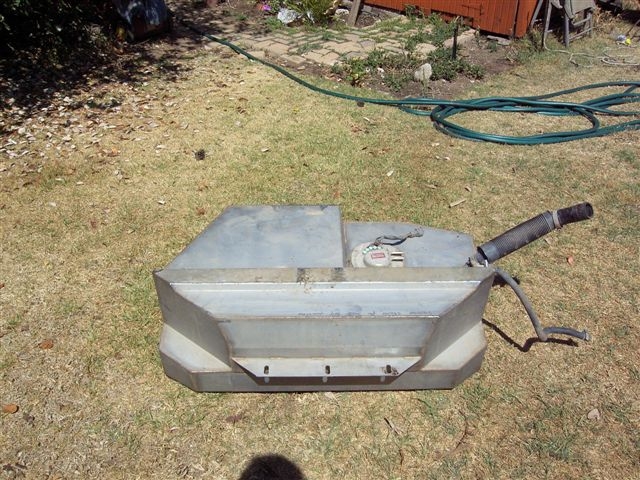

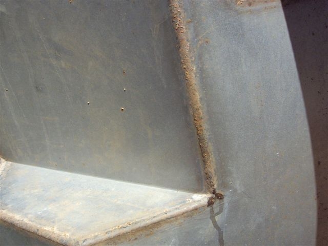

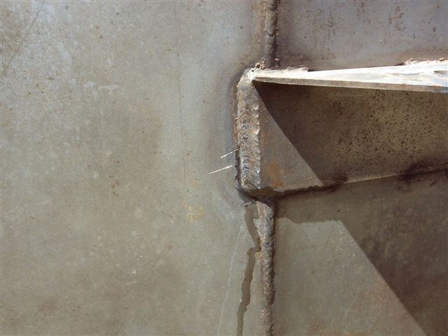

Ungili's fuel tank started to leak at two places whilst in the Kgalagadi - terrible corrigations in the roads!
In the end I could not have more that 70l in the tank. Had it welded yesterday and will put it back tonight.

Was dit skaafplekke of het hy deurgeslaan?Ungili's fuel tank started to leak at two places
Re: Long Range Fuel Tank
Hy het op die sweislas begin lek - in die een hoek en ook waar die mounting bracket vasgesweis is. Volgens die plakker op die tenk is hy deur Silverton gebou en was laaste getoets op 28-11-2005.

Hi Herbie
This is a common problem with the Exel 140l fuel tank on the Patrol.I think it's because of the weight of the fuel that causes the welds to fatigue.Remember that stainless steel is prone to cracking under stress.The good thing is that it is an easy fix.
I dont know why Exel uses 3CR12 to manufacture there fuel tanks whereas Long Ranger in Aus use good old mild steel

Ja Stefan dit is maar het die Patrollie gekoop met hom in - is nie seker wie hom gebou het nie. Daar is 'n "Silverton" sticker op die tenk.
Ek het hom laat weld en hy is nou weer top fiks!
