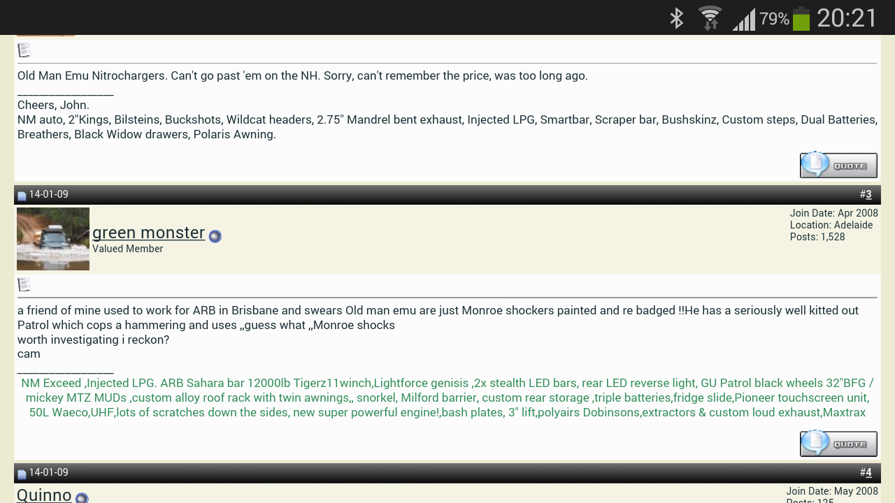

Re: 4.8 Suspension vs. 4.5
See attached from Oz Patrol forum.
- Screenshot_2014-11-22-20-21-45.png (214.66 KiB) Viewed 3858 times
Life is a journey...enjoy the ride
Hi Marius
I had 4.8 coils on my car before the OME coils. There was a definite lift from the old 4.5 coils to the 4.8 coils. I can recommend it. I usually use 4x4 megaworld in Bloem to do the work for me. Charge me R400 to change the coils for me, R800 coils and shocks.
Remember the take measurements before and after.
Good luck
