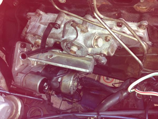

Re: Filter,oil cooler housing
Are you talking about this??
Jip thats the one R 7700 and no stock anywhere with 15 working day back order what a huge mess!!!

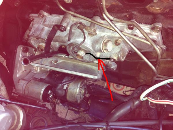

Where is the crack exactly ....and how can that even happen...
- Been thanked: 473 times
Is the crack here.....(more or less)
I think that that can be welded professionally, Peter Connan I think would be better qualified to answer that, but I can't think that the pressures on that would be too much of an issue
Its from where the pressure sensor screw in towards the big nut forward where the release vavlve sits. Tried the welding route none of the pros want to touch it they all say the material is already to thin due to the hole for the sensor and the valve. It looks like with the rebuild the sensor was overtightened and popped the casting. Just as I started to think all is well and sorted.

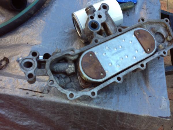

Ek het vir jou een.
