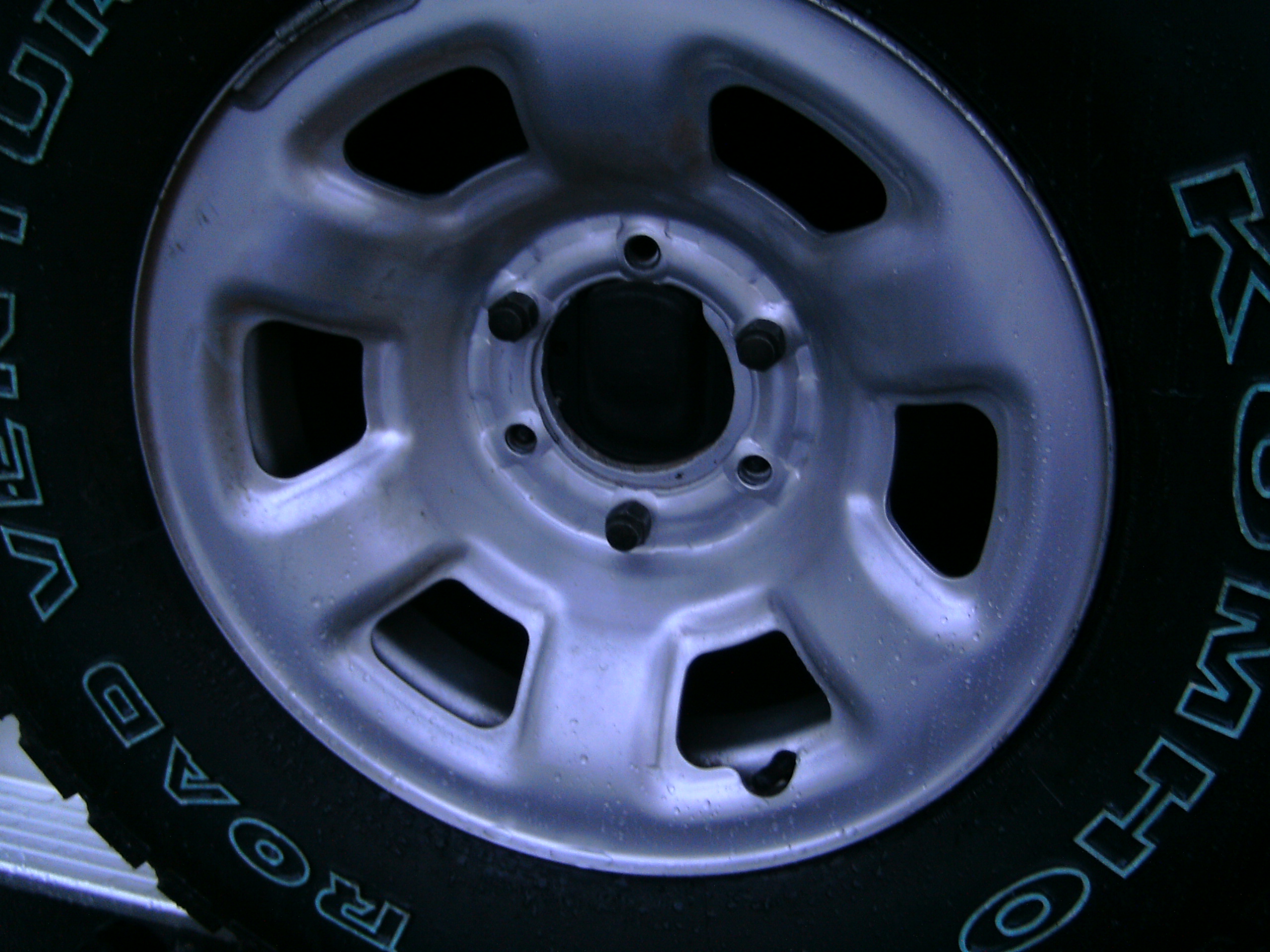

I am looking for 5 16" steel rims like the picture below. Condition of coating not important as I will be sandblasting and powder coating. Hub hole diameter must be 110 mm.

Iant had a set that he wanted to sell pm him the hub hole is very important otherwise the wheel never sit properly against the hub 90% of aftermaket ones needs to be cut

Afraid Ian's are gone.Tinus lotz wrote:Iant had a set that he wanted to sell pm him the hub hole is very important otherwise the wheel never sit properly against the hub 90% of aftermaket ones needs to be cut
It would seem that if you remove the spigot ring from some of the A Line mags they fit perfectly but I still need to physically check.

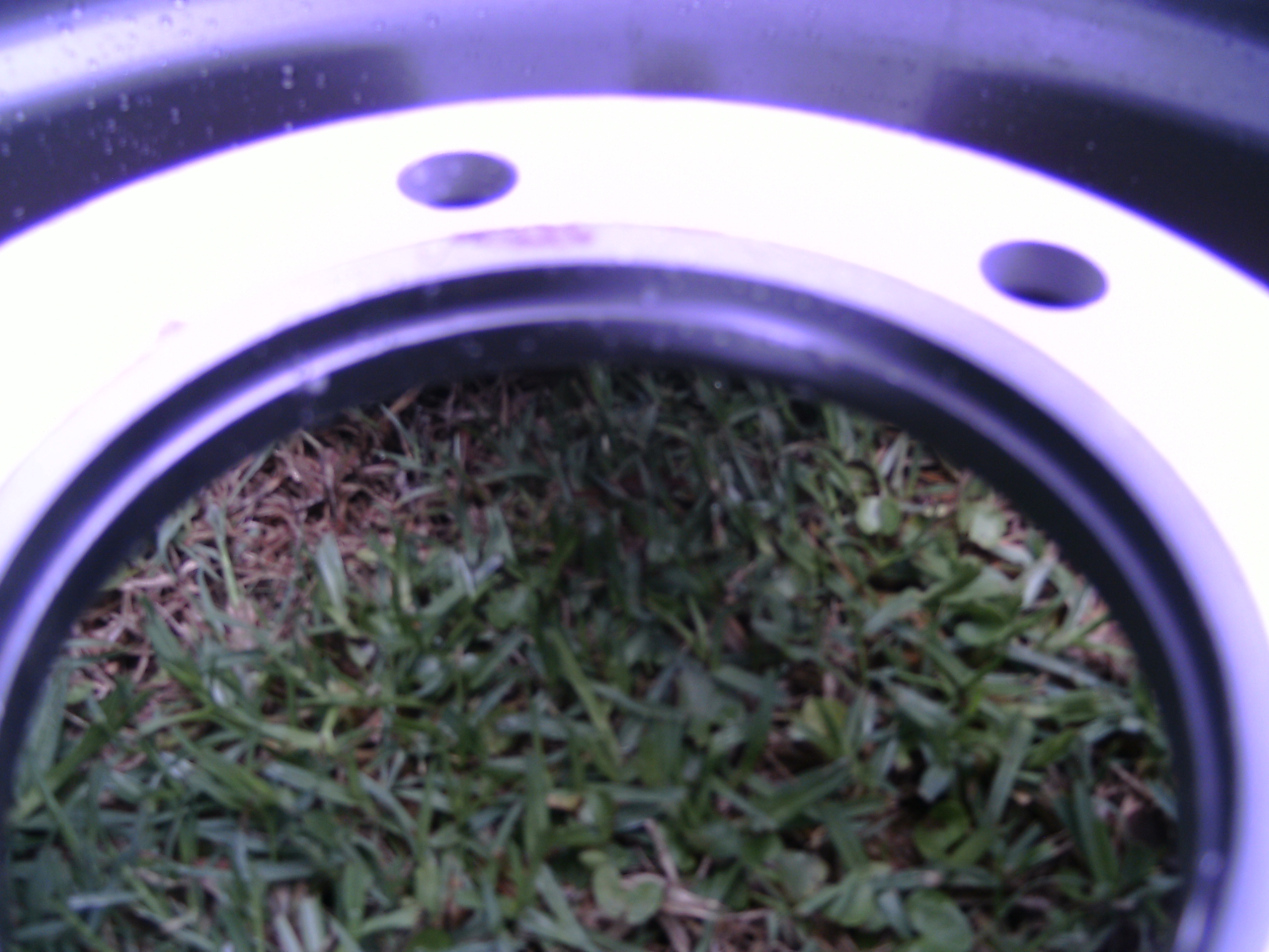

Re: Steel rims wanted
There are aftermarket rims available that fit perfectly. These are from A Line and on the photo below the inner hub diameter is 108 mm. Then changes to 110 mm and is then angled to 117 mm. These are the same diameters that I picked up off one of the Aussie websites that work.Tinus lotz wrote:Just check properly the last mm on the hub has a round curve and that is what's makes the problem .....also there was someone wanting to sell a set with or without tires a while back but I am on my mobile can't find it
