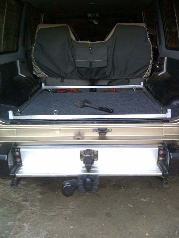

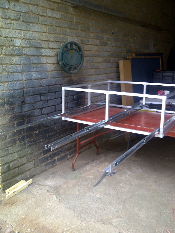

So I got this crazy idea to build my own drawer system for the Patrol, and nobody tried to stop me :doh:
First thing - I can not weld so next option was connect-it as this involved only cutting, drilling and pop rivvets and or screws.
Attached some pics of what I have done so far.............

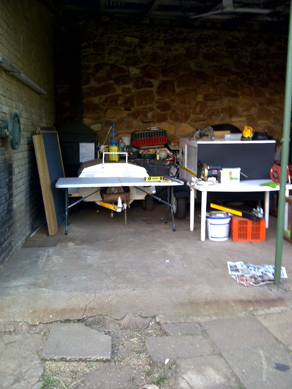

Making some space to work......

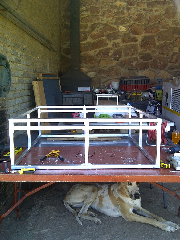

Base started
Base started
Frame completed.
Frame completed.

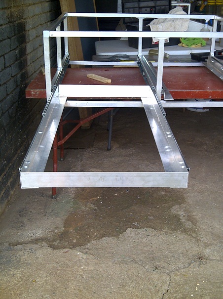

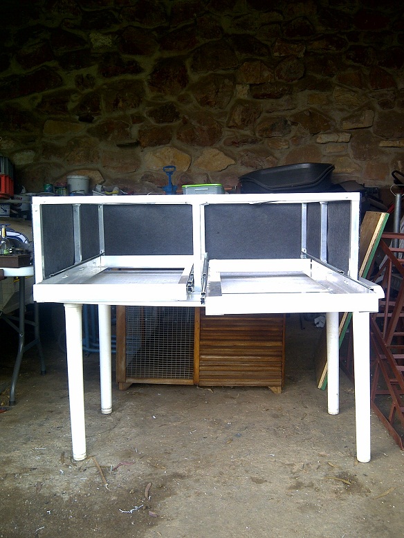

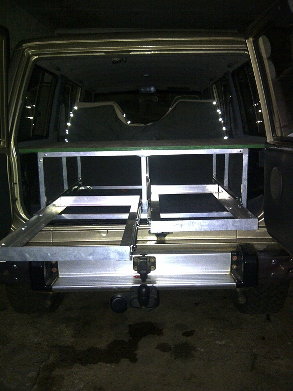

Slides fitted.
Slides fitted.

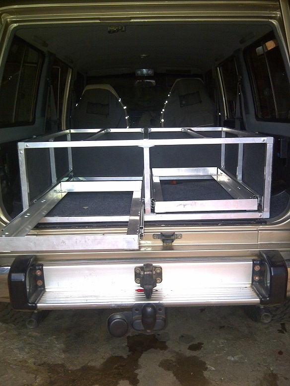

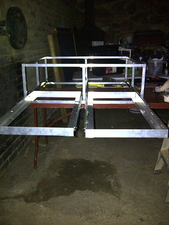

Frame fitted to slides
Slides done and working :-)

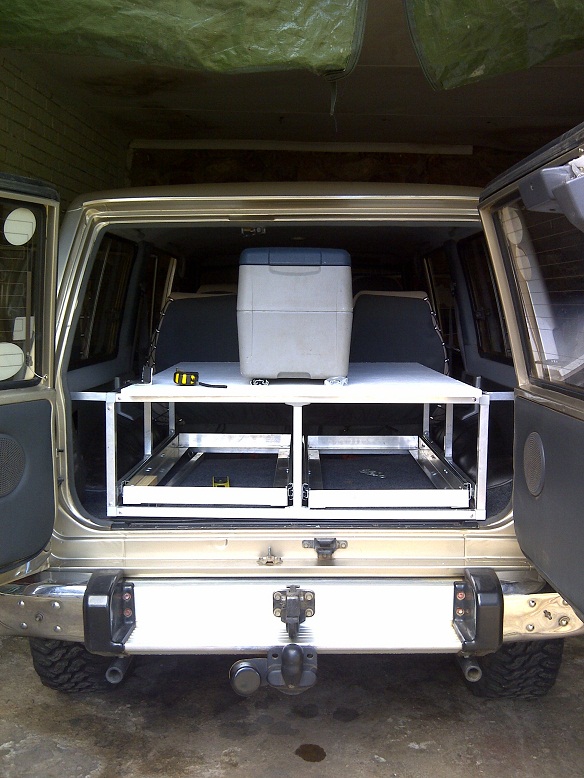

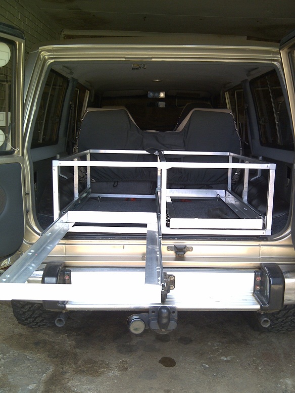

Check to see if it fits and slides will work.

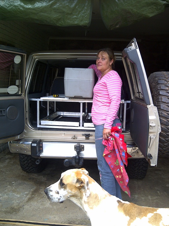

Checking that the fridge would fit.
Confirming that the other half can get to the cold beers.

Next step is to have a top fitted and probably cover it with carpet.
Then fit the slide for the fridge.
Next is to fit the inverter that has been lying in the cupboard for three years, have no idea how it works to be honest.
I have already fitted a 12V plug for the fridge's and one for lights in the back so it will just be a case of moving them to where it is required.
Got the name from Grant on the guy that did his Gullwings so will be fitting those as well and then two "boxes" in front of the now back windows - idea stolen from Grant :redface:

Iets wat ek al gesien het is dat as jy jou vrieskas/yskas uitrek val daar alewig goed agter in. Sit dalk kante op, sodat dit nie kan gebeur nie. Maak dit dalk verweiderbaar, sodat as die yskas uit is, jy die spasie weer kan gebruik. :mytwocents:

Marino4x4 wrote:Iets wat ek al gesien het is dat as jy jou vrieskas/yskas uitrek val daar alewig goed agter in. Sit dalk kante op, sodat dit nie kan gebeur nie. Maak dit dalk verweiderbaar, sodat as die yskas uit is, jy die spasie weer kan gebruik. :mytwocents:
Die slide vir die yskast sal jy kan uithaal indien nodig, maar aangesien die trol net vir speel is sal die stelsel permanent wees, so ek sal kyk tx

Waar het jy jou slides gekoop asb

Andre -- weet nie waar Dirk gekoop het nie -- maar toe ek gesoek het was beste pry by ROAD Q gewees .. hulle is Silverton.
Dirk man -- hoe plan jy om die raam te anker ??
Posts: 2859
Has thanked: 189 times
Been thanked: 270 times
Re: Building a 10 thumb drawer system
Ek het die slides by Furnlock self gekoop. www.furnlock.co.za
Daar is op die oomblik van die "ogies" agetr in die trol wat indraai in die voertuig se bakwerk so ek sal die bestaande gate gebruik om die raamwerk aan die voertuig vas te skroef.

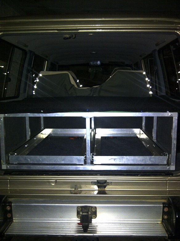

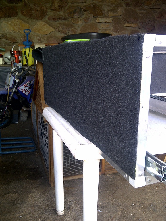

So Bietjie vordering.
So lyk binnekant
So lyk binnekant
Mat op kante - ligter as hout
Laai-stesel in Troll
Hout bo op stelsel
Hout bo op stelsel
Mat moet nag geplak word
