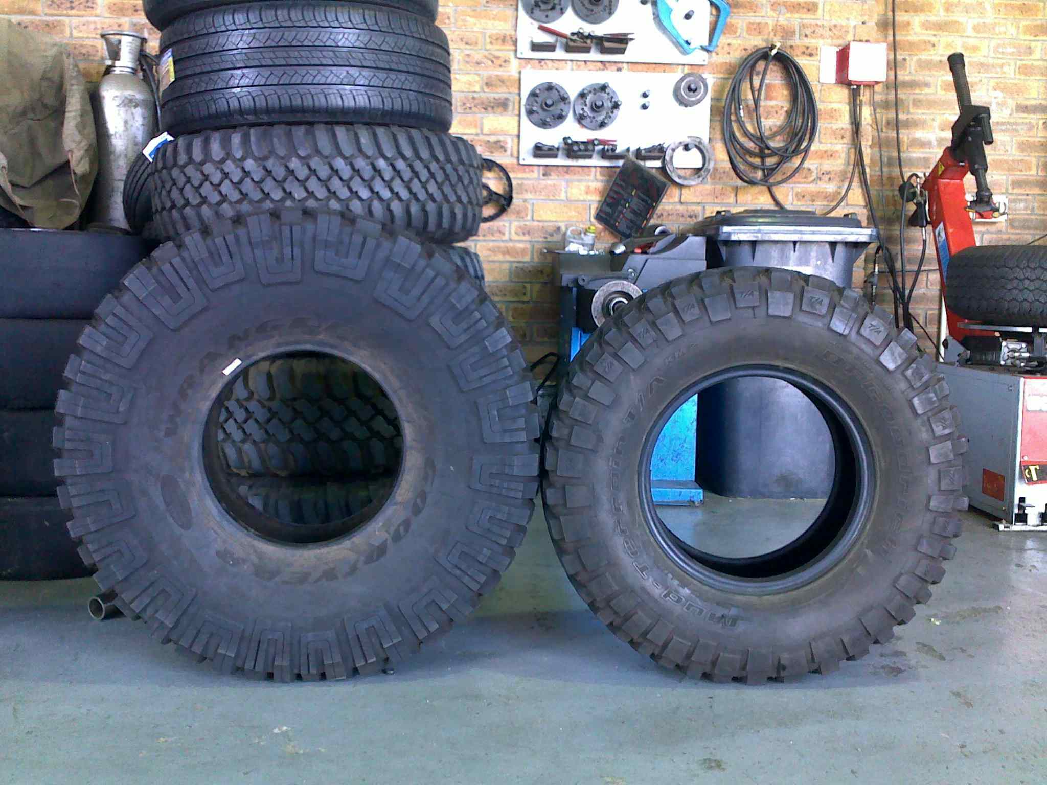

- jst for fun - differnece between 33 and 37!!!
- 06042011112.jpg (189.37 KiB) Viewed 2431 times

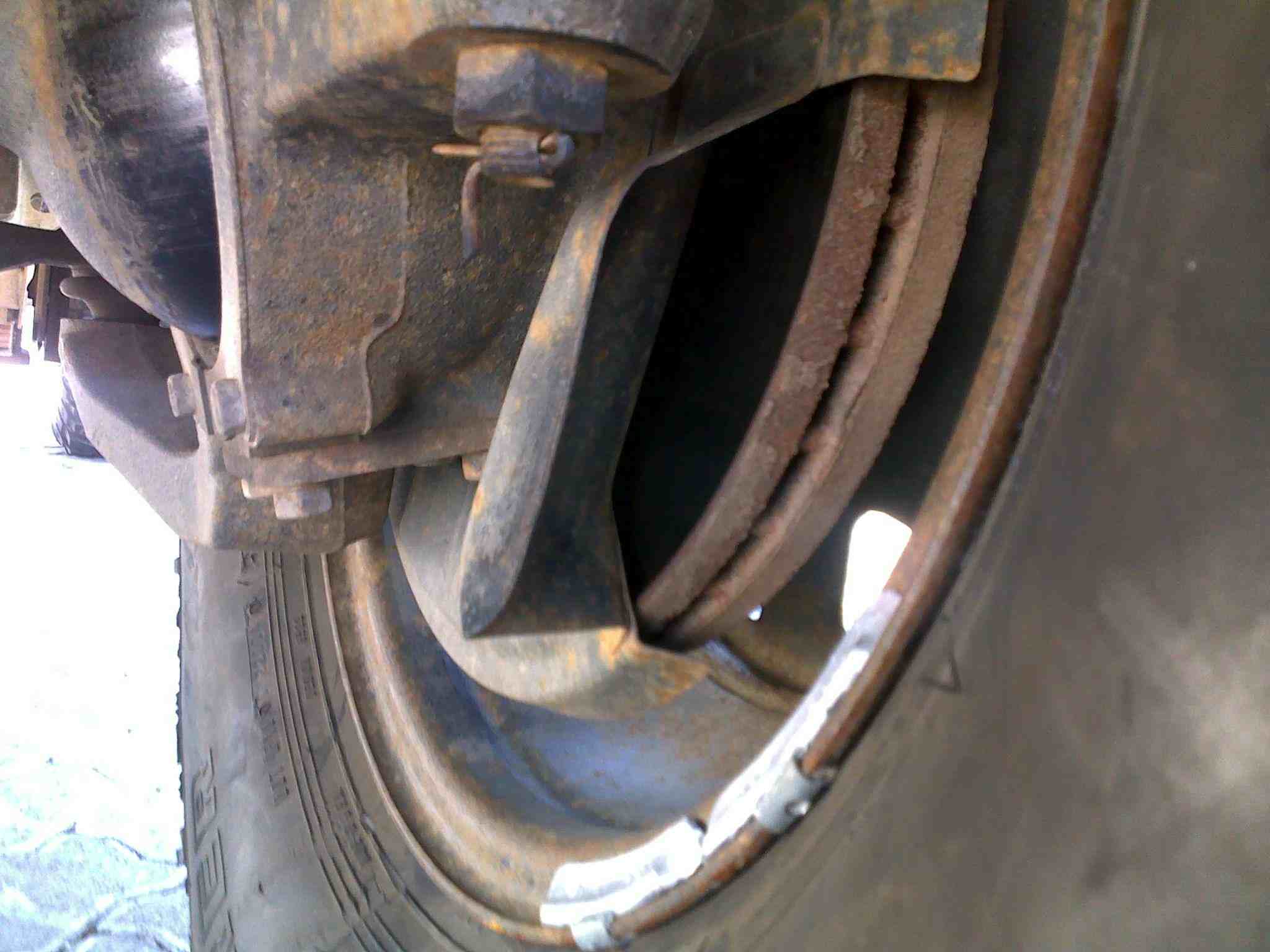

- slight bend in the brake cowling - not serious
- 06042011111.jpg (115.74 KiB) Viewed 2431 times

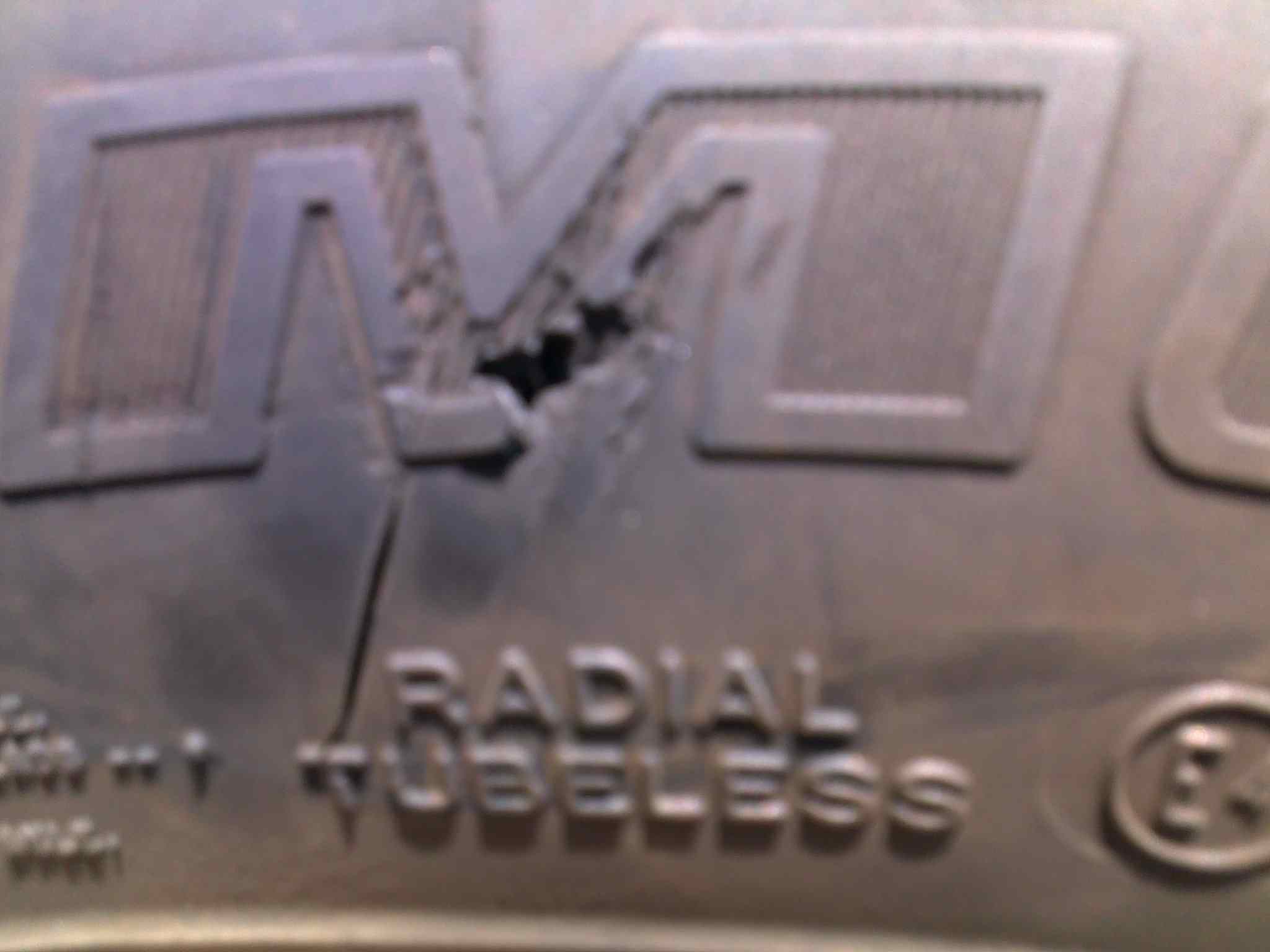

- side wall with cut and gouge - didn't even go through the first ply but i'm not gonna take a chance
- 06042011109.jpg (81.1 KiB) Viewed 2431 times

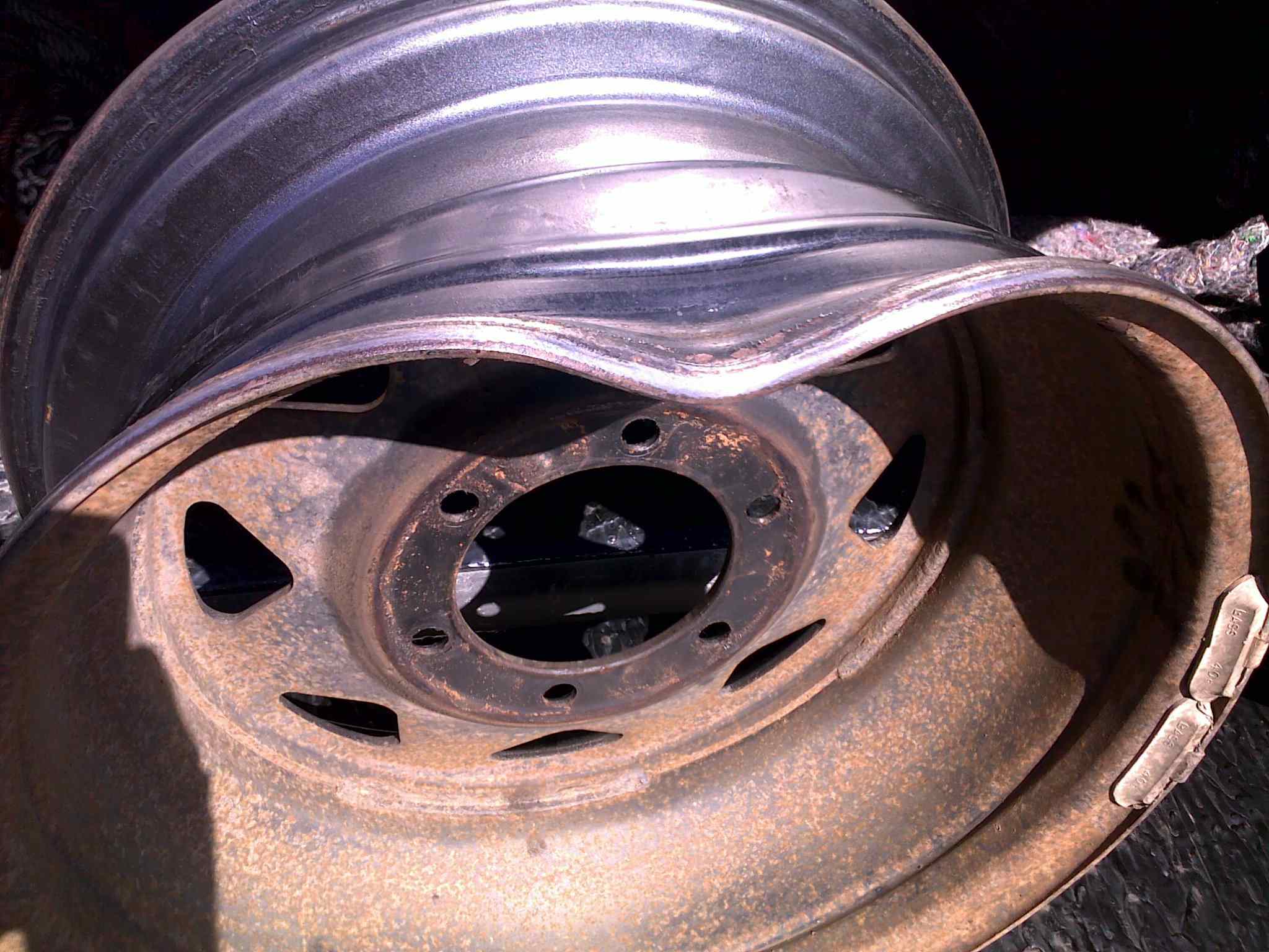

- rim buggered
- 06042011106.jpg (214.38 KiB) Viewed 2431 times
- rim buggered
- 06042011107.jpg (171.04 KiB) Viewed 2431 times
