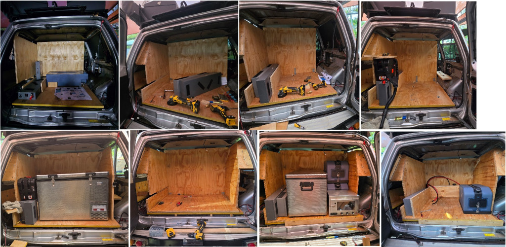

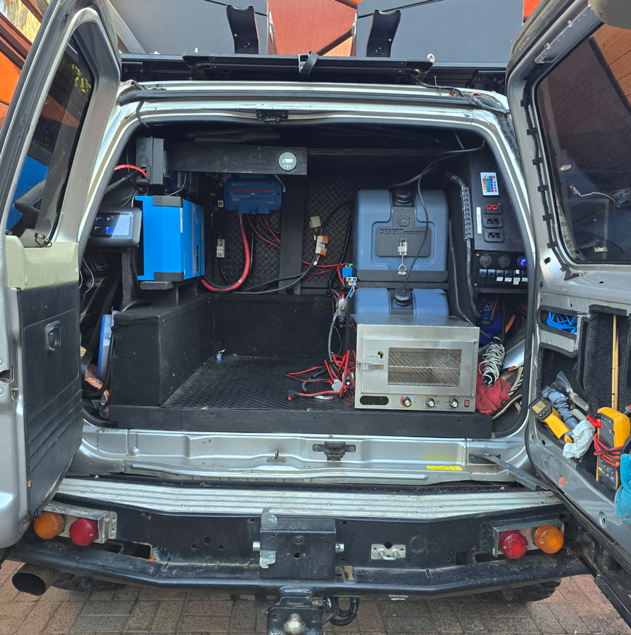

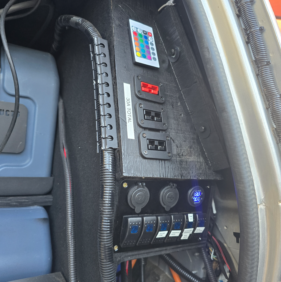

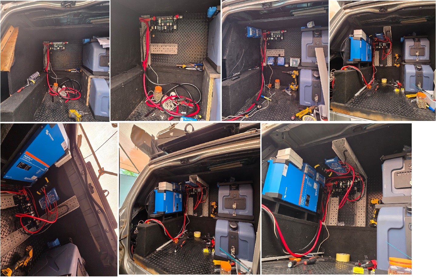

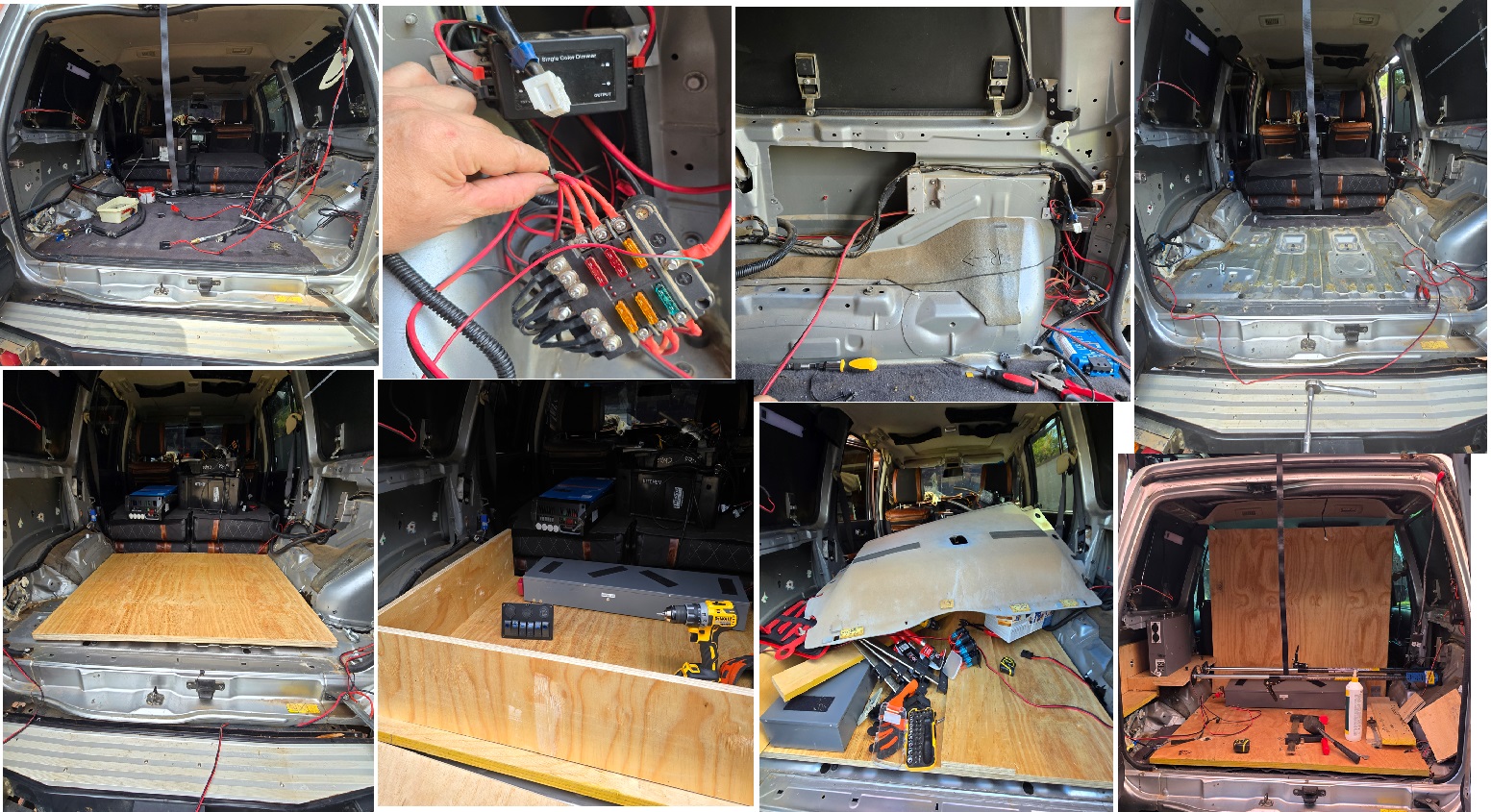

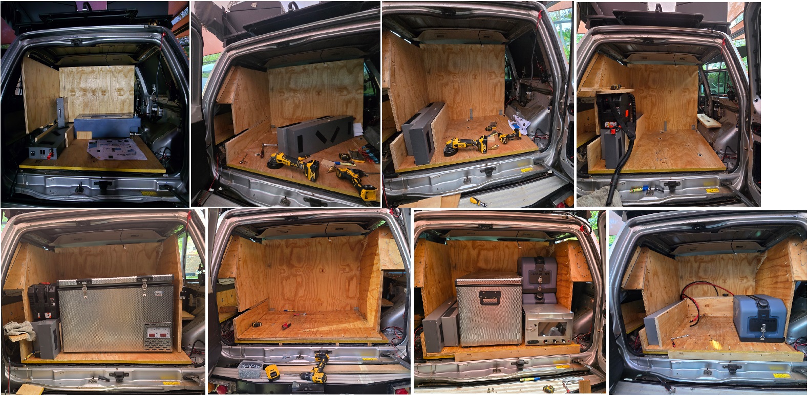

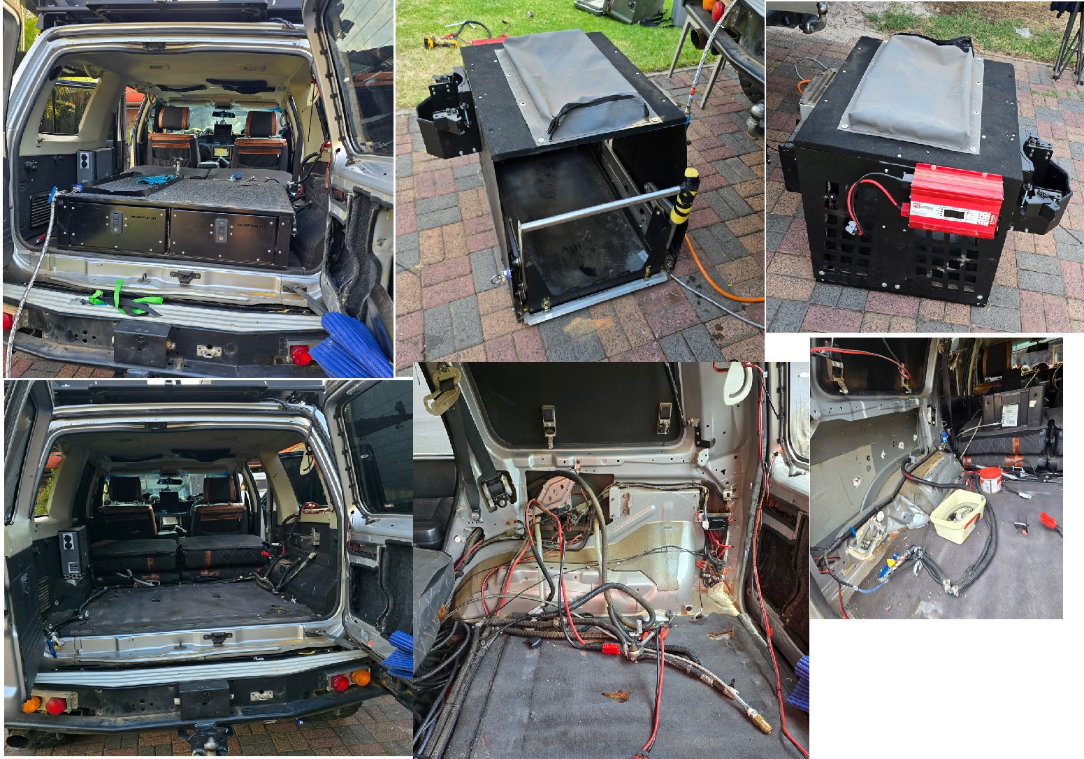

After several months of cutting, measuring, reworking, experimenting, and dealing with some well-deserved (but very inconvenient) rainfall, I’m excited to finally share the completed rear electrical overhaul on my Patrol. What was originally planned as a 2-month project stretched to nearly 5—but in hindsight, that extra time allowed me to refine the layout, resolve unforeseen challenges, and build a system without compromise.
This setup may seem excessive to some, but with a wife and three kids joining me more often, it’s become a necessity rather than a luxury.
I’ve included a ZIP file containing the full PDF with all the technical details. Unfortunately, the forum won't allow direct upload of the PDF due to size restrictions.

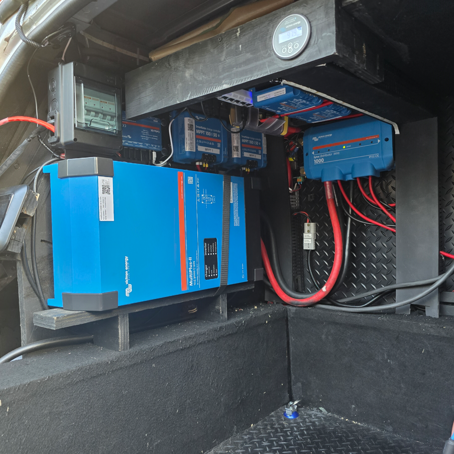

Is that the 3000w inverter?

Yes Ant 3000W
Specs
MultiPlus-II 12/3000/120-32 230V 12V 3kVA Inverter/Charger installed
Key Specs:
Nominal Power: 3000 VA (3 kVA)
AC Input: 230V AC
Battery Voltage: 12V
Charger Output: 120A max
AC Passthrough: 30A (when connected to grid or generator)
