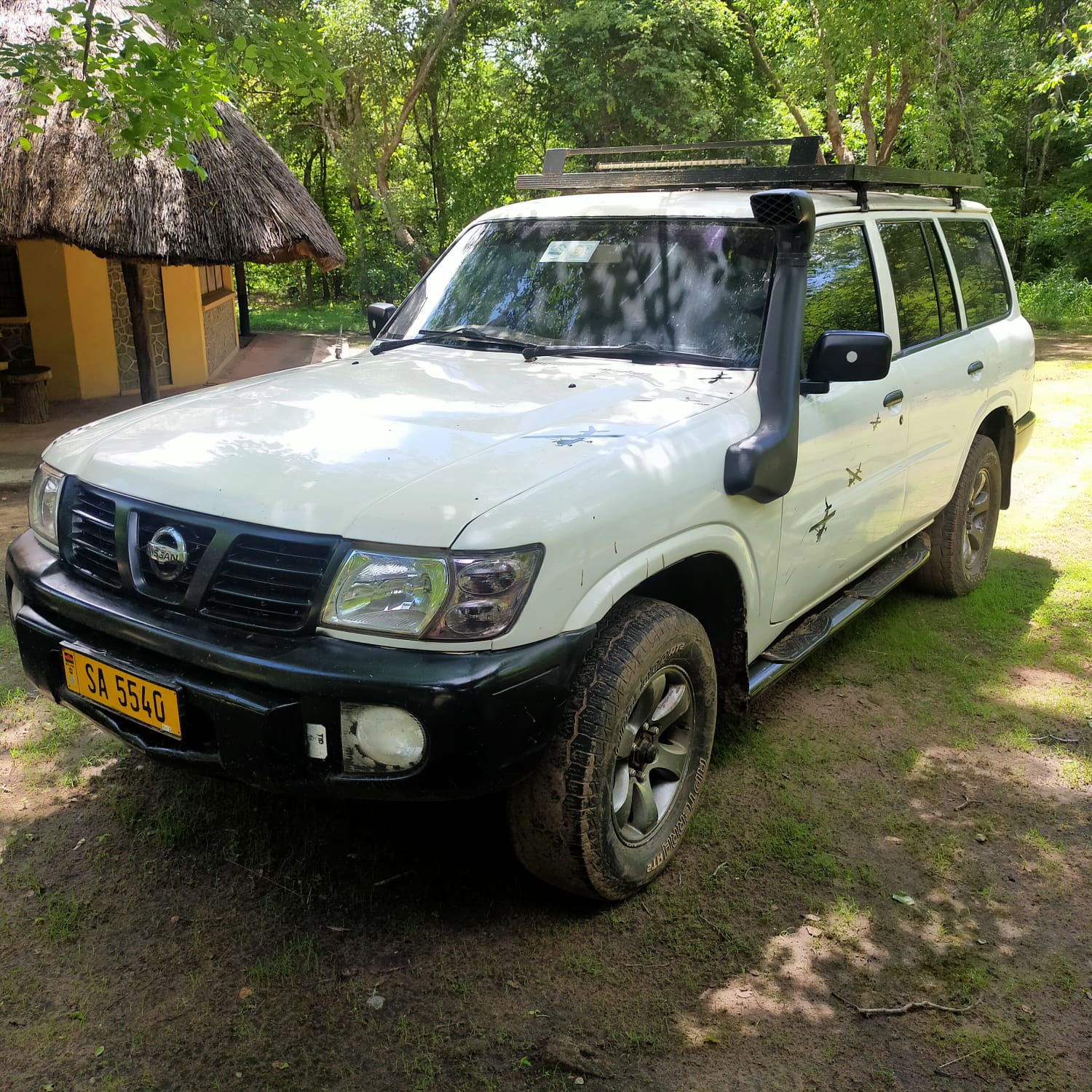

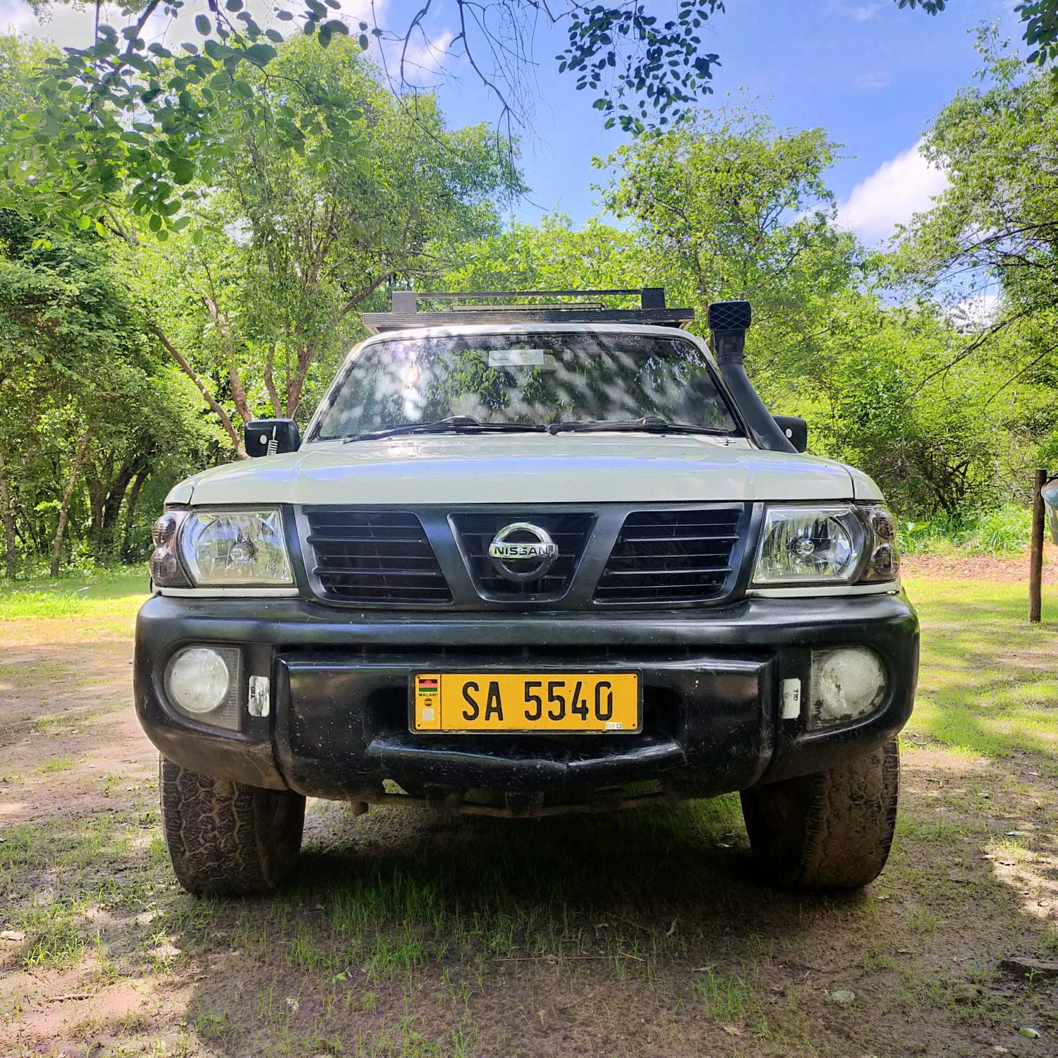

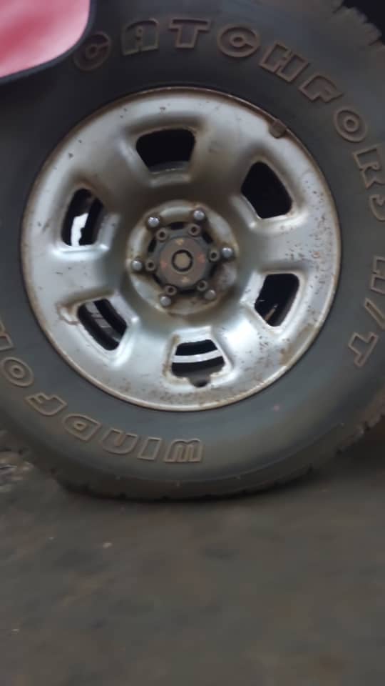

Thanks for your reply! I'll post some pictures.
The first picture is the rim we are looking for the car on the other pictures is our car

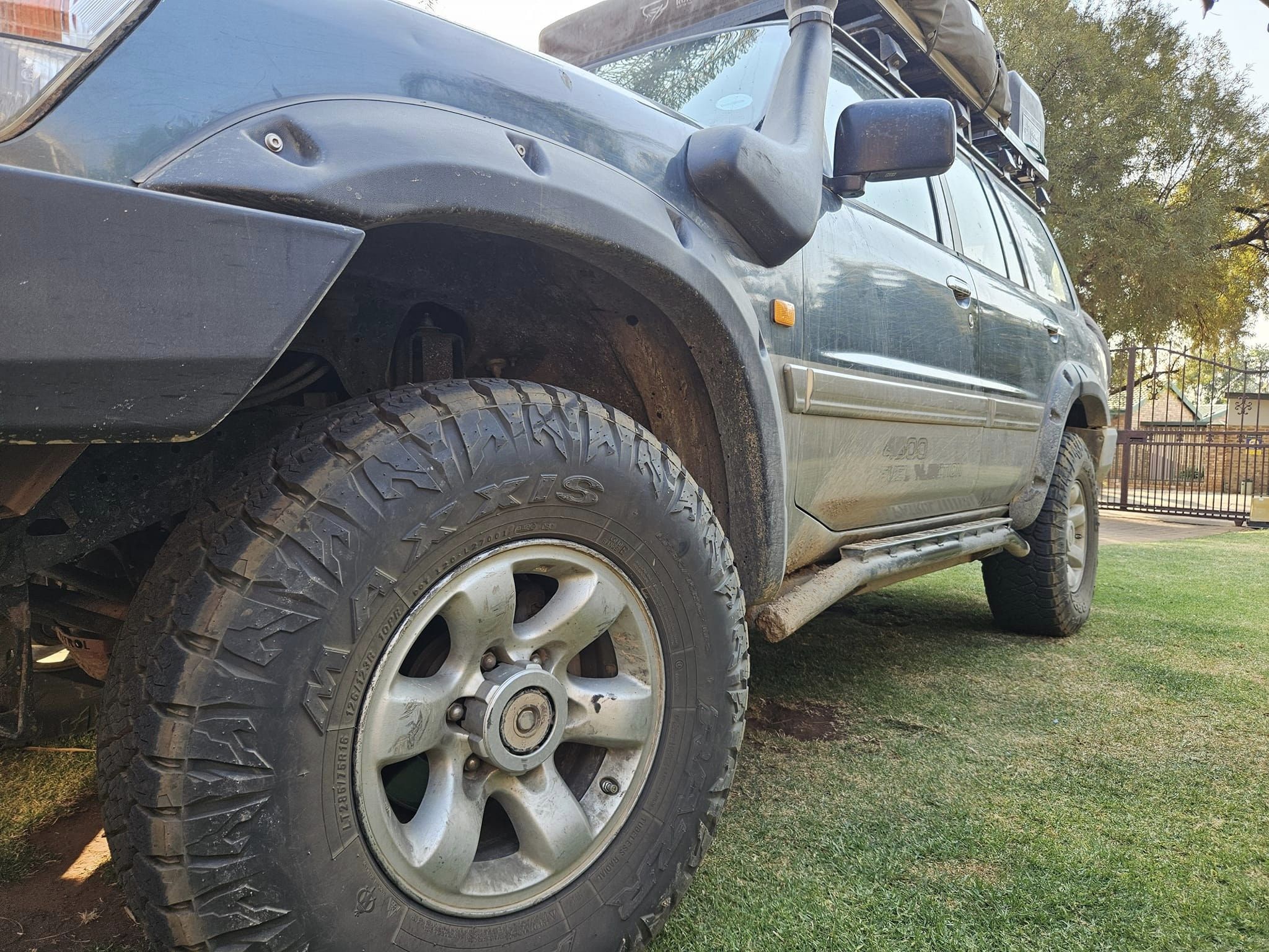

The first photo seems to be a standard steel rim. The other seem to be the standard series 1/2 alloy rims as per the photo I've attached.
But... are you sure those are 17" rims ? Both of those came out in 16" only, as far as I know.
What size tyres are you running ? ie: 285/75R16 / whatever. The code on the tyre ?
