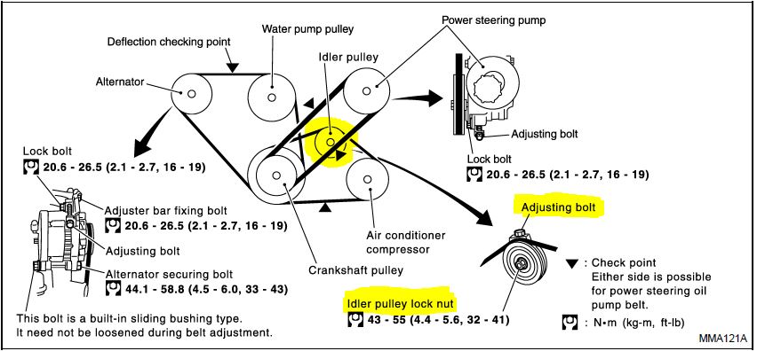

On holiday in Kosi Bay area. Aircon belt starting to slip on startup. Where do I tighten the belt. Difficult to see the belt tensioner from above. Japie van Pletzen.

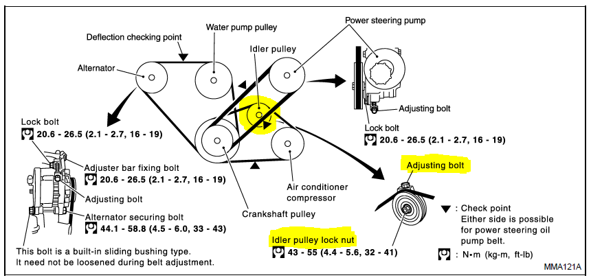

Undo the idler pulley's center nut, adjust with the tensioner bolt, then tighten the center nut again. Cold belt deflection is specified as 9mm between the aircon & crankshaft pulleys at the bottom.

Thank you Christo; appreciate the detail provided.

ChristoSlang wrote: 24 Dec 2023 19:28 Undo the idler pulley's center nut, adjust with the tensioner bolt, then tighten the center nut again. Cold belt deflection is specified as 9mm between the aircon & crankshaft pulleys at the bottom.
do you perhabs have the "diagram" for the tb42?
I also need to adjust my aircon belt (on tb42).

That diagram is correct for the TB42 Fanus

Correction, it is my power steering belt that is a bit loose. Never adjusted it, but it is more loose now than what it was.
So I need to do it now.
So when adjusting the power steering belt, do you just adjust it by the "adjusting bolt" on the power steering pump pully?
This straight forward?
