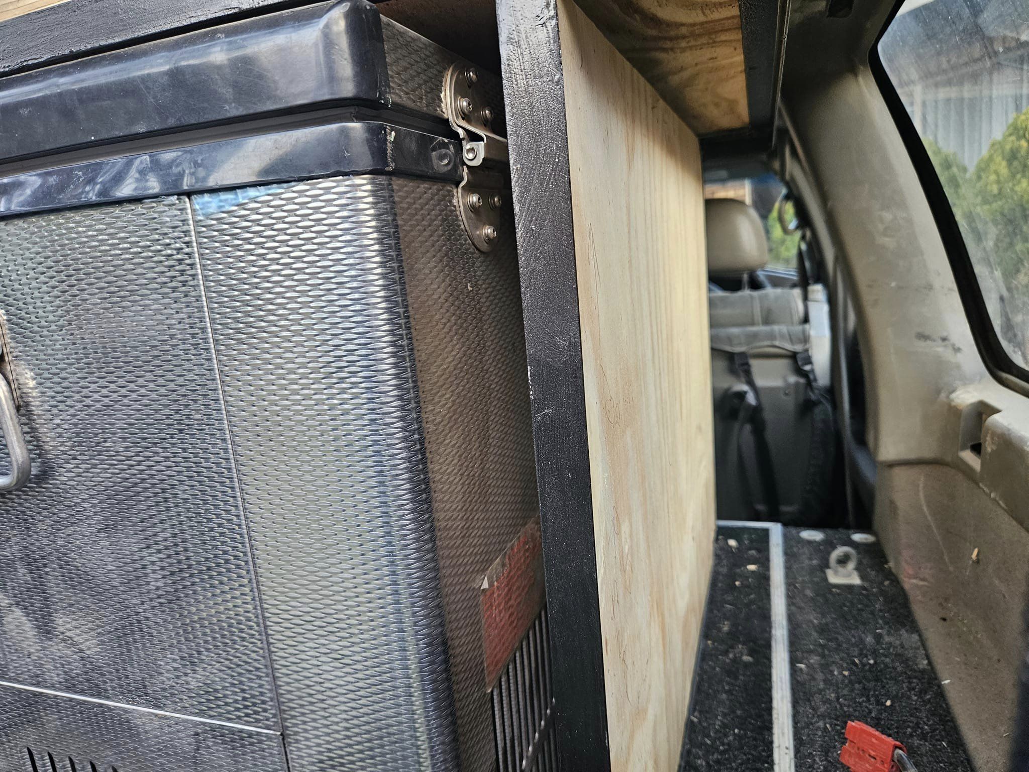

I've got a drawer system and a fridge slide in the boot. When I first started on the overlanding type thing, a very large number of trips I did solo and that worked perfectly. However, since Liana, the LF, accompanies me these days. And since wimmin like packing everything including the kitchen sink on trips, space has been getting more of a problem.

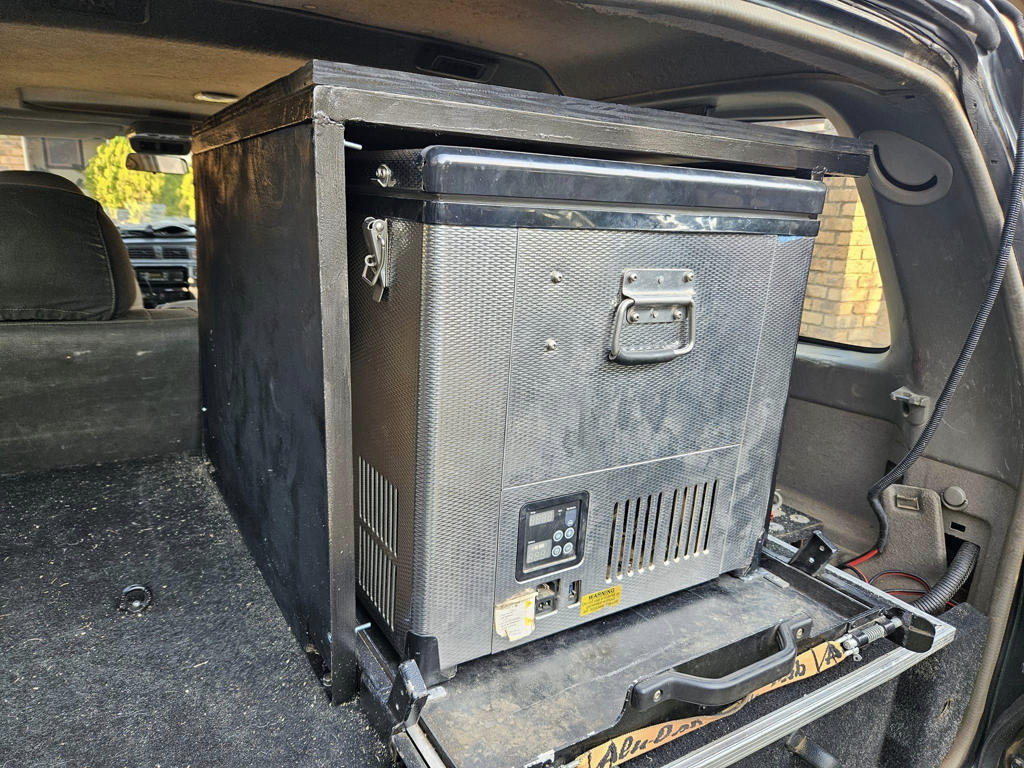

The draw system I have has a "built in" fridge slide. The top shelf on the right hand side can slide in and out. I always found this a little impractical though. Although I'm tall, even I'd battle to rummage around inside the fridge if I used that. So I put on an Alucab tilt fridge slide. It means I can get to my beer easily. :)
Sure - there is enough space for the two of us, but what has been sort of annoying me recently is that using the fridge is sometimes a pita when I'm packed. If there is stuff on top of the fridge, I need to unpack it. And then if I slide the fridge out, it is always a mission getting it back in as stuff falls down behind the back of the fridge when I pull it out. This means that despite the tilt slide, I cannot get to my beer easily. :(

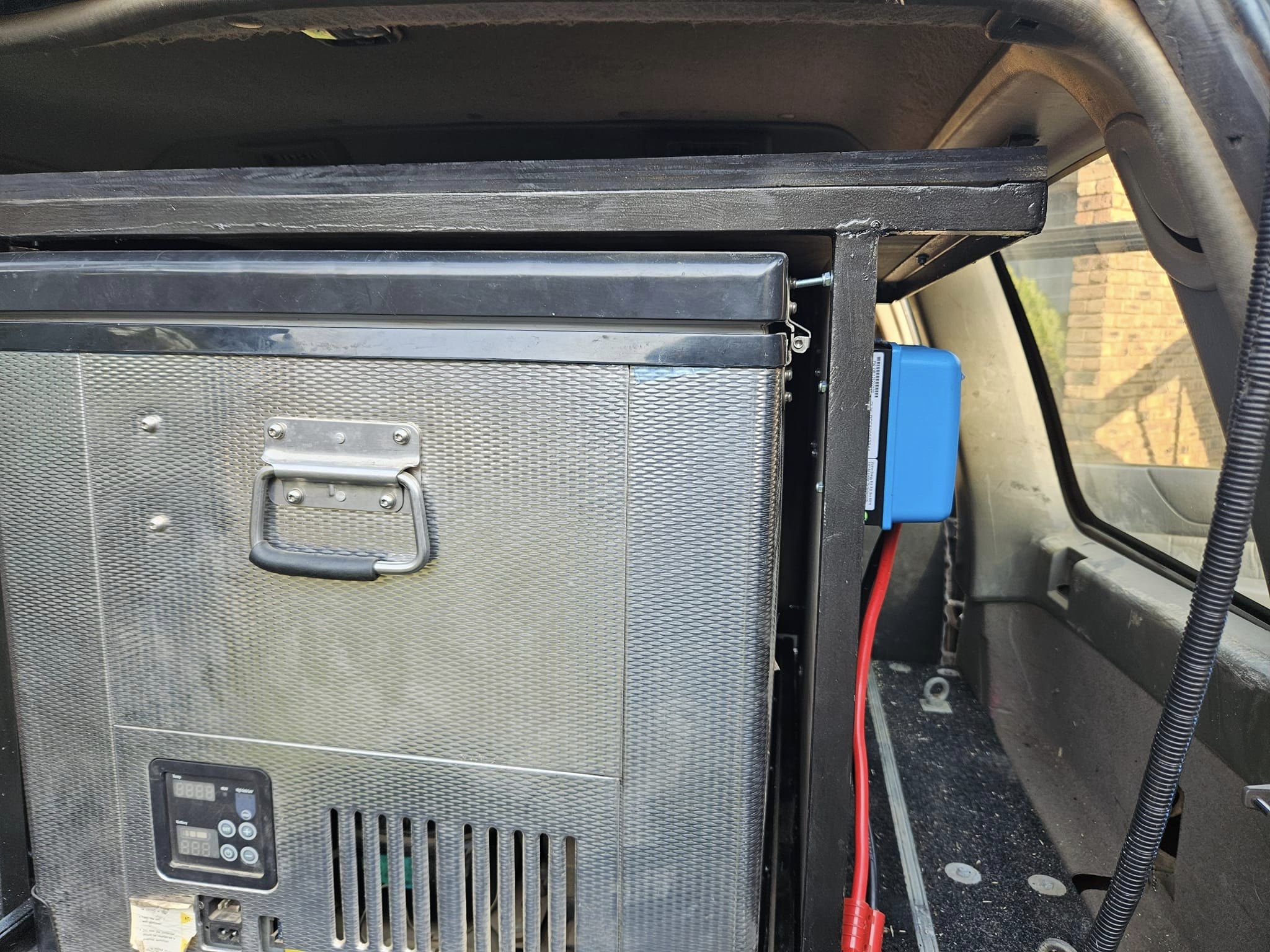

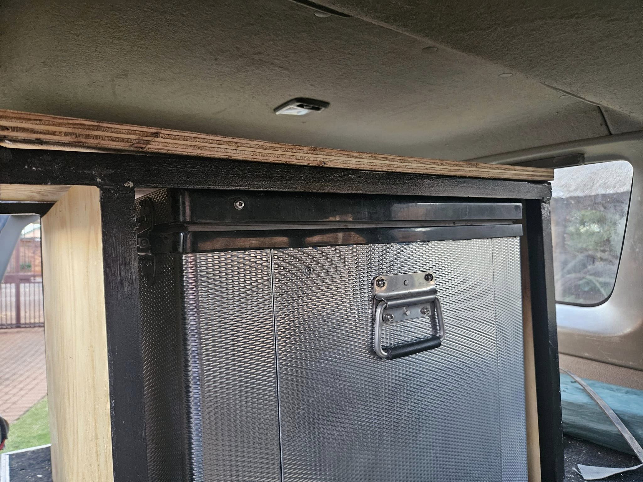

A couple of months ago, I welded together a frame for a packing thingy that fits over the fridge and thus solves the problem. I never got around to finishing it, as this was when I broke my foot and tore ligaments - I was welding, my one leg went dead and my "dead" foot caught on the door step when I walked in. Stupid, but these things happen.

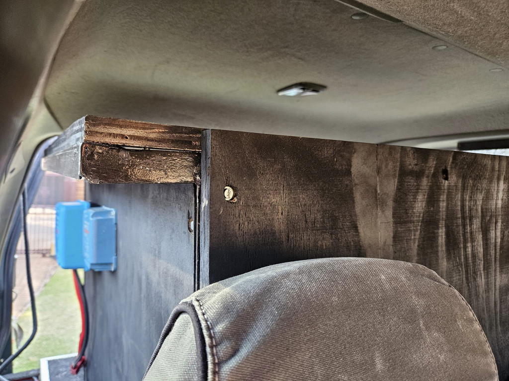

Last weekend I finished the frame, gave it a dash of Hammerite and got it mounted and started cutting the shutter ply for the sides. On Wednesday, I finished cutting the shutter ply. Although I'd normally carpet these things, I don't have enough time to finish it properly at the moment. So I just gave the shutter ply a spray of matt black.

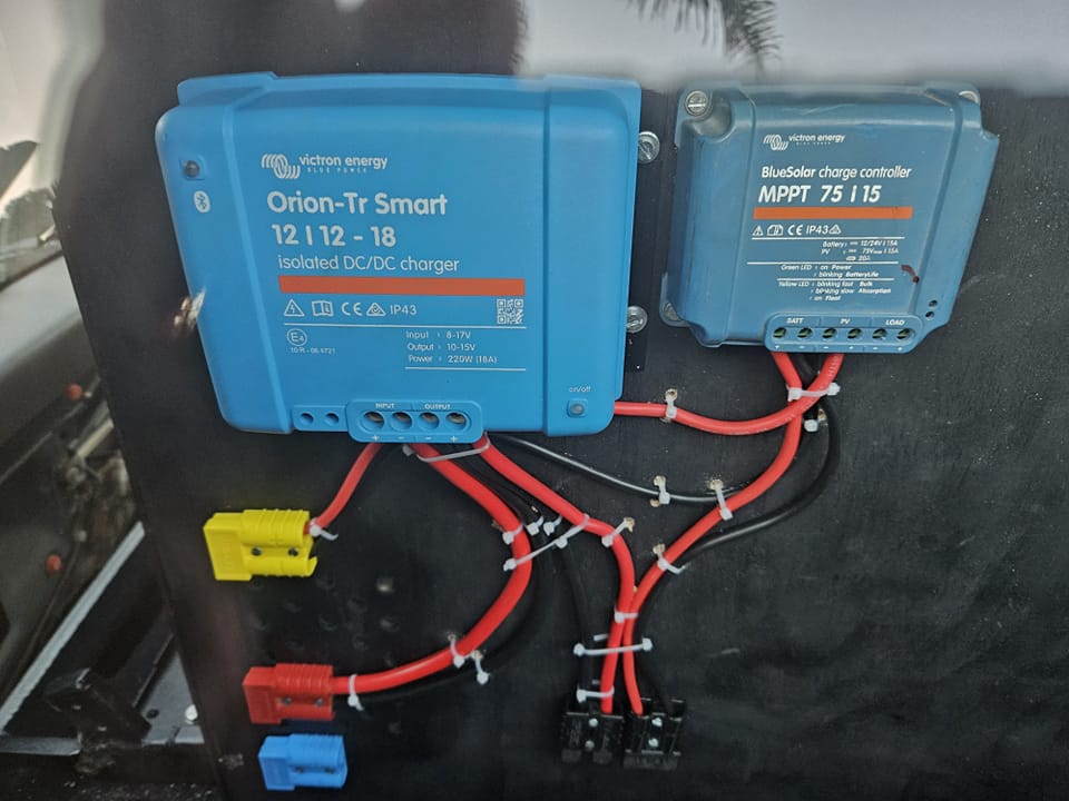

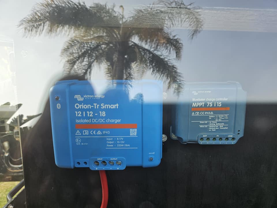

Apart from providing unmolested access to the fridge when we are completely packed, it has also provided me with a nice spot to mount my DC-DC and my MPPT charger. The DC-DC charger is new - I think I have eventually seen the light... The MPPT I always had stashed in a drawer and would just haul it out as needed...
I've got to finish wiring up the electrics, after which I can put my aux battery in again and finish it up for now. Well, until I pull it all apart again to carpet the panels...
I know Manny is going to make disparaging remarks about the welding as he has already done on FB. But it is actually properly (if a little scruffily) welded and it will do the trick.
The sawdust in the boot is from the build. But yes - my truck is filthy and I need to have it washed some time... :)

Wired up charge controllers over the weekend - it is a little messy (I await disparaging comments) but I'll neaten it up when I remove the panels again for carpeting after this trip...
The packing system is done, but I am rebuilding my aux electrical system at the moment. I'll post more details on it when I finish it, as I do not have much time before I leave.
I've colour-coded the plugs so that it is idiot proof. Well, I presume it is idiot proof. I've still got to find an idiot to test this theory with though...
Yellow == PV input.
Red == Alternator input.
Blue = Fridge output.
Black == Output from charge controllers to aux battery.

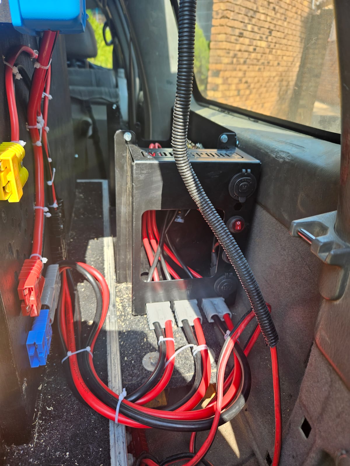

Since I've now got the DC-DC charger, my NL battery box was redundant. It's also been annoying me. The plugs and everything are on the side, so it's always been a mission plugging things in etc. It's also massively big. So I acquired a Voetspore battery box - just the bare box with no internals... It's nice. It has lugs for bolts - so I've bolted it to the steel from of the packing system. And the place where the plugs come in fit on the ends. Even better - the side the plugs are are interchangeable. So you can decide which side you want the stuff on. It has space for a hella plug, a lighter plug and three brad harrisons.
I wired it up over the weekend. Naturally, I've got a strip fuse as close to the positive as possible, a positive bus and a negative bus. Two of the BH plugs are wired to provide input from the MPPT and DC-DC chargers. The other BH is output for the fridge. It's super basic currently - no controller bits so I will need to rely on the fridge settings to prevent it from discharging too much etc. Overall, I am happy.
When I get back from this trip though, I'll make some changes to the setup. I need something to prevent running down the aux battery too much. I'd also like to include a few USB charging ports and a voltmeter. And I must also neaten up the wiring on the side of the packing system.
