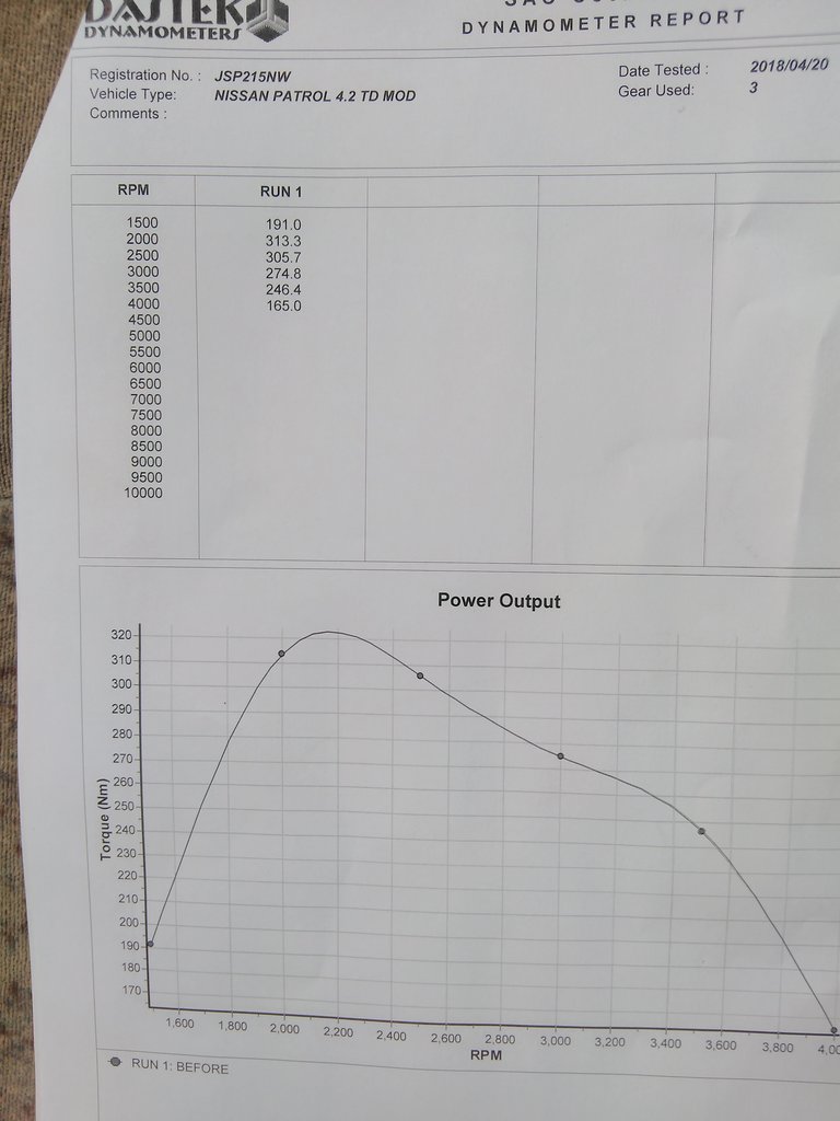

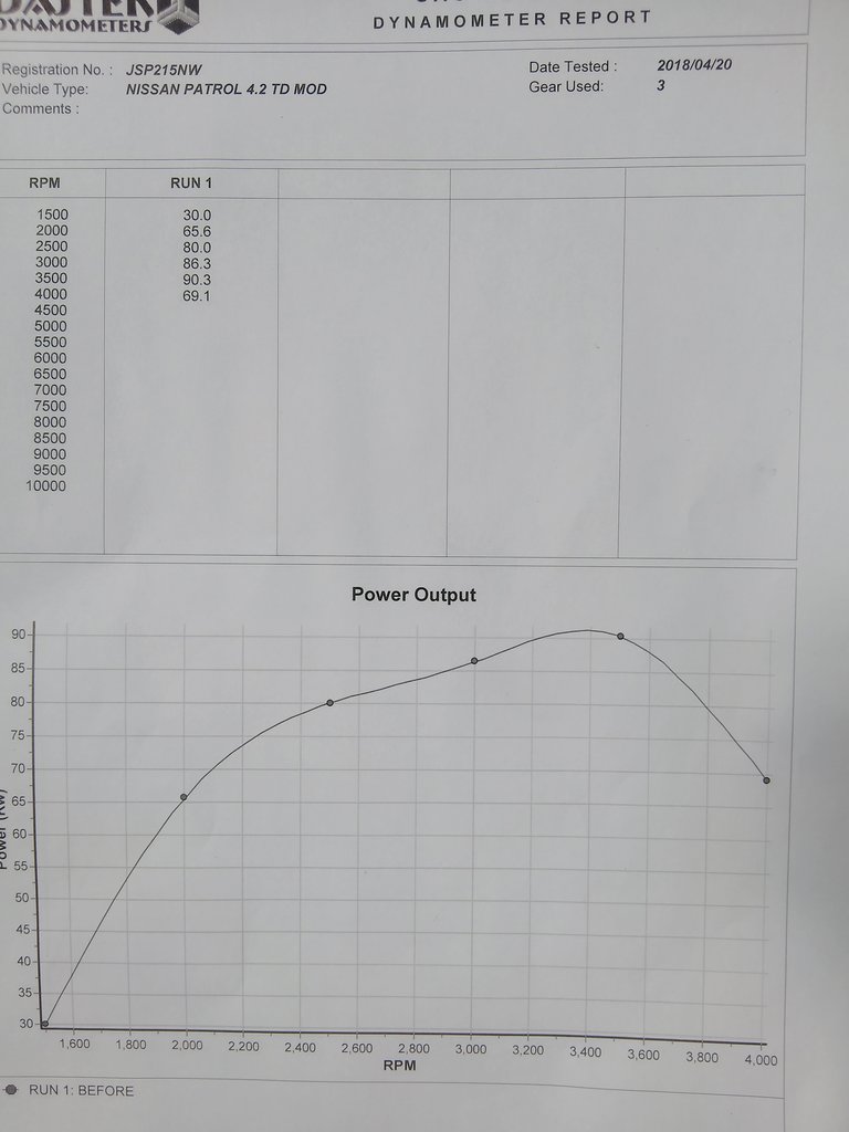

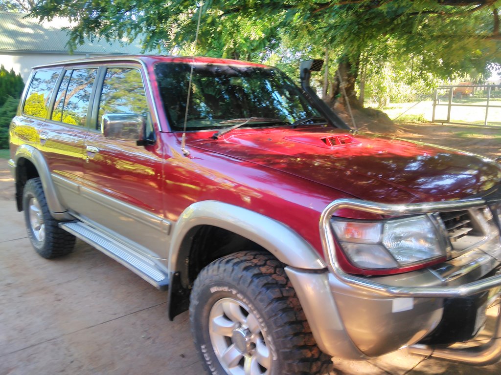

OK, here's the finished product!
Looks very nice. The bonnet was actually a write-off, but panel beater did a good job in fixing it, and fitting the scoop neatly.
The important bit is the difference in performance!
Michael tells me even the guys at SAC were impressed/amazed with how much that littel turbo could churn out! :biggrin:
Consider where we started: 50kW/190Nm on the back wheels (80% up on kW, 65% up on Nm!)
Also, taking standard losses into consideration, this gives it roughly 120kW and 420Nm on the engine!!!

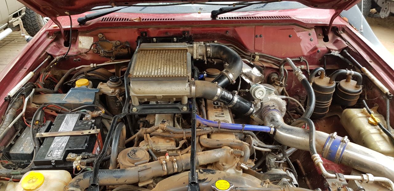

Intercooler

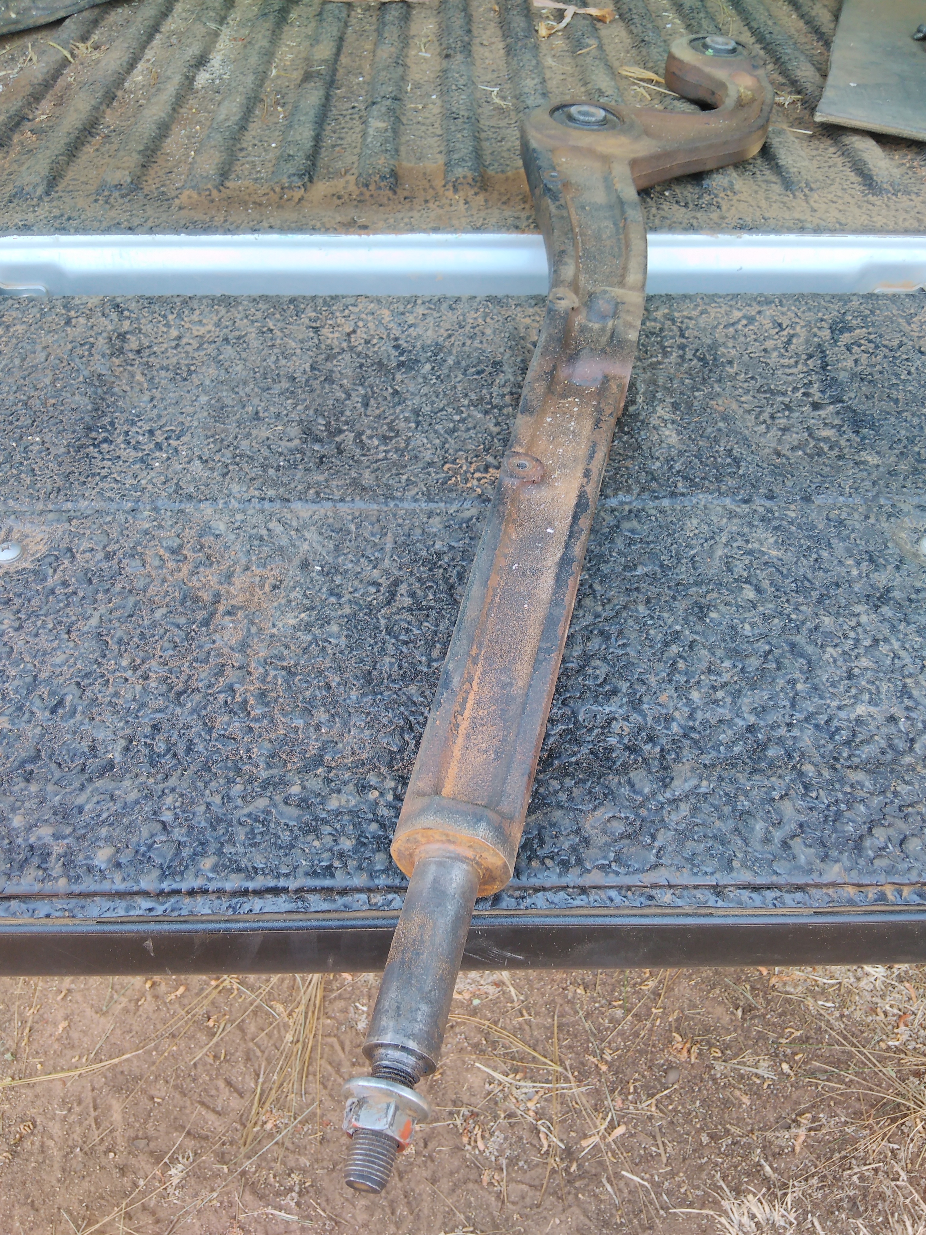

2) Control arm, en voorste wielbearings en seels:
Ek moes noodgedwonge my voorste wielbearings vervang. Interessant was dat die vorige eienaar hul op 'n stadium moes vervang het, en die seels "verkeerdom" (tegnikus se woord) ingesit het. Dit beteken dat ek water tot in my voordiff sou gekry het as ek deur diep strome gery het. Genade!!!
Control arm bushes moes ook vervang word. Met die losdraai van die linkerkantste arm, draai die ding toe AF! :surprised: Erens moes die ding in sy 20 jaar sekerlik rowwe pad gery het. Wel, ek was oppad op vakansie en moes toe gou plan by ingenieurswerke laat maak. Sien foto...
threaded rod ingedraai waar die arm gebreek het
Ek het vir 500km so gery, maar intussen 'n nuwe een laat insit. So, as iemand dringend 'n control arm met nuwe buste nodig het...ek reken hy sal 'n ruk hou!
