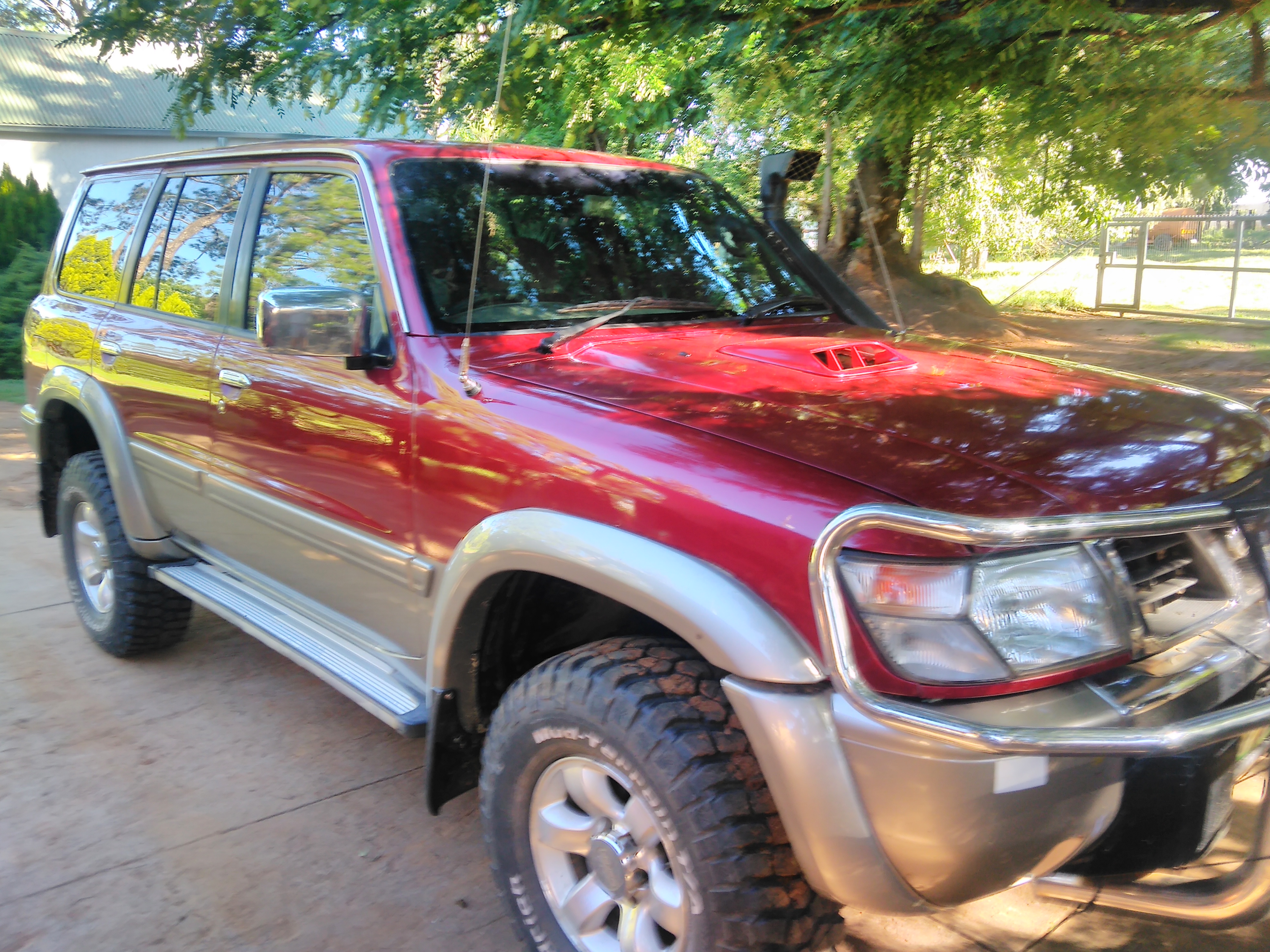

OK, here's the finished product!
Looks very nice. The bonnet was actually a write-off, but panel beater did a good job in fixing it, and fitting the scoop neatly.

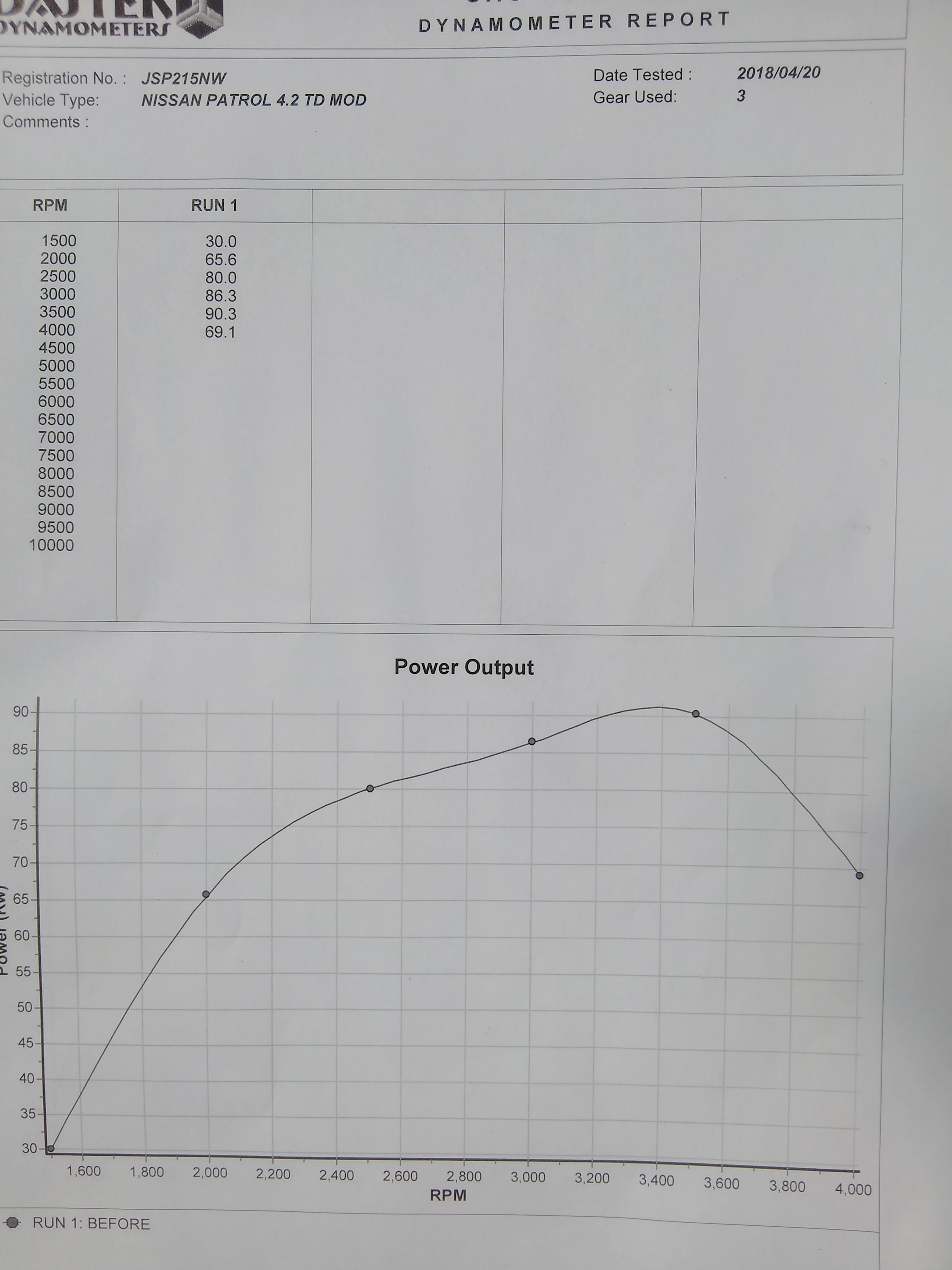

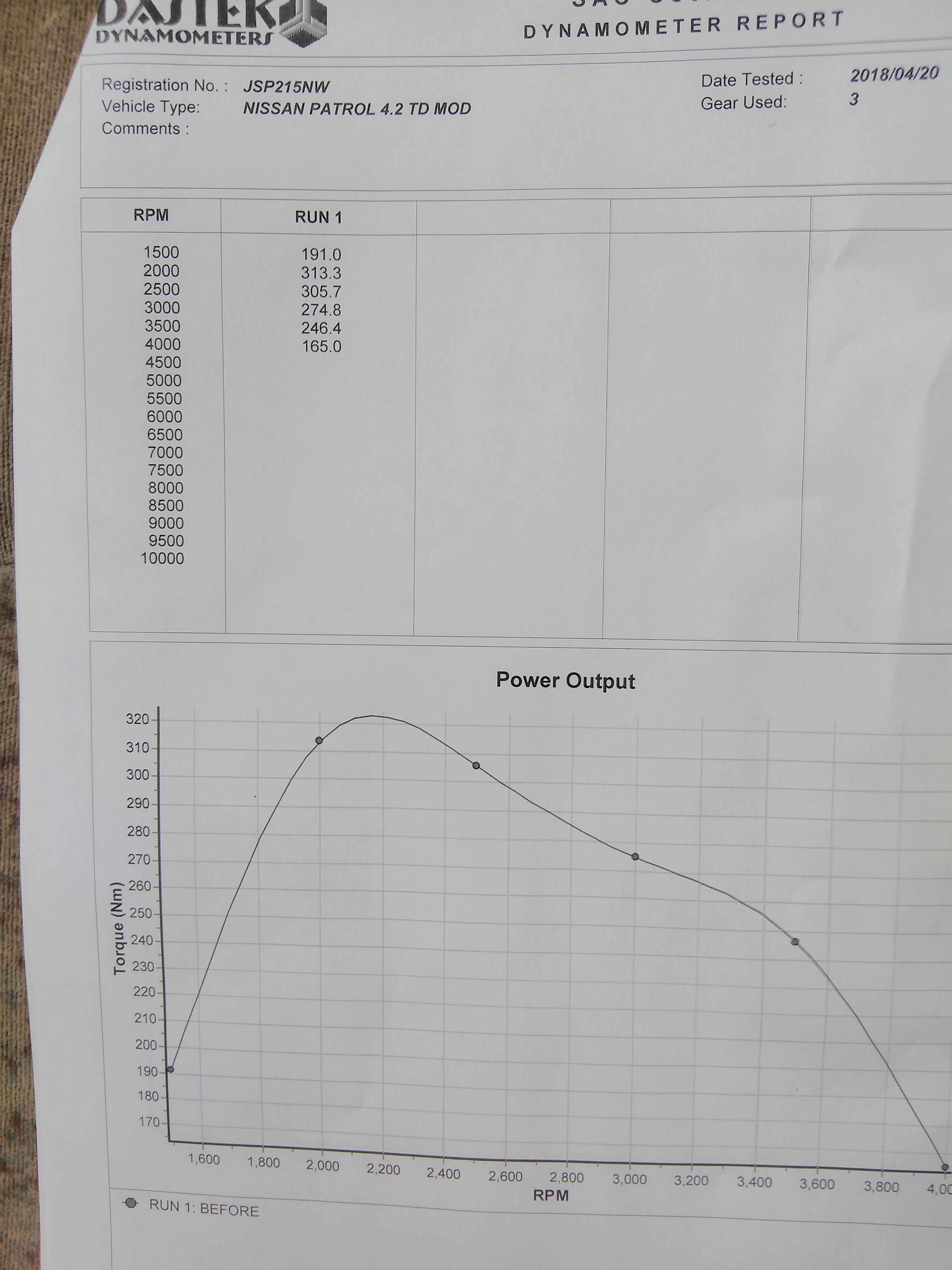

The important bit is the difference in performance!
Michael tells me even the guys at SAC were impressed/amazed with how much that littel turbo could churn out! :biggrin:
Consider where we started: 50kW/190Nm on the back wheels (80% up on kW, 65% up on Nm!)
Also, taking standard losses into consideration, this gives it roughly 120kW and 420Nm on the engine!!!
OK, on road experience ('cause that's what matters!)...
Where the difference after stage 1 (Turbo and exhaust) was slightly more than subtle, now it's a new car all together!
It runs through first so quickly, you almost want to start in second.
Between 80km/h and 120km/h (overtaking), there is a lot of willingness to move forward, on my trip back home I realised this immediately. Max torque is around 105km/h in 5th.

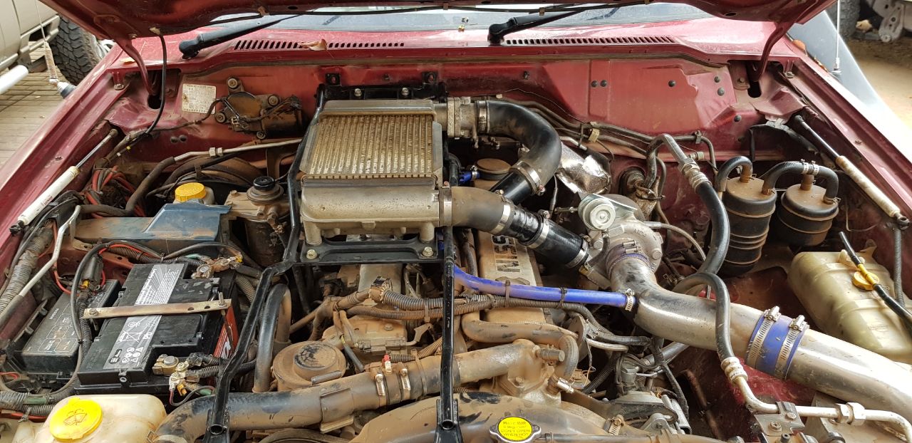

Intercooler
