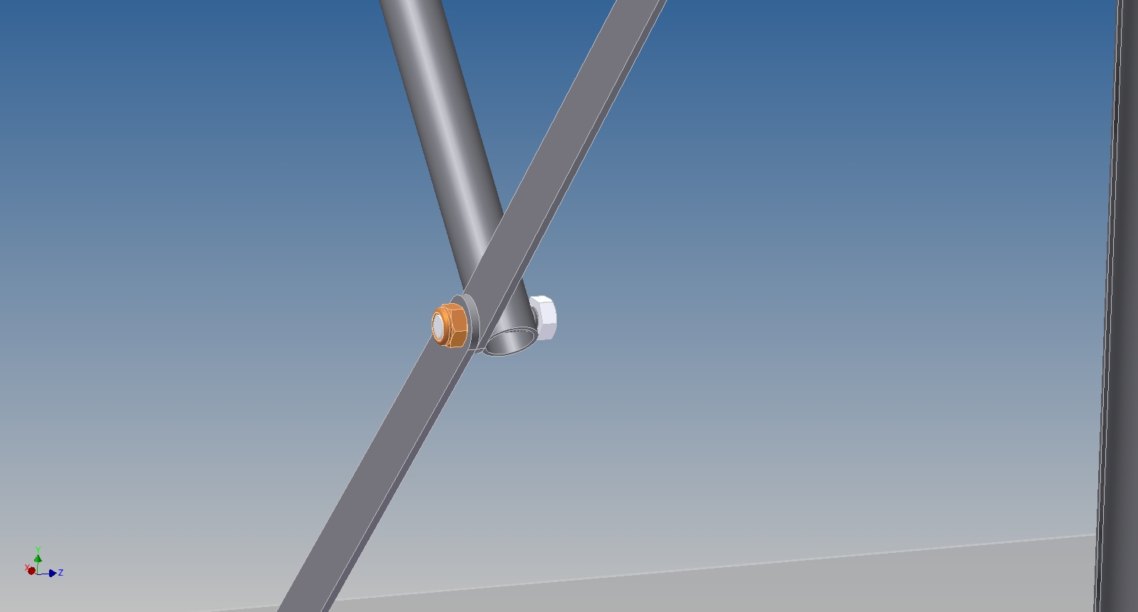

Would like to see closer pics of the mechanism of the pole system, the way the elbow work and how you incorporate the T joint from the roof section into this elbow.

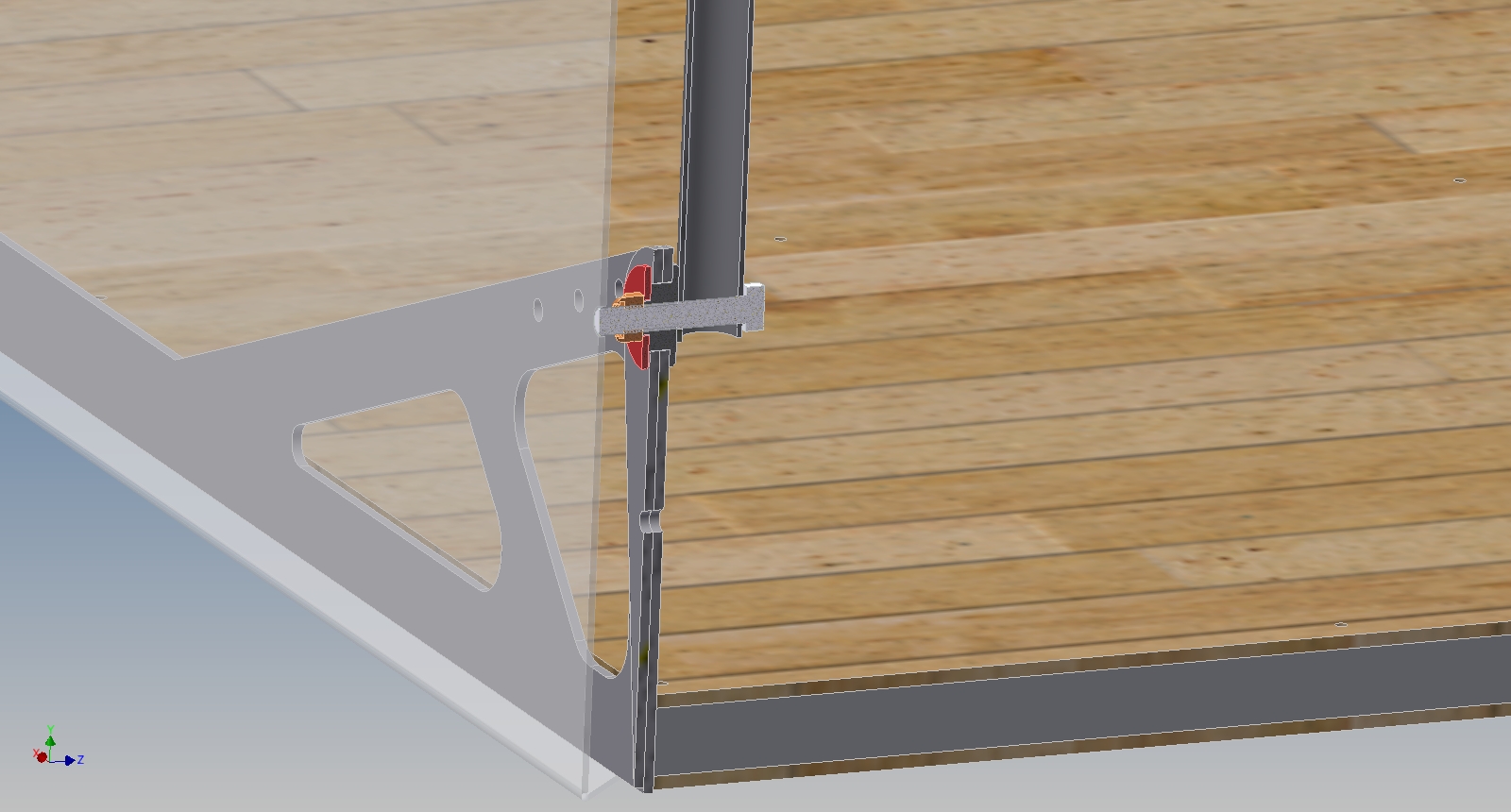

Dankie Koos, I will give them a call.
At some stage I will take some close-up photos for you, but in effect the central arm is bolted to the frame at the hinge point. The bolt passes through the arm, then through a threaded top-hat style bush wich passes through the extensions of the floor panels:
From higher up on this arm, there are two two-piece links going to each floor panel. each linkage arm is equally long, and the distance from the hinge to the mounting hole is the same on the floor panel as it is on the arm. The length of these arms is carefully calculated so that when the floor is flat (IE the tent is fully open) the links are straight. The other two arms that hold the tent open are bolted to the joint between these linkage arms:
The actual angle of these arms are not controlled by the frame, but by the canvas.
The plan is that the basic tent will be made from 380gsm poly-cotton ripstop canvas, the spine (which is exposed when the tent is folded closed) will be PVC tarpaulin and the flysheet will be320GSM Polyester ripstop. I have made the windows and doors as large as possible, and there are also vents in the roof under the flysheet. I am also thinking of making the divider between the two rooms from some other material to allow it to absorb the moisture condensing from our breath.

Peter, thx for the pics, I understand fully now.

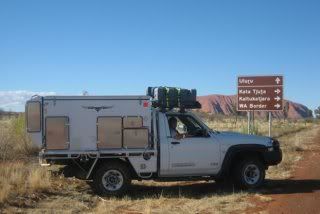

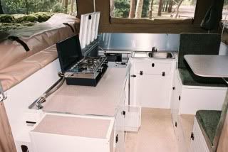

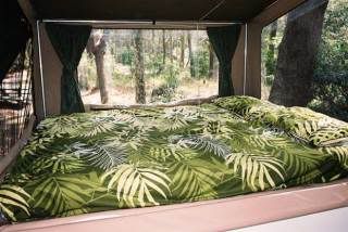

This is what I mean a slide on, it slide on and stand on 4 legs when camping , you use your vehicle normally as a flatbed.
The design of this camper , you stand inside, BUT here is the PERFECT design, look everything thats inside you can access from the outside, ie, you can cook inside or outside.
Queen size bed !!!!!, n man is nie n klip nie!!!!!!!!!!!!!!!!!!!!!!!!!!!!!!!
The 1 st pic is approx the same design as Peter's design, just much larger.
Land Rover Discovery 3 TDV6

Koos my dad has something like that, although probably a bit smaller, but which fits onto a standard bakkie loadbed.
This particular one was made by Radical Tops (they have since sold it to somebody else) and has room for two people. We have modified it extensively to make it easier to put on and remove from the bakkie, and it is a wonderfull device from this point of view, as you can arrive in camp and within 2minutes be ready to camp for the night, or you can unload it from the vehicle in about 20 minutes ready for an extended stay.
It has one problem though: It is very heavy (particularly when loaded) and the centre of gravity is fairly far back. This affects the handling of the bakkie (in this case a previous-shape 2.7 hilux) on corrugated roads very badly. The worst are the long corrugations found on the soft sand roads of the Kalahari, where it starts bouncing to the extent that my dad practically has to stop. I guess it would work better on a Patrol bakkie or a cruiser, but on the normal bakkie this is a problem.
On a more personal note it would not work for me because I need the seven seats of the Patrol, and cannot afford both a big bakkie and a big SUV, so I needed to make the Patrol work. I also don't want to tow, and I just prefer the patrol to any bakkie I have ever used.

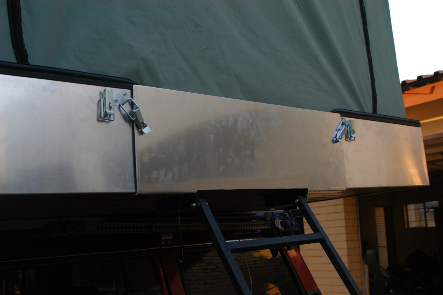

Koos that gap in front of the door you are worried about will get an aluminium clip-on cover with sealing strips shortly.

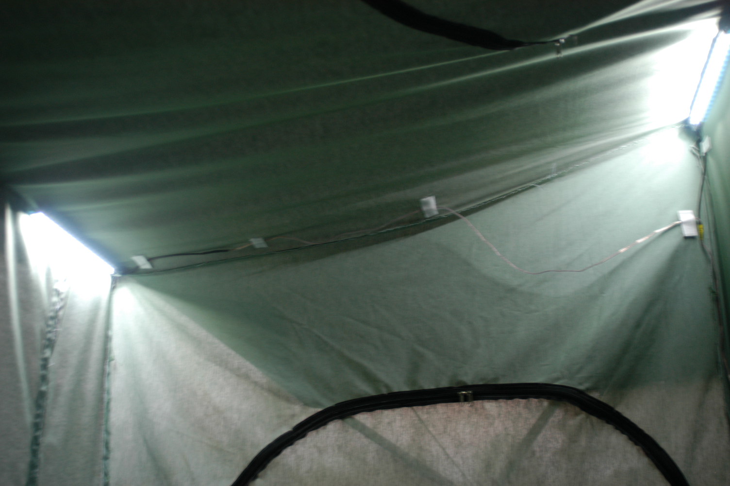

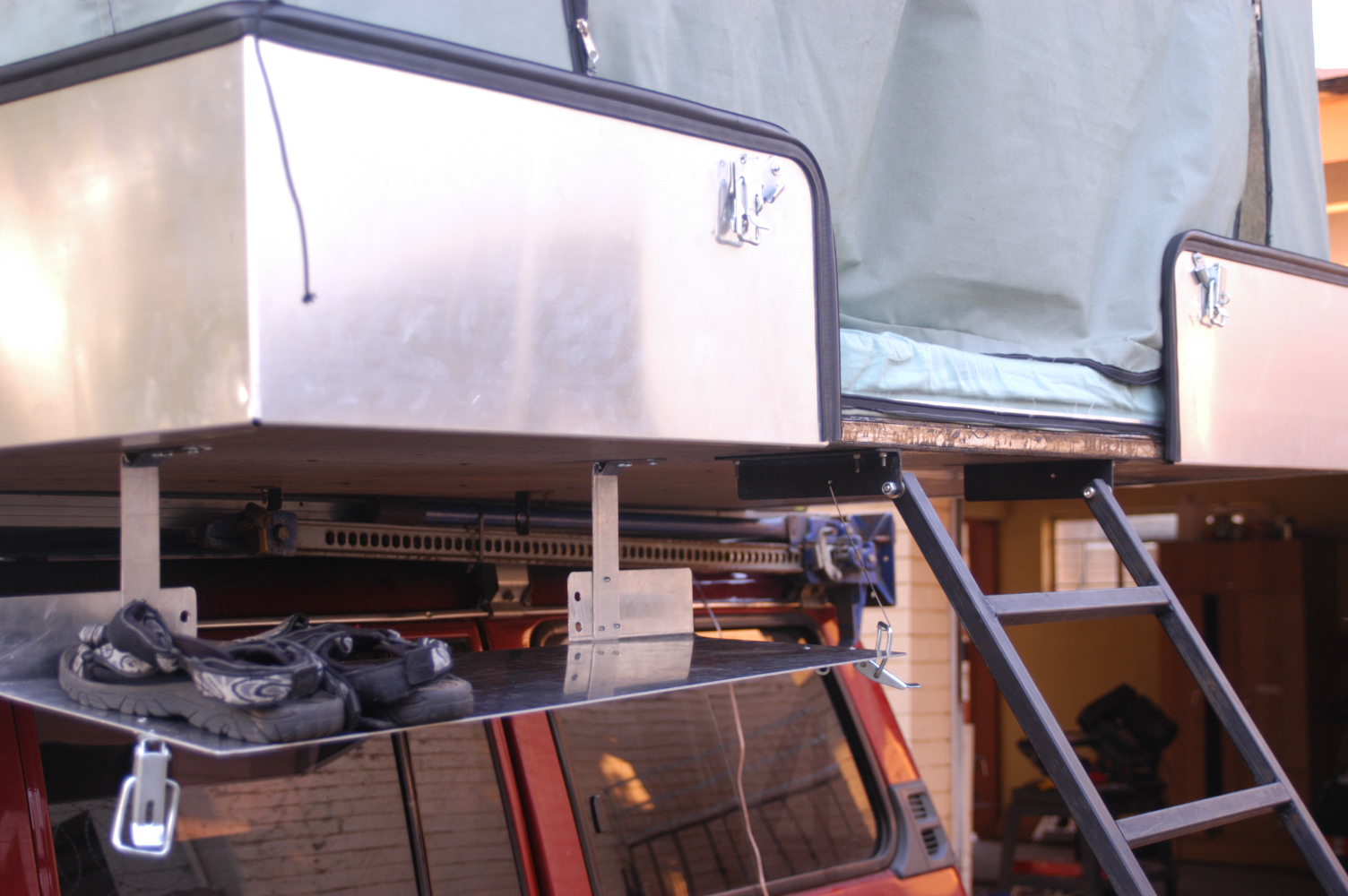

Managed to get a couple of more things done this weekend.
I made a clip-on cover for the dooway:
When the door is removed, it clips onto the bottom of the tent, so that there is somewhere to put your muddy shoes:
I also fitted two strip lights into each room, with both lights in each room connected through a conveniently located switch. The lights plug into a hella plug I mounted in the wheelarch a while ago, so that the car can be completely closed and all the doors can be operated as per normal without having to worry about wires etc.:
Weather permitting, I will be trying it out on the weekend of the 24th. A fitting occasion indeed?
