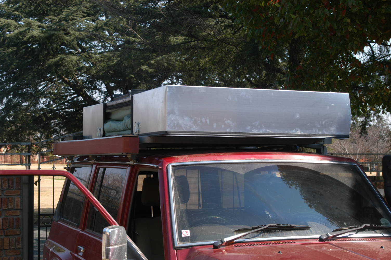

I (with the invaluable assistance of my Fiance) am busy building myself a roof-top tent.
The main reason is to save time pitching camp and packing up again. The main problems with commercial rooftop tents (for my situation) are:
1) There are four of us, of which 1 is a teenage girl. Therefore we need a fair amount of room, and it needs to be divided into two "rooms" for privacy reasons.
2) While there are large enough rooftop tents available, they are much more expensive than the "standard size" ones, and from what I have been able to gather they are also very heavy.
Putting on two rooftop tents was not an option, as my roofrack is not large enough, and having the kids sleep on the ground while the rest of us sleep on the roof also doesn't work for me.
I therefore spent a lot of time designing a framework that is strong enough yet reasonably light. I then built the frame, which is quite a labour-intensive exercise due to my chosen fabrication. We have just finished putting together a "prototype canvas", so that we can test it before shelling out money for somebody to make me the tent from proper canvas, because my fiance's sowing machine is not suitable to work with canvas, and also because it is better to make a booboo on cheap rags than on real canvas, which is quite expensive stuff.
This is where I am now: It is 2.1m long and when open 2.45m wide. It weighs about 70kg, which is about the same weight as most manufacturer's 1.3m tents. It is divided into two rooms of 2.1m x 1.23m but the divider has a large door in it.
Due to the unique linkage system it also has significantly more headroom than any rooftop tent I have looked at, and mean that it is strong enough to function without the ladder or in soft sand where the ladder doesn't give any support.
The aluminium skirts mean that one doesn't have to clamber around to fit a bag over it. The side that is currently open will be made from the same heavy stuff that the bags are usually made from, and there will be a door in the gap on the other side. I also still have room on my roofrack for a few jerrycans and a gas bottle.

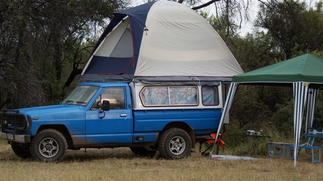

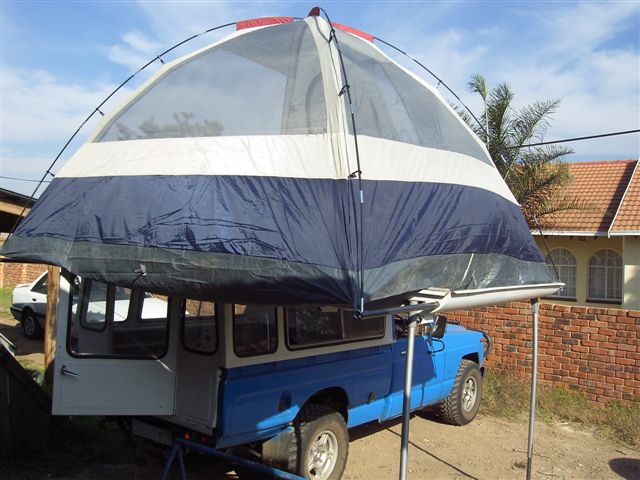

Ek soek ook altyd genoeg ruimte so dis wat en met my Safari gedoen het:
Ek wil nie nou jou storie oorneem nie

Netjies Kobus, en ek is seker dis sommer baie goedkoper as myne ook, maar ek dink nie dis so vinnig soos myne nie.
Hoe vou hy op, is daar genoeg plek om jou beddegoed in te los? Ook, waar klim julle op?
Met my huidige grond-tent-opset is die ding wat regtig lank vat nie soseer die opslaan van die tent nie, maar die in-en-uitpak van die beddegoed ens.
Alhoewel, hierdie tent vat mider as 'n minuut om op te slaan en daar is nie veel tente wat so vinnig opslaan nie, en dan is jou beddegoed klaar daar.

Oom Mac ek het lank gewik en geweeg om te besluit hoe om daai deure moet oopmaak, en om eerlik te wees kan ek nou nie eers onthou hoekom ek besluit het om hom so om te maak nie, maar ek weet daar was 'n rede gewees.
This is exactly why we first built it from cheap rags, so that things like that can be tested and re-thought. When lying in the tent, our heads will be close to the bottom, so it will allow us to only partially open that door/window and yet be able to see out, my idea is to sow on two velcro strips from the top to about 1/2 way down, and then two small pieces on the bottom on the outside, that way you can open the window part-way and keep it that way?
Re: Daktent
Die Safari se een vat langer - so 10 minute - maar jy het baie plek want jy kan tot regop staan op die bed.
Jy klim by die kanopie se deur in en die bed is op die deel van die dak wat oopslaan. Binne in die Safari se bak is daar baie plek vir jou vrieskas - selfs 'n Porta-Pottie sodat jy nie in die aand rond hoef te loop nie - en jy kan ook jou gasstoof gebruik vir koffie en ontbyt voordat jy hoef uit te klim.
