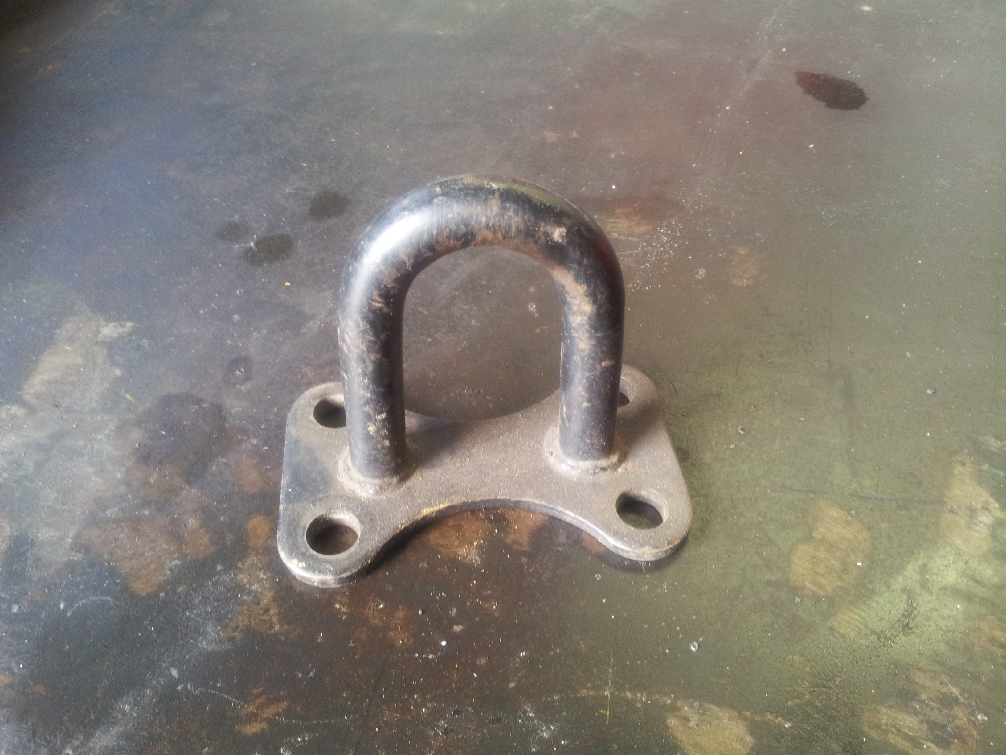

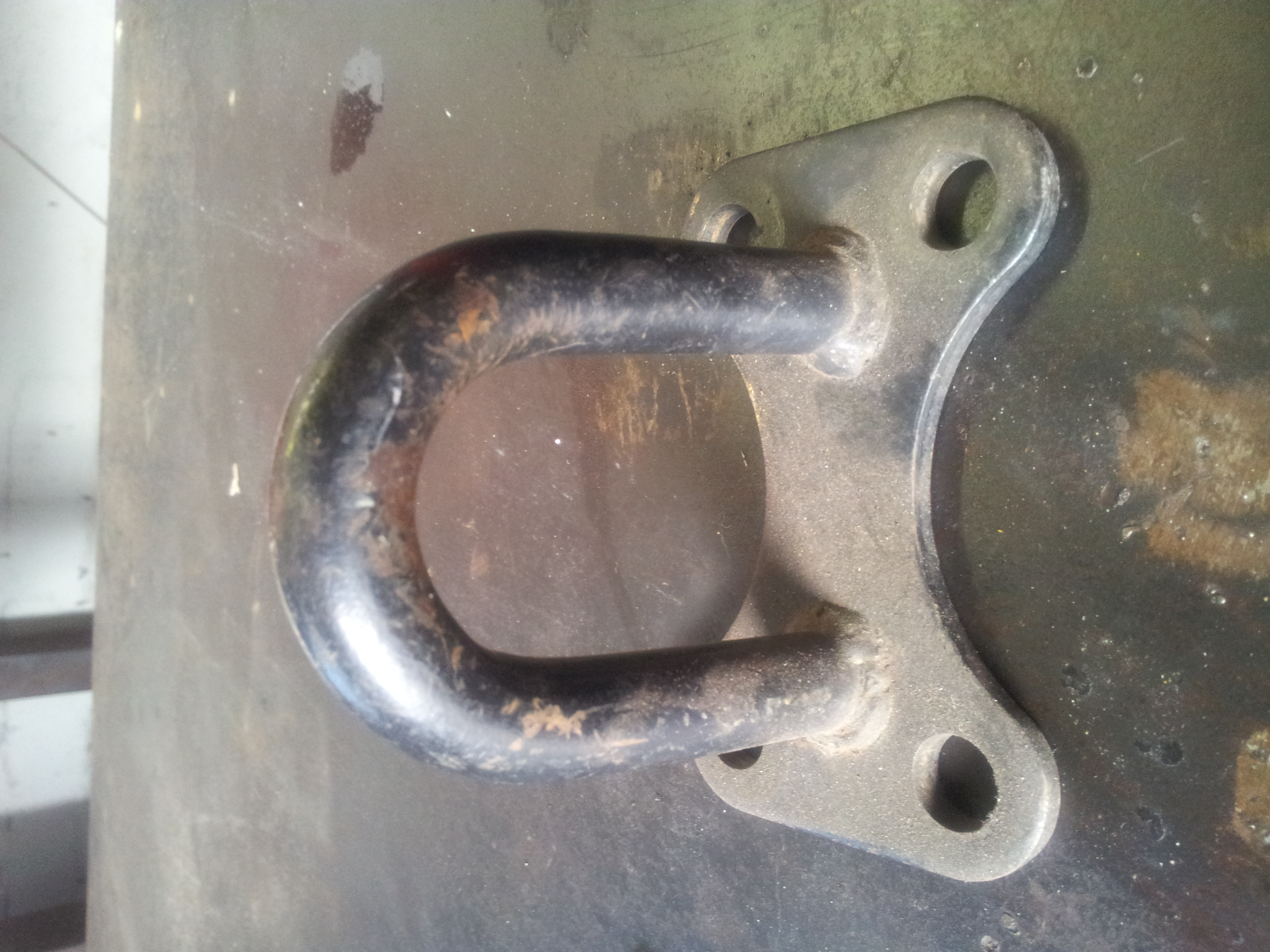

Here are the pics of the Y61 ''recovery loop'' that I am now questioning.
Here is the standard loop in question.
Note the weld size.
Note the weld size.

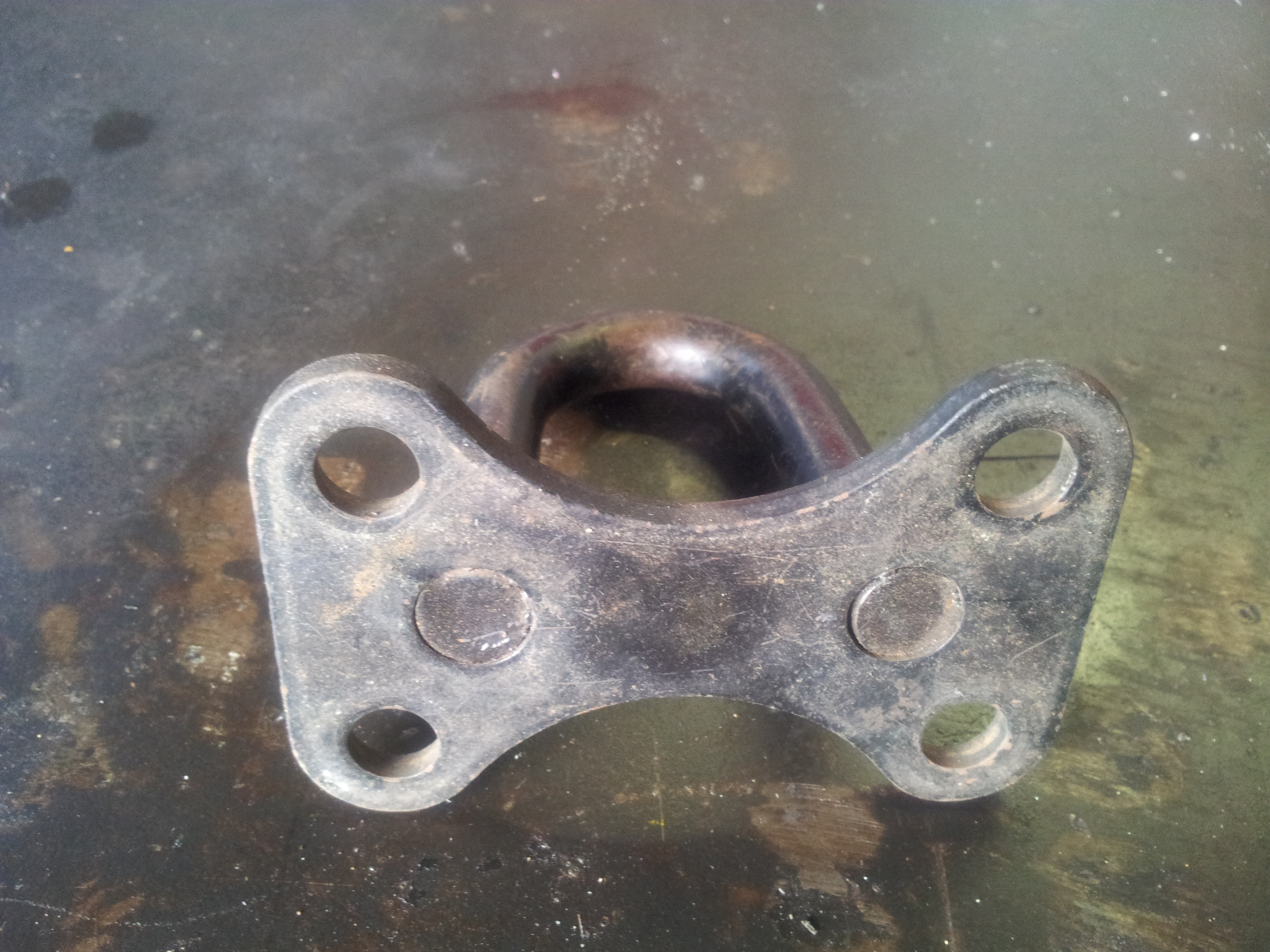

This is what the loop looks like when removed and turned on its side to expose the joint on the inside. Observe the quality of the joint.

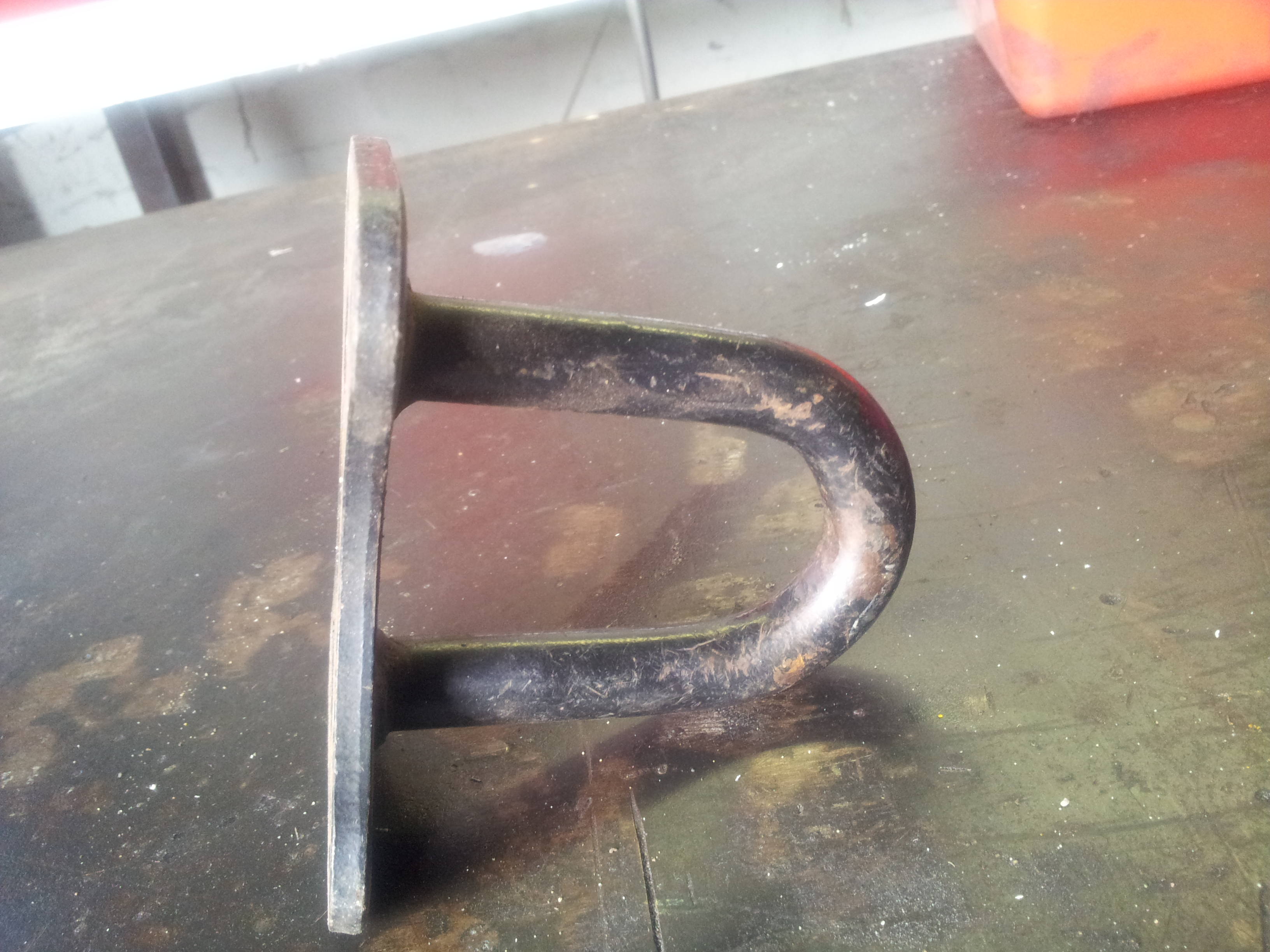

Look at it from the side. Observe the size of the weld and the base plate thickness.

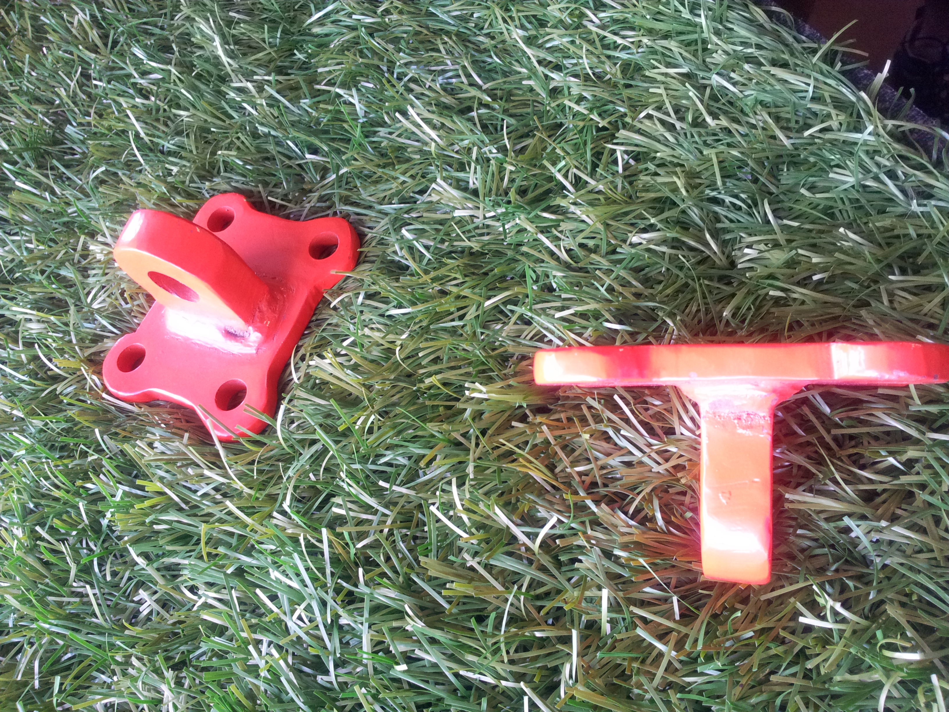

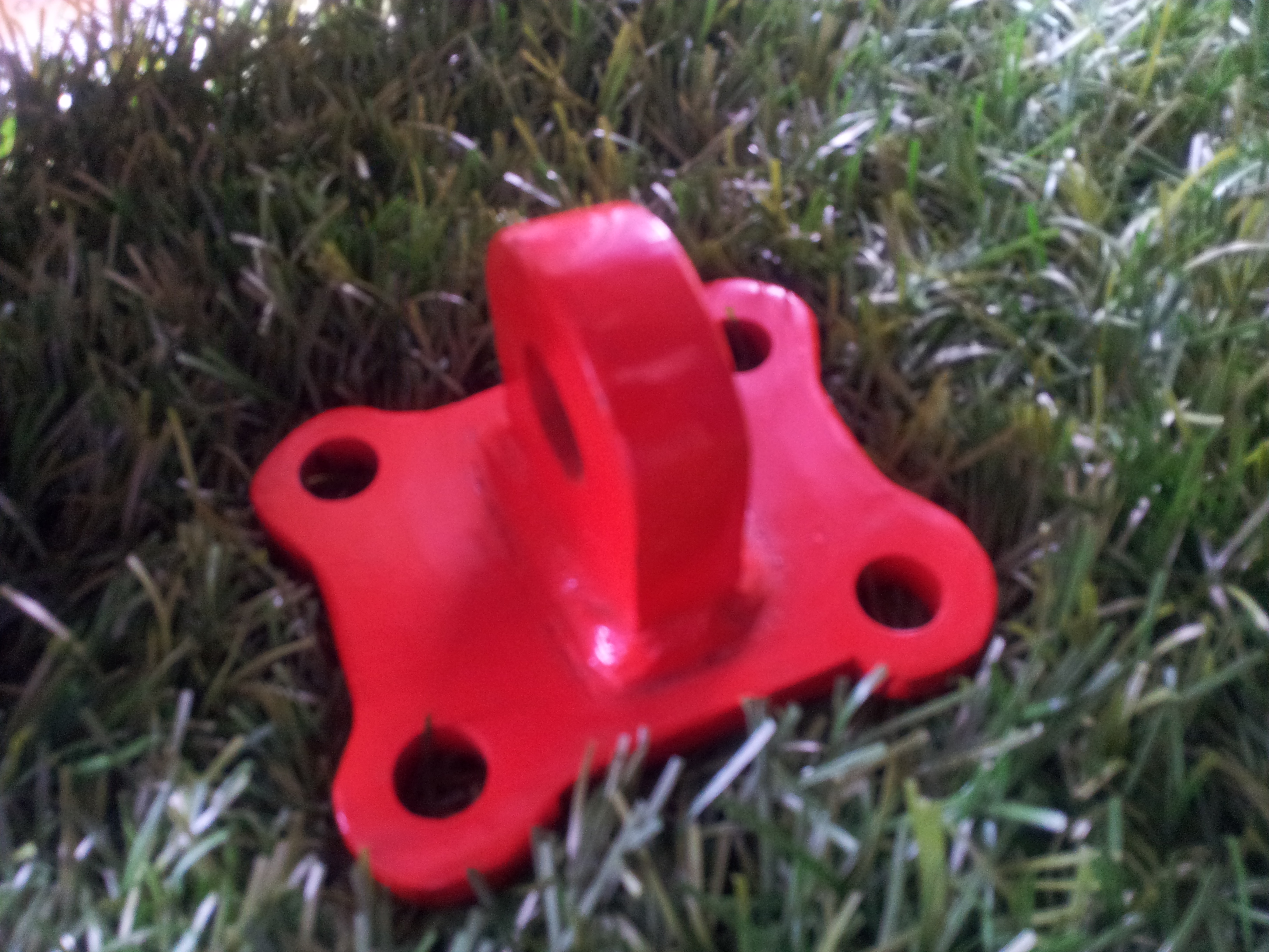

This is a smaller version of what G-Man fits to Patrols. The one fitted to Patrols are significantly bigger and more robust.

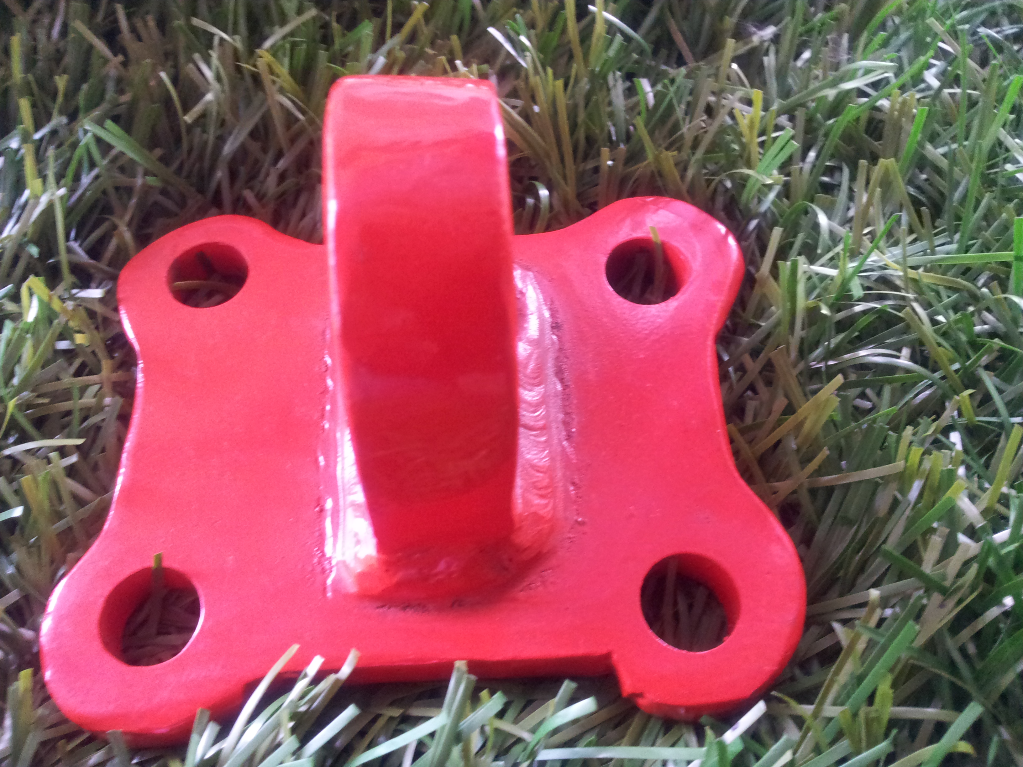

Another view of G-Man's design. I believe that this design is a significant improvement on the standard fitting.
You can now make up your own mind whether you think it is safe to use the standard loop for serious recovery. I certainly will not be using it.
My order is in for G-Man's Y61 rear recovery point.
For discussion.
