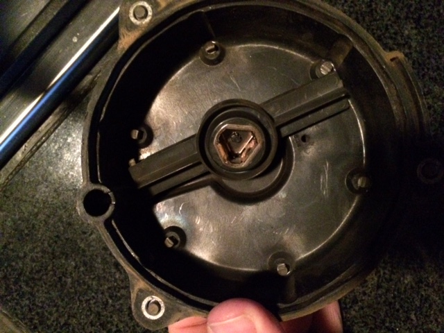

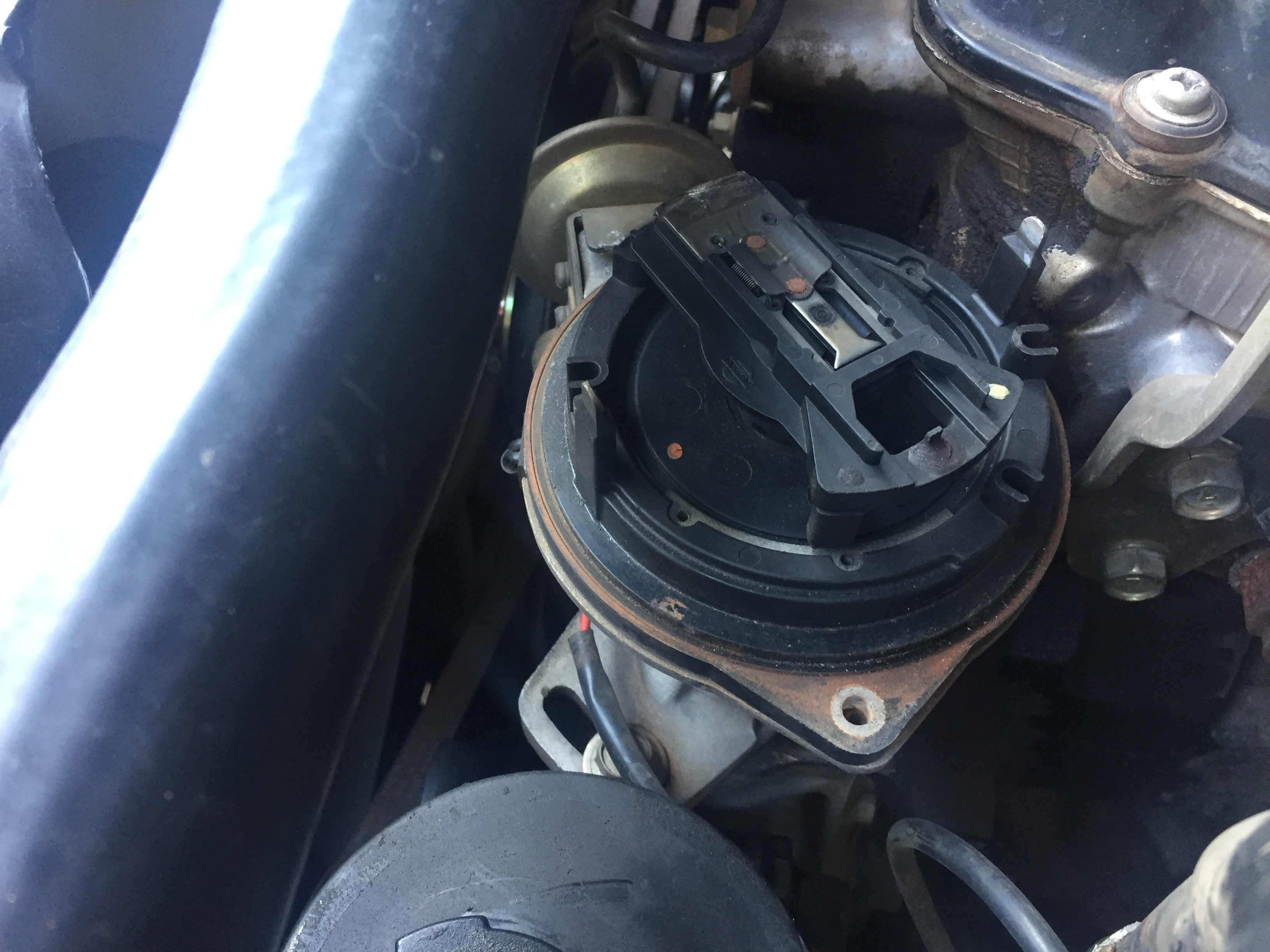

Just for the fun: that is how the distributor looked inside. What do you think - did it have to be replaced, or would it have lasted longer?
- distributor cap
- IMG_4867.JPG (119.57 KiB) Viewed 6164 times

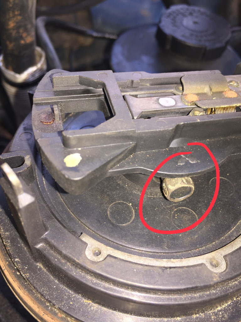

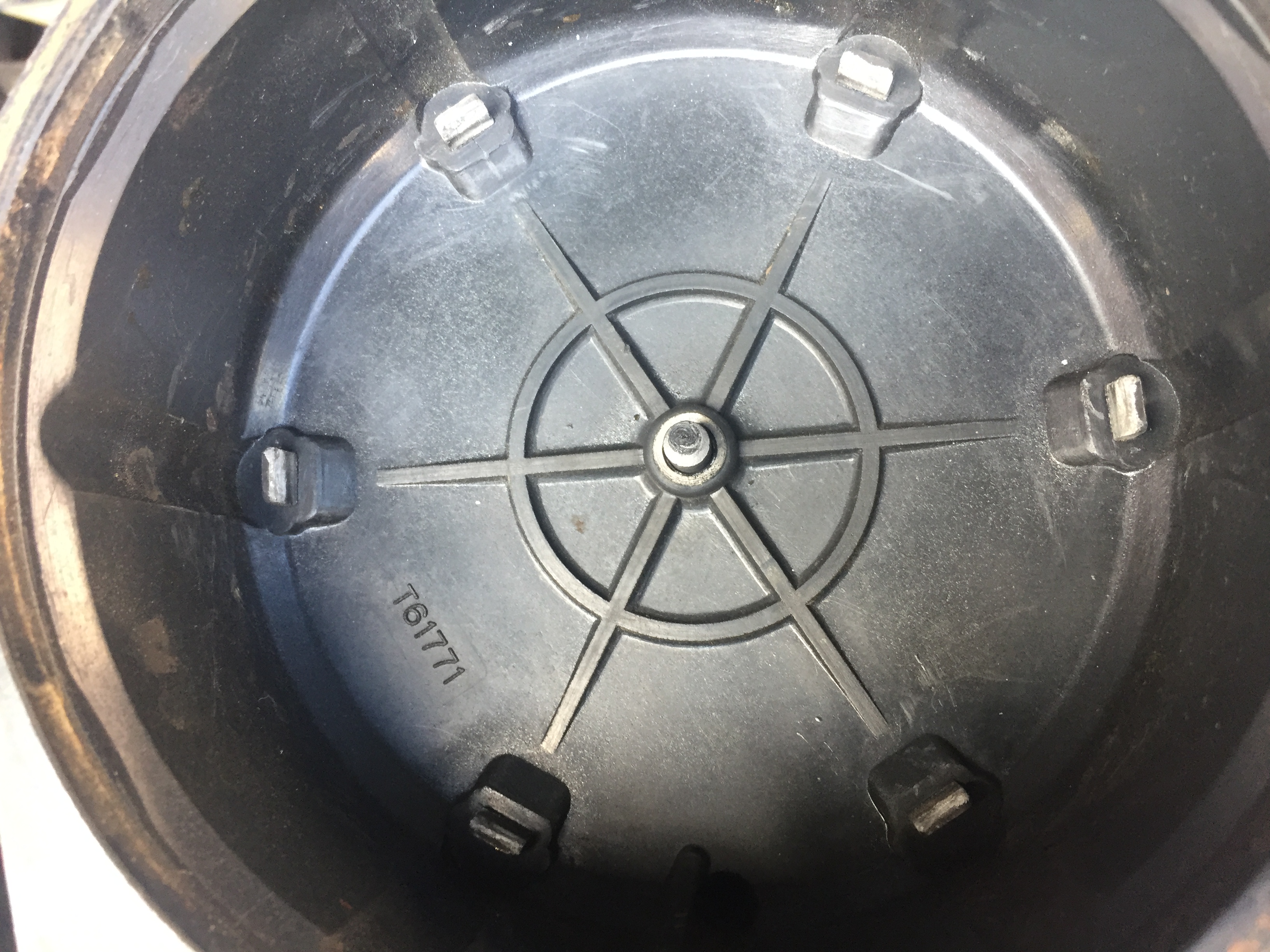

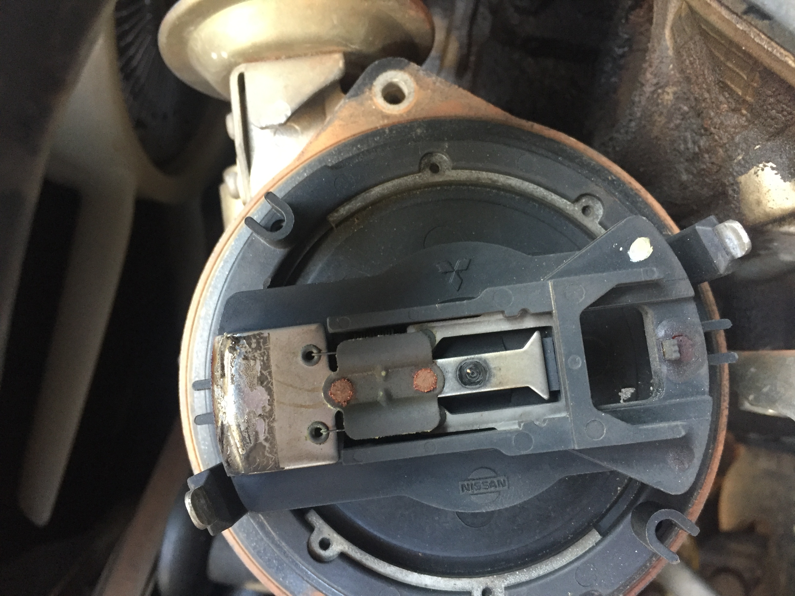

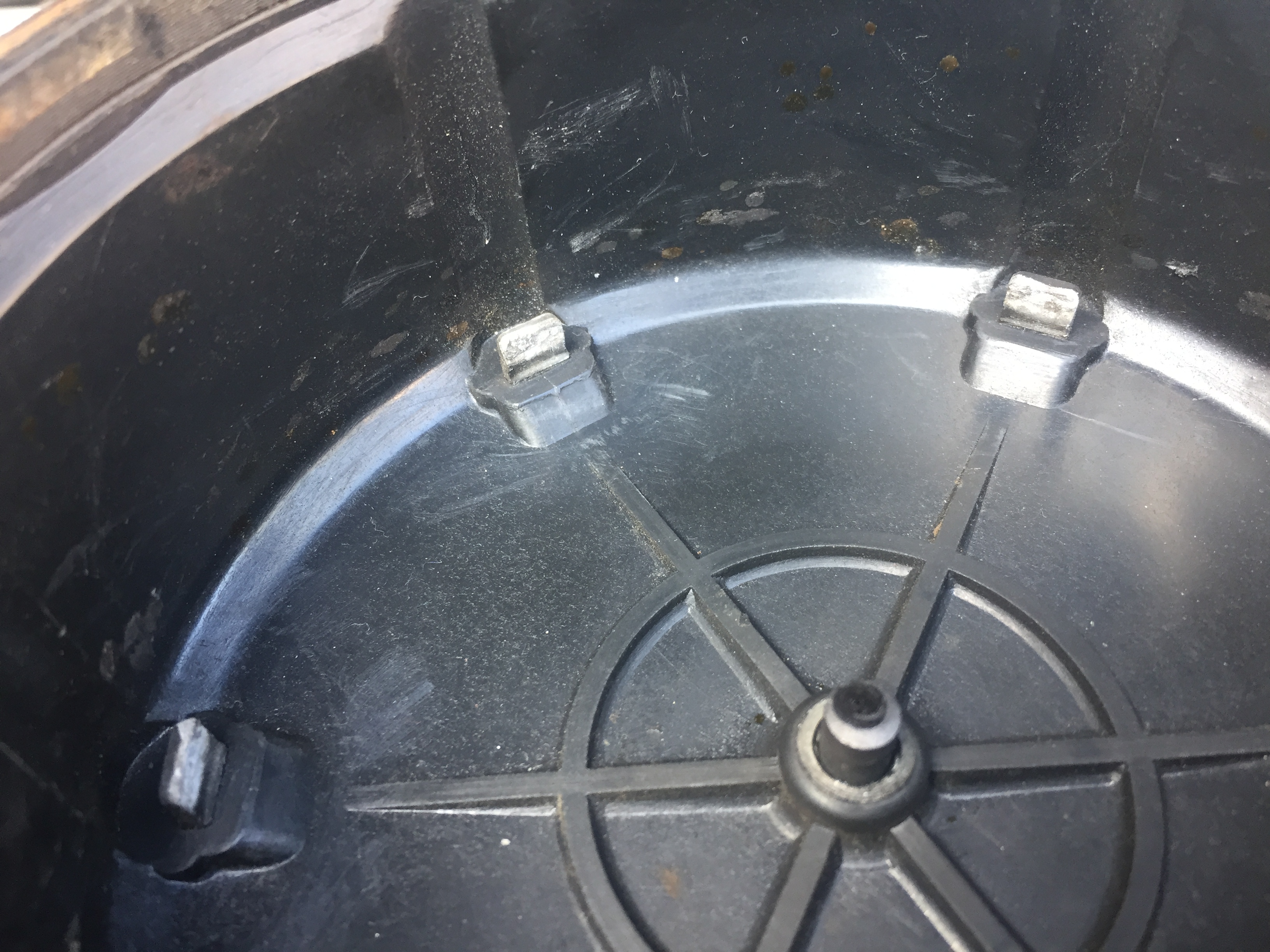

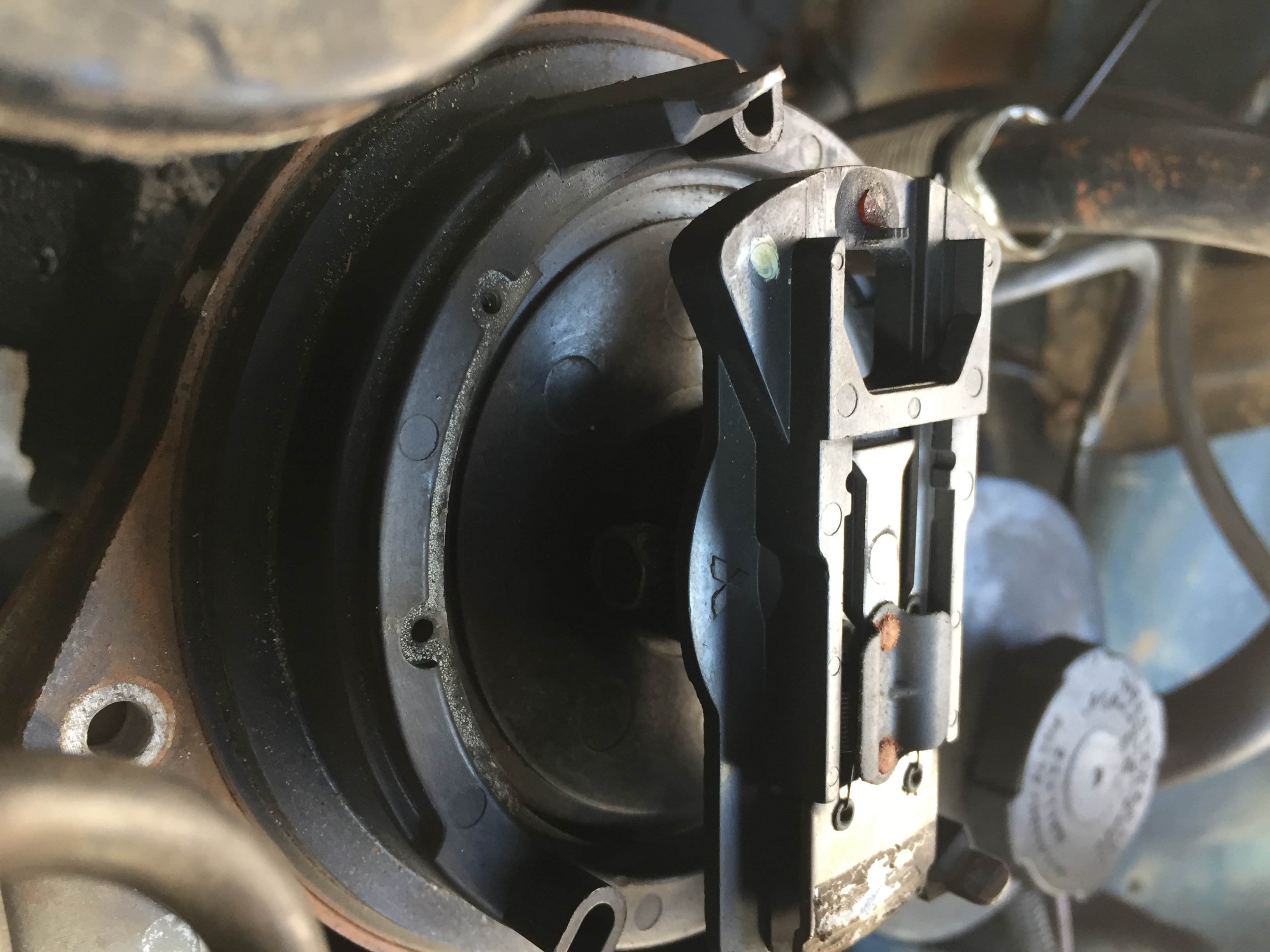

This is what my tb42 distributor cap looks like.
Im trying to get to the ignition points but the bolt to undo the top part of distributor doesnt want to line up so lekker so i can loosen it.
Is there a way to rotate it without starting the car?
- Posts: 6157
- Has thanked: 1134 times
- Been thanked: 1044 times
Re: Distributor cap, rotator and ignition leads - just replace?
Yes.
24mm socket on a ratchet on the crank pulley. Make sure you only ever turn it clockwise so as not to risk loosening the crank pulley bolt or running the timing chain in reverse (the tensioner only works correctly in one direction). You will need to do that anyway in order to be able to adjust the points gap.
