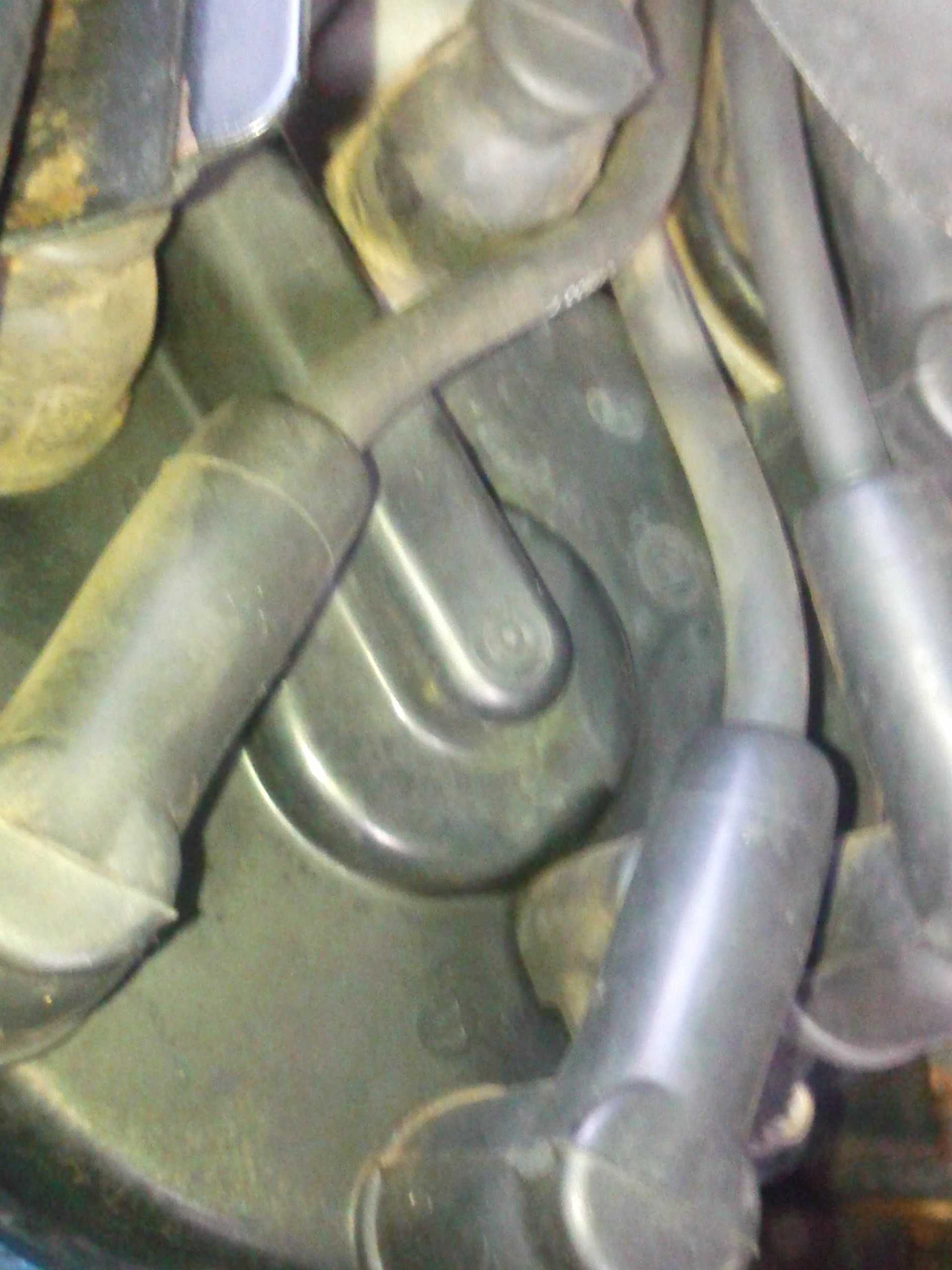

It looks like a 7th lead but is just the moulding on the cap.
On the '99 4.5 there should be no need to replace anything other than the leads. If you do open up BEWARE the optical sensor. You touch you break.
