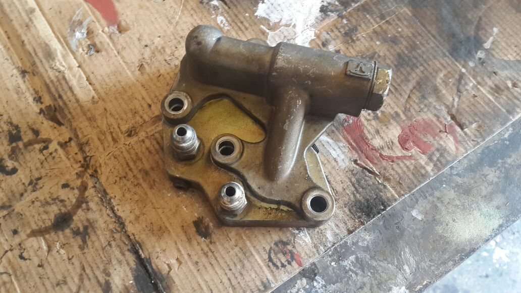

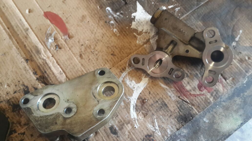

So the oil cooler on a TD42 has been something all TD42 owners have spoken about at some point.
Im rebuilding a UD40 TD42 engine and noticed a very interesting setup they have. It seems like the later UD40 trucks powered with the TD42 engine has an oil cooler and it is a very very simple setup.
Its basically just a 12mm (I think) plate that you bolt inbetween the oil preasure regulator that sits on the exhaust side of the engine. It has two pipes on it that you can route to your front oil cooler and thats it....... cant be very expensive to buy from UD of to have them made up at an engineering shop.

Re: External oil cooler
That looks like a plan!
Where does one get UD40 parts? Not to mention the dreaded "What's your VIN number?" question at the P & A counter...
Yes thatcis one of the questions I dislike the mostChristoSlang wrote:That looks like a plan!
There is a UD dealership in Samrand, but I have phoned them a couple of times for quotes on manifolds and other things and came right without a VIN number every time.
Will see If I can get a part number and price
