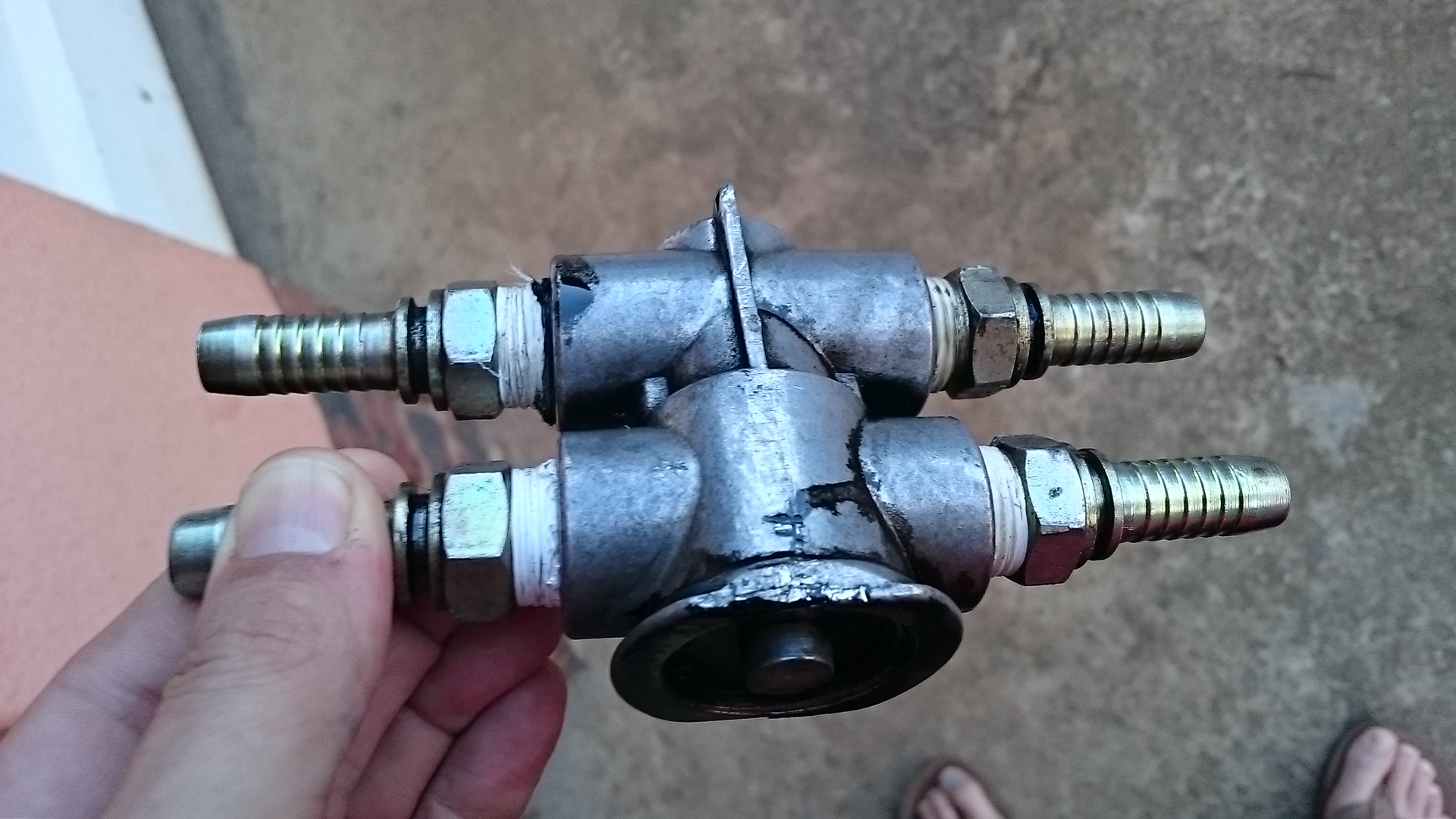

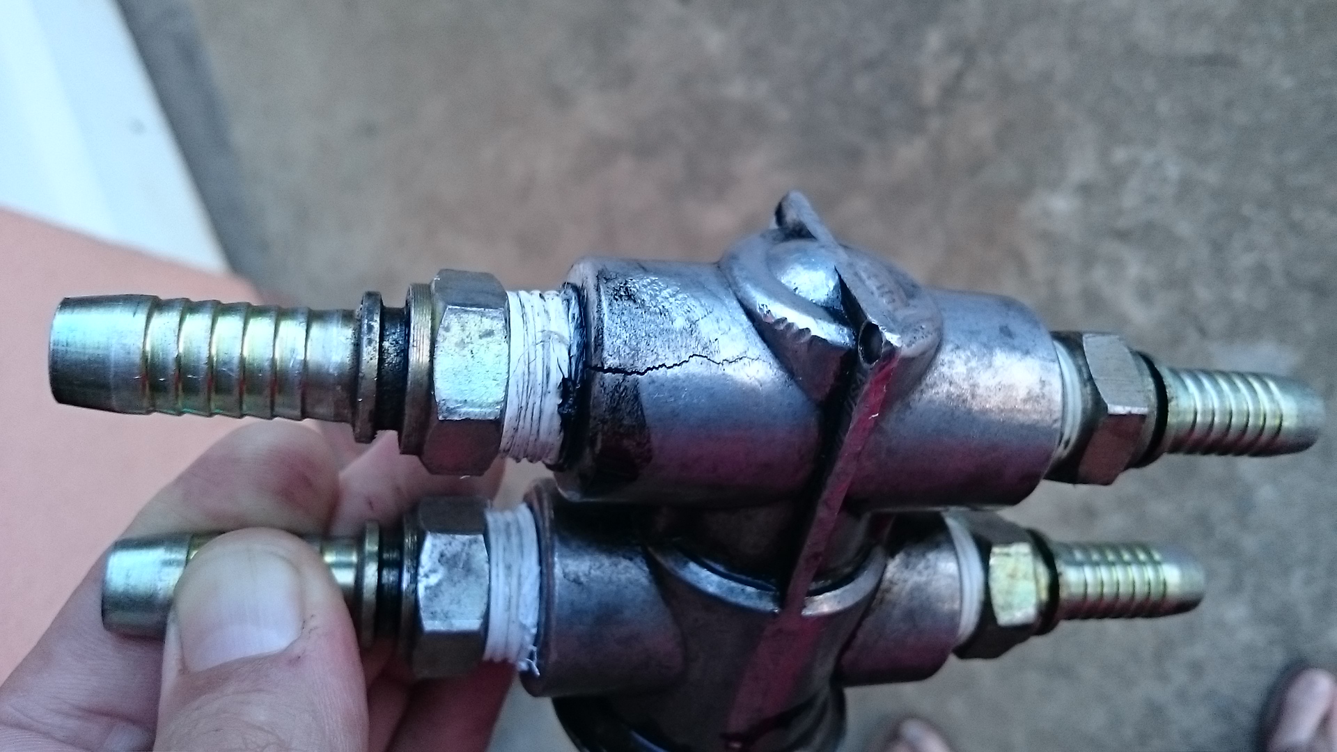

My external oil cooling setup also has a pressure or temperature regulator that sits between the oil radiator and the adapter plate. This was my next step. I started to screw in the brass fittings again with some PTFE tape, I tightened then with a spanner whilst holding the regulator in my other hand wedging it on the ground to tighten it up perfectly ( I hate oil leaks !!!)...... then I hear the delicate "cluck" sound !!!! :surprised: :surprised: :surprised: ..... I cracked the regulator housing !!!! The crack can be clearly seen, and I'm not amused. I used a few foul words and a bit of sign language and decided to bypass this regulator temporarily till I got a new one.

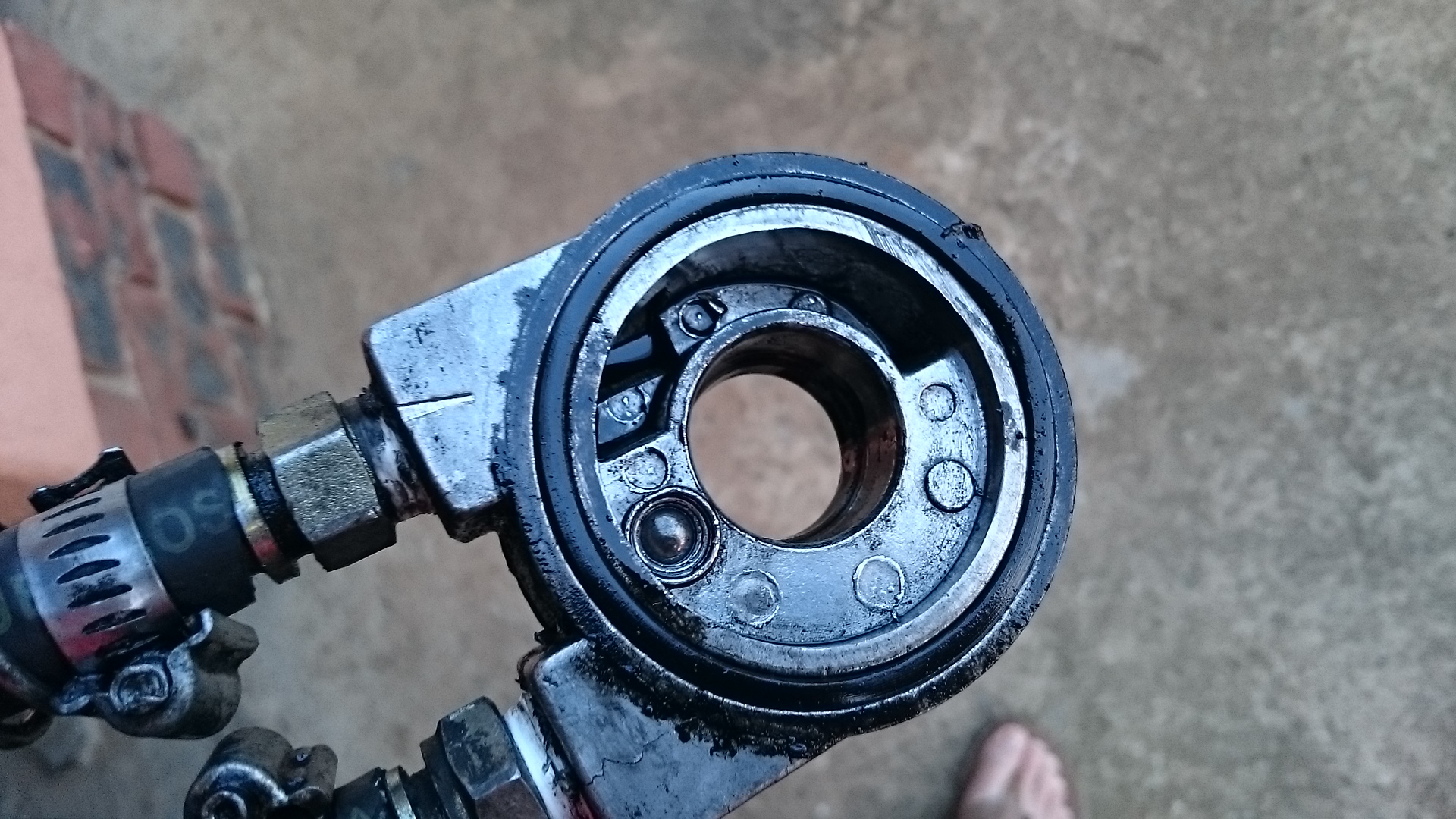

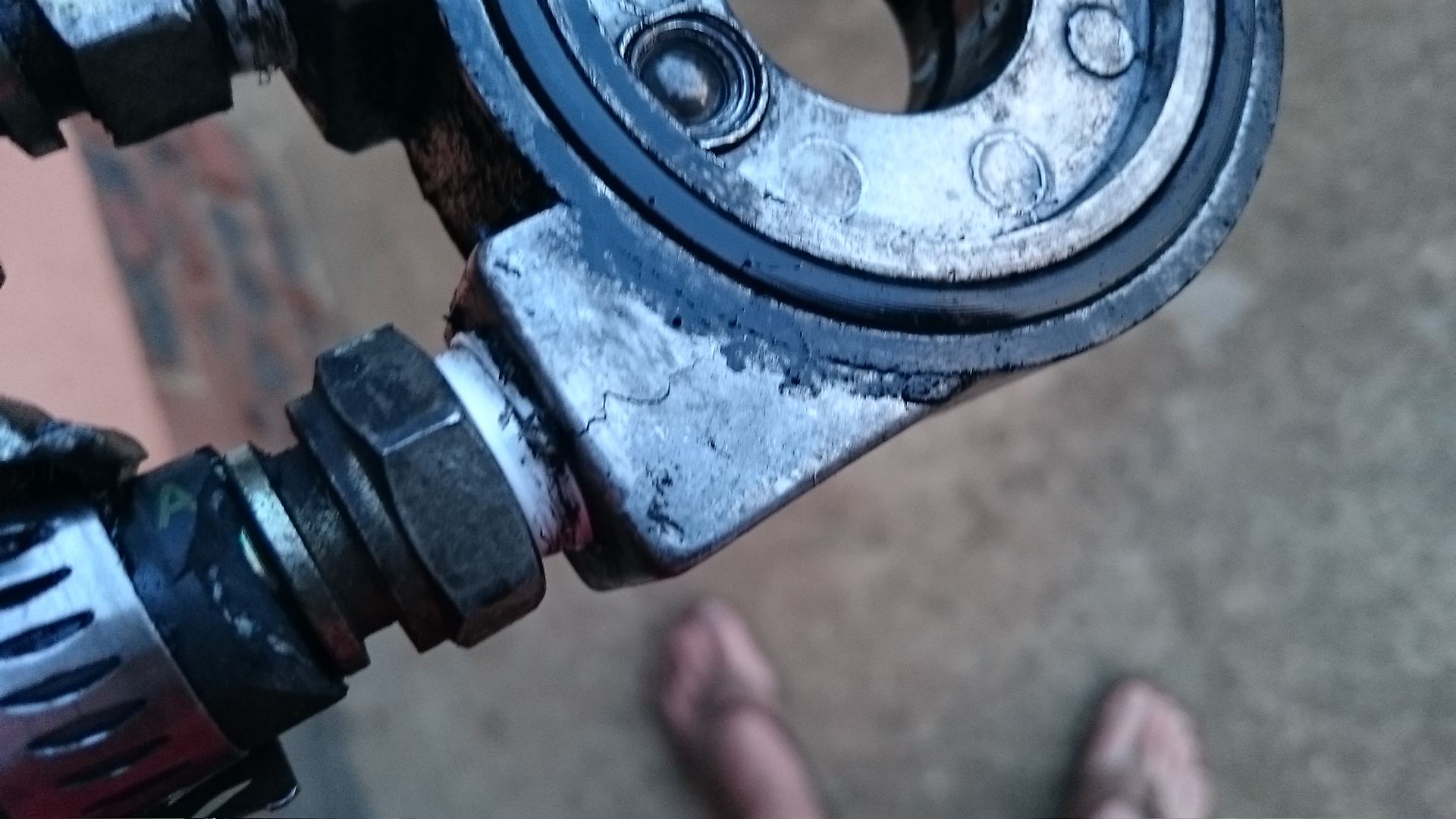

I then proceeded to fit the brass fittings to the adapter plate, again with some PTFE tape. I fitted to one fitting..... on problem, I then tightened up the second fitting ( with PTFE tape ) the same way I tightened the regulator, and guess what .... I cracked the adapter plate too !!! :surprised: :surprised: I now used the whole friggin alphabet of swear words that I knew, not to mention a few hand signs too. I mean what the hell just happened !!!!

these are the @#*%&#@ cracks...
the regulator
the regulator
the crack on the regulator
The adapter plate
The adapter plate
The crack
The crack

Cedric ptfe makes up space so the thread is much thicker after you apply it .....what works well is to apply it against the tread with a taper towards the end....so you only tighten till its enough. ...mabe look on mr turbo website .....Michael gets his stuff from them ....also i saw he uses a volwagen gasket maker
that replace gaskets that might do the job better....wouldn't try pach it you might lose a lot of oil very quickly when you are on the road :mytwocents:

I realize the PTFE tape will thicken the threads, but for me to manage to crack the metal tightening it "by hand".... damn I'm flipping superman.... :lol: :lol: :lol:
I just wanted it to seat perfectly even when hot so I wanted it to be tight.

Considering the damage you could do to your engine if the item fails and the fact that it is obviously weakened somehow, I would definately replace. Doesn't need to be done right now, as the oil cooler should only be necessary when working pretty hard.
I have never seen one of those regulator jobs, but the sandwhich fitting should be available from any half-decent motor racing shop. Maybe try ATS?
When putting everything back together, clean it all really well, doing the final clean with an oil-less substance (eg. thinners, benzine or carb cleaner), then use Loctite or that red pipe sealant they sell at the hardware shops rather than PTFE tape.
I know it's rather exensive, but I would strongly recommend replacing the hoses with Aeroquip (or similar) braided steel hoses. The best guy to get them from used to be Mike Bond, but I don't have contact details. So ask at that same racing shop.
If one of these hoses pop off while you are driving on the freeway, your engine could seize before you have time to do anything about it!

Luckily the adapter plate is fixed to the existing thread that the oil filter fits onto by means of another threaded fitting that fastens onto the engines thread, holding the adapter in place, and then has the same thread for the filter to screw onto that again, so all is well for the next 5000Km till the next service and then I'll fit the new adapter plate and regulator.
