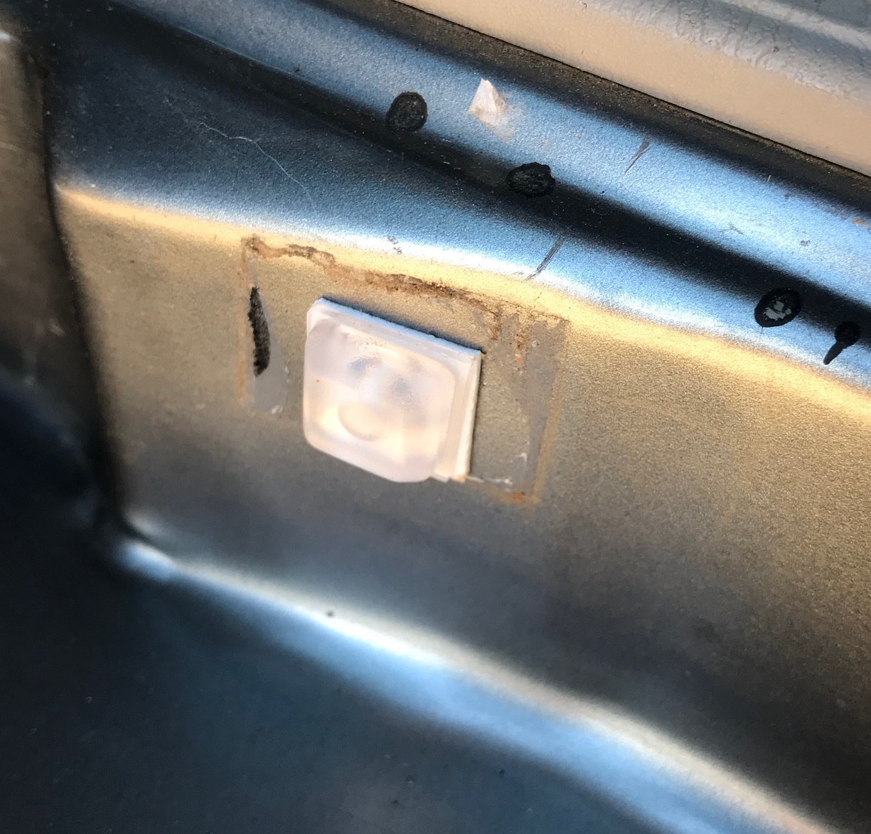

A finally had enough of the flickering warning light and decided to sort it out for good. Previously I kept putting new foam pieces on but they are too soft and compress eventually.
I found these little goodies at a local hardware. They are hard and I think ideal. So far no flickering light even on the farm roads. The thickness seems perfect for the switch to operate fully.

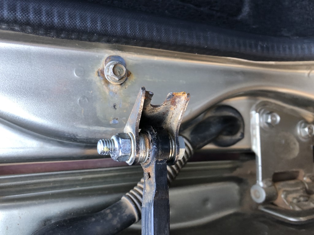

Re: Open door warning light?
Just and update, in my case not electrical but wear and tear ... root cause attached... Problem sorted.
