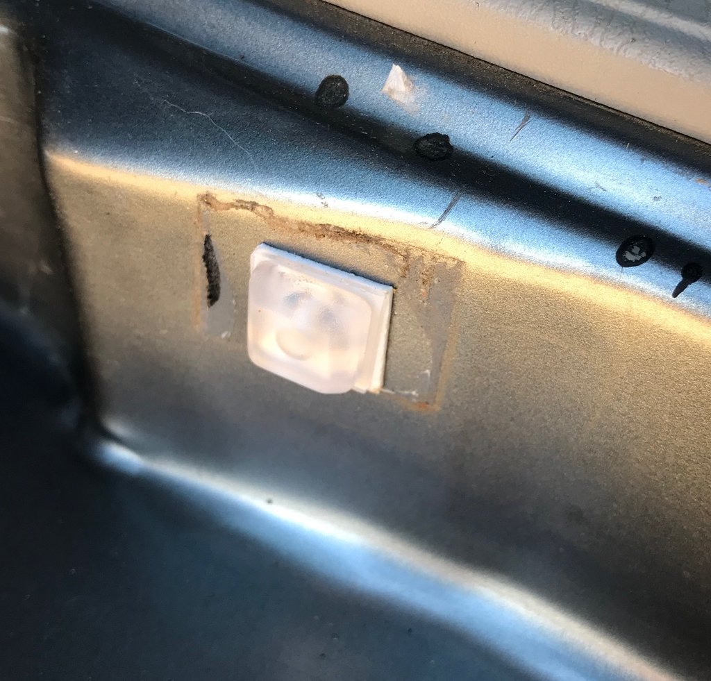

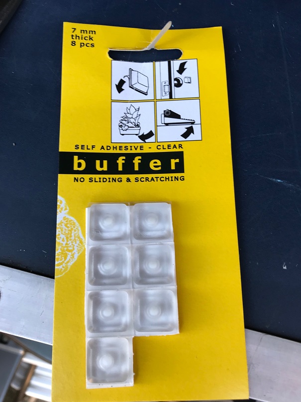

Re: Open door warning light?
A finally had enough of the flickering warning light and decided to sort it out for good. Previously I kept putting new foam pieces on but they are too soft and compress eventually.
I found these little goodies at a local hardware. They are hard and I think ideal. So far no flickering light even on the farm roads. The thickness seems perfect for the switch to operate fully.
Rhett
Nissan Patrol 4.8 GRX
Toyota Land Cruiser HJ45

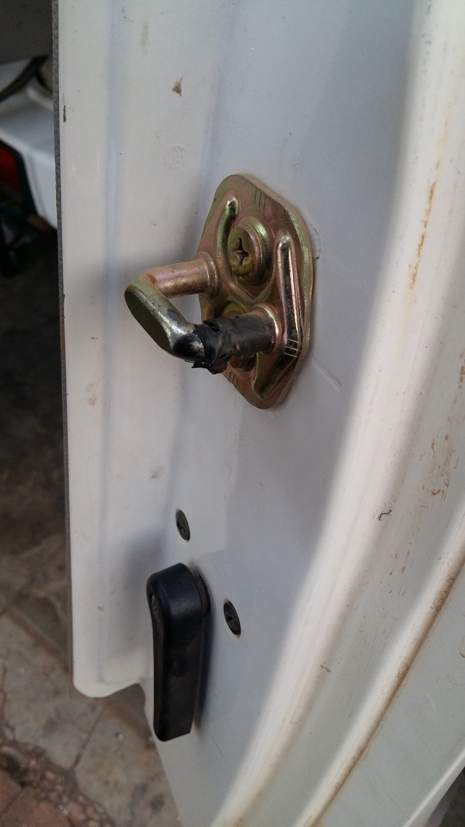

My Patrol is now 10 y.o. and starting to have the same issue (actually a few other electrical issues as well), but I guess that will happen with all the shaking over the years. I can, however, also feel the rear, left barn door not closing properly ... will keep you updated. Thank you for the solutions above.
- JohnBoyZA
- Site Admin
- Posts: 1339
- Joined: 02 Apr 2009 14:34
- Full Name: John Murray
- Nickname: John Boy
- Home Town: Bloubergstrand
- Current 4x4: Patrol GRX 4.8
- Has thanked: 1046 times
- Been thanked: 231 times
Just and update, in my case not electrical but wear and tear ... root cause attached... Problem sorted.
- IMG_0053 (Medium).jpeg (168.77 KiB) Viewed 5859 times
OUCH!
