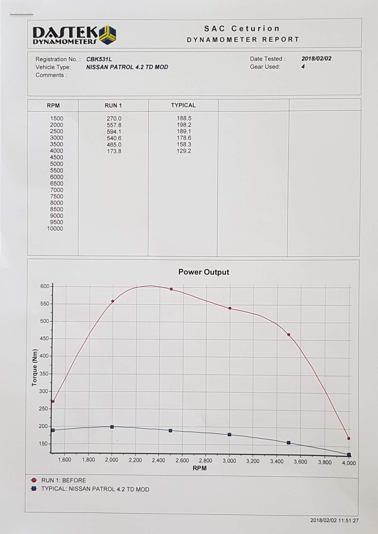

Re: Torque curves
Peter, al wat ek huidiglik kan kry is n kombenasie van n NA dyno grafiek met n ander voertuig se krag bo hom.
Die blou lyn is n NA TD42

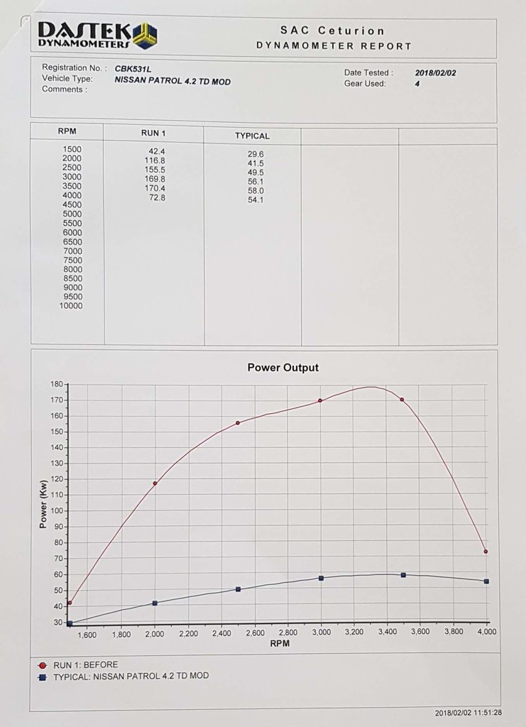

Re: Torque curves
Hi Peter,
Unfortunately my figures are not for an unmodified Patrol.
Herewith my 3.0Di (2008) pre CRDi motor's torque figures as at Jan 2018.
75mm exhaust,
300 x 600 front mount intercooler,
Madman,
SAC Chip
(at that stage with 265/70 x 17 tyres - 32's) - Tyre size makes a huge difference on torque figures.
This was after new injectors were fitted in November and a turbo recon done in April 2017.
After the above mods, these are my torque figures
RPM - BEFORE - AFTER
1500 - 192.3 - 306.3 NM
2000 - 293.2 - 362.0 NM
2500 - 277.0 - 342.7 NM
3000 - 245.8 - 300.3 NM
3500 - 235.0 - 267.7 NM
4000 - 185.3 - 205.8 NM
75mm exhaust,
Madman,
SAC Chip
- Posts: 6168
- Has thanked: 1141 times
- Been thanked: 1049 times
Re: Torque curves
Pretty impressive Malcolm. Are those corrected for friction (ie estimated flywheel figures)?
