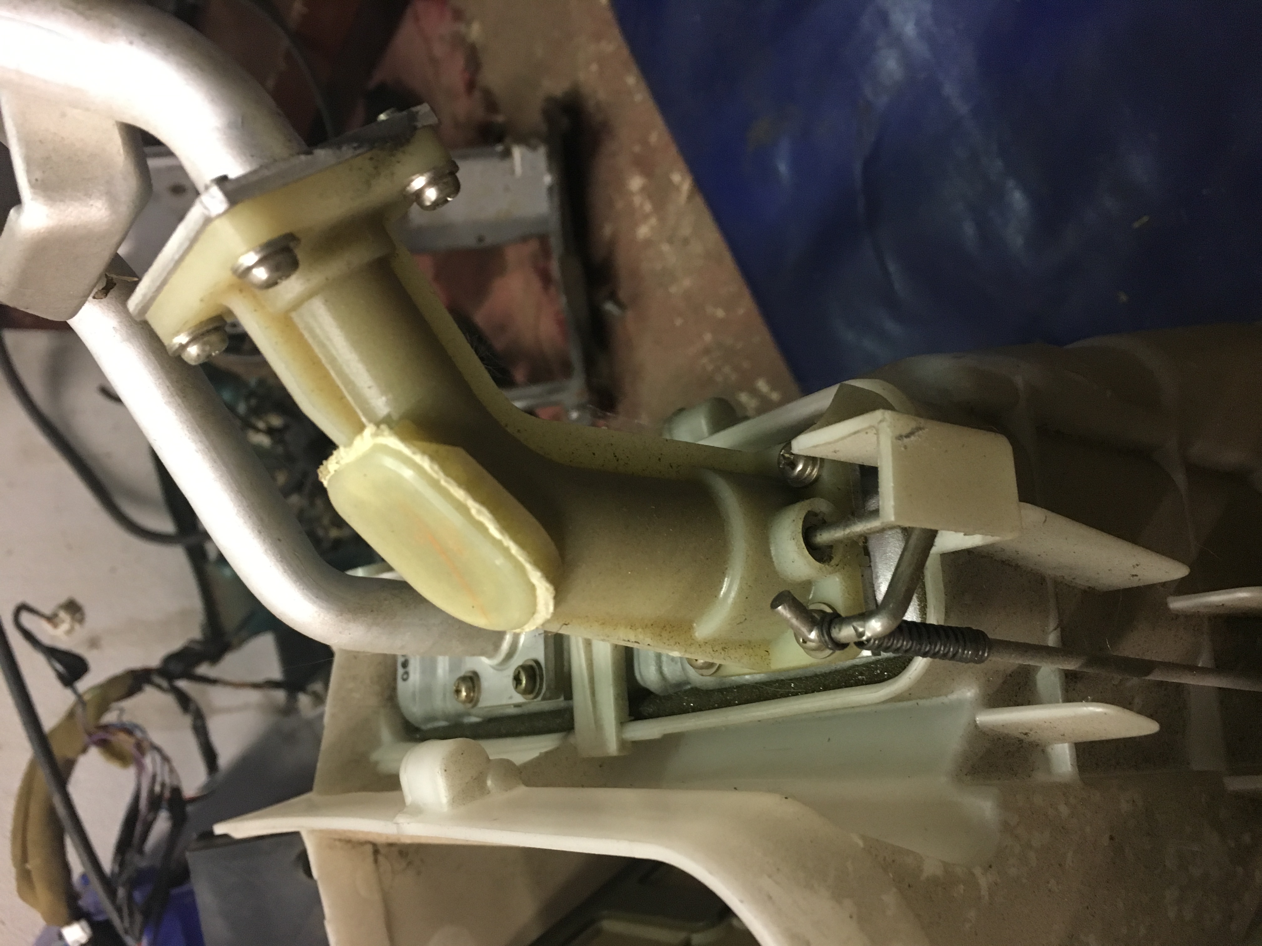

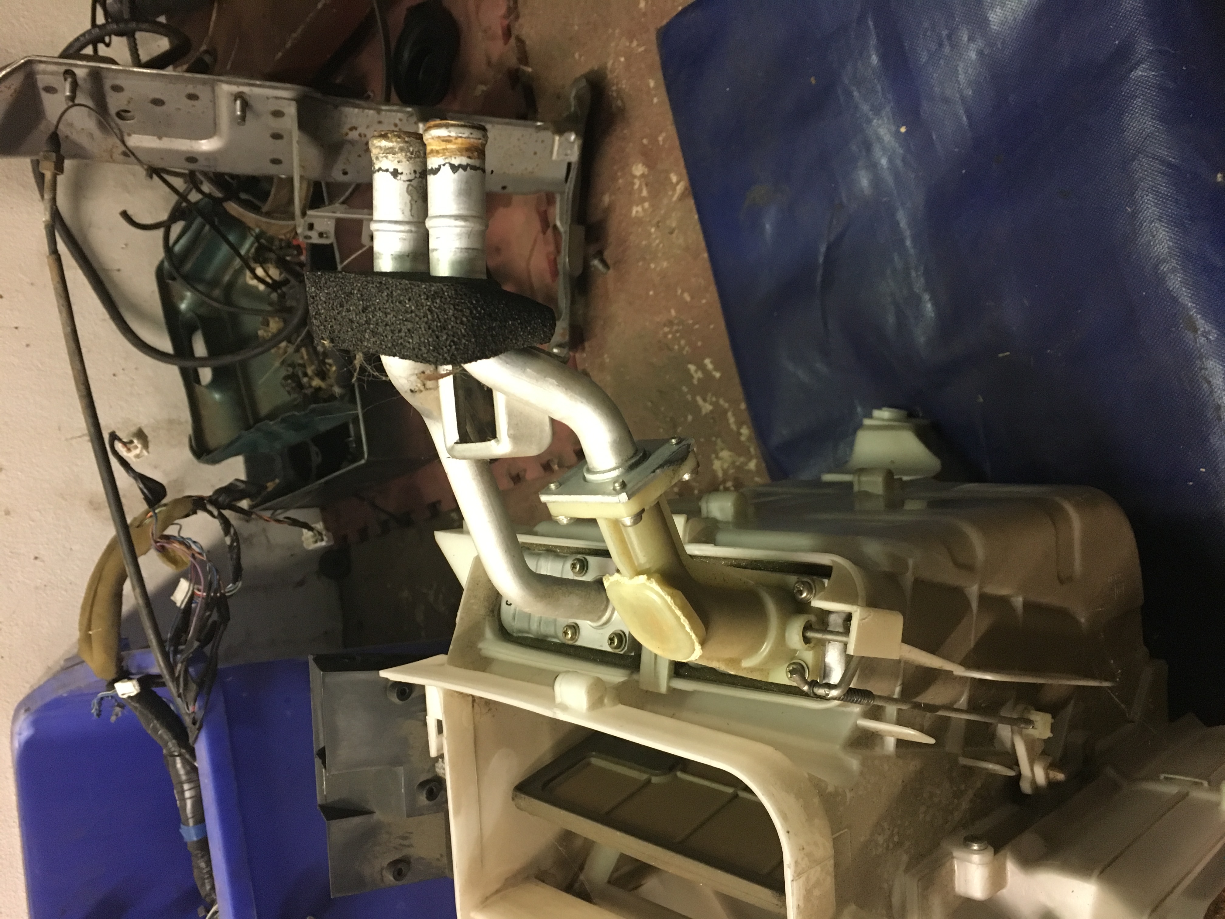

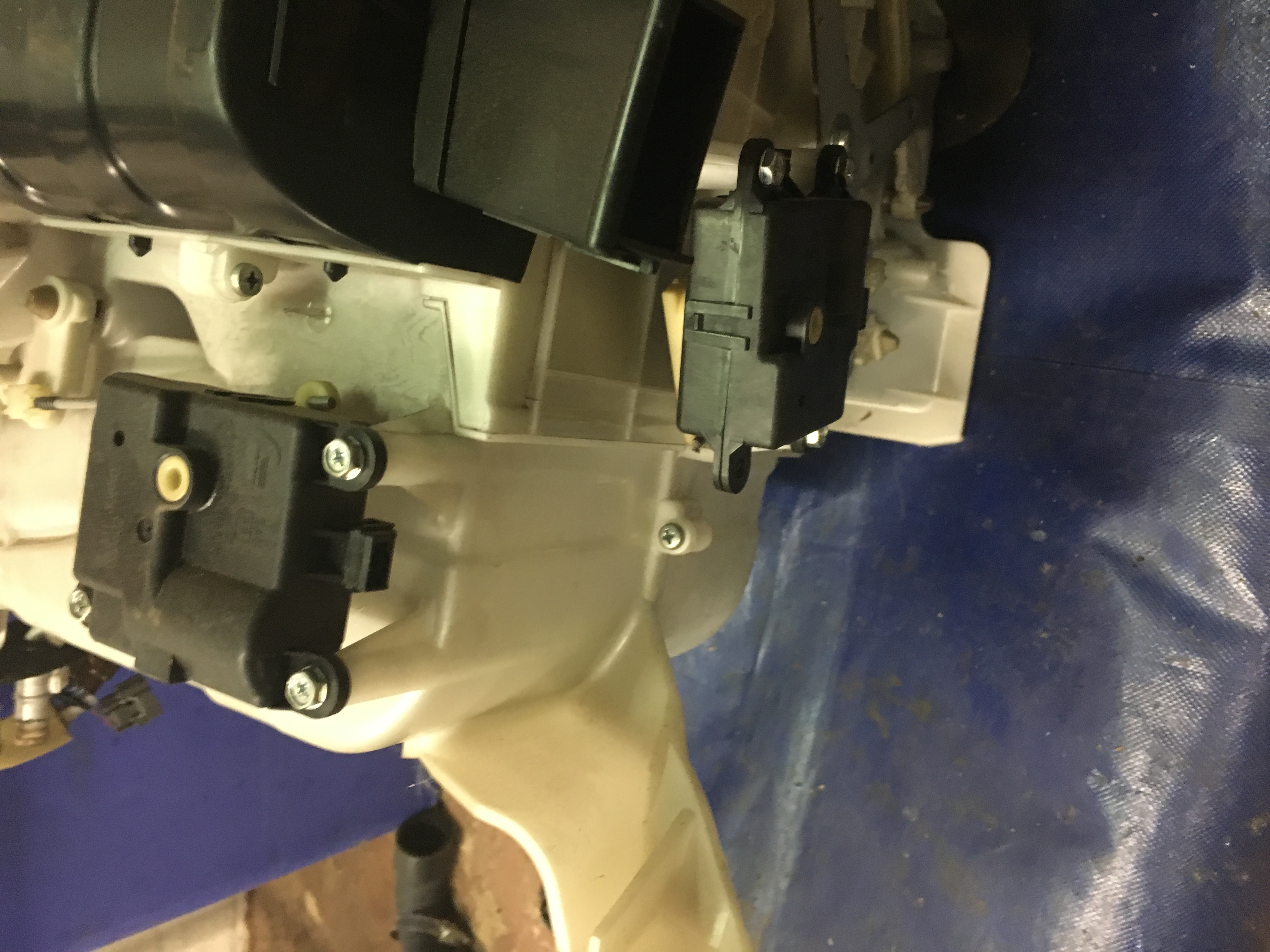

Chris here is foto,s of where to look if you didn't come right

Sorry I do not have any diagram but can remember it was easy to find. Could be one of the black boxes if I remember correctly. Open them and look inside, you will spot the popped heat fuse.
