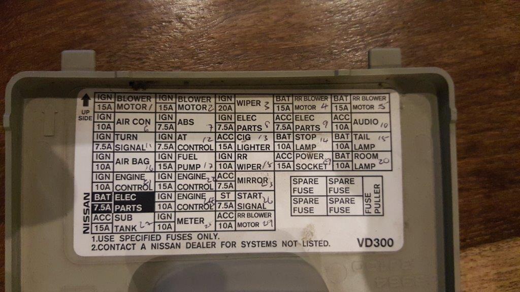

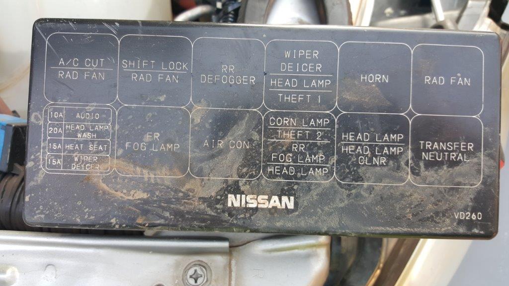

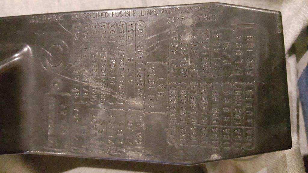

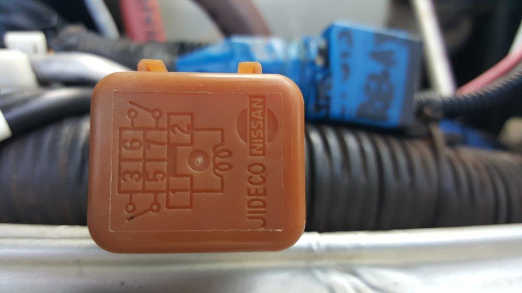

Peter - I checked fuses, don't see any blown but also not exactly sure which ones control the heater servos etc... see pics ?? I also don't know how to check the relays.
Michael - how easy to locate and check the cable you mentioned (not sure if 4.8 has such cable - it seems to all electronic??
