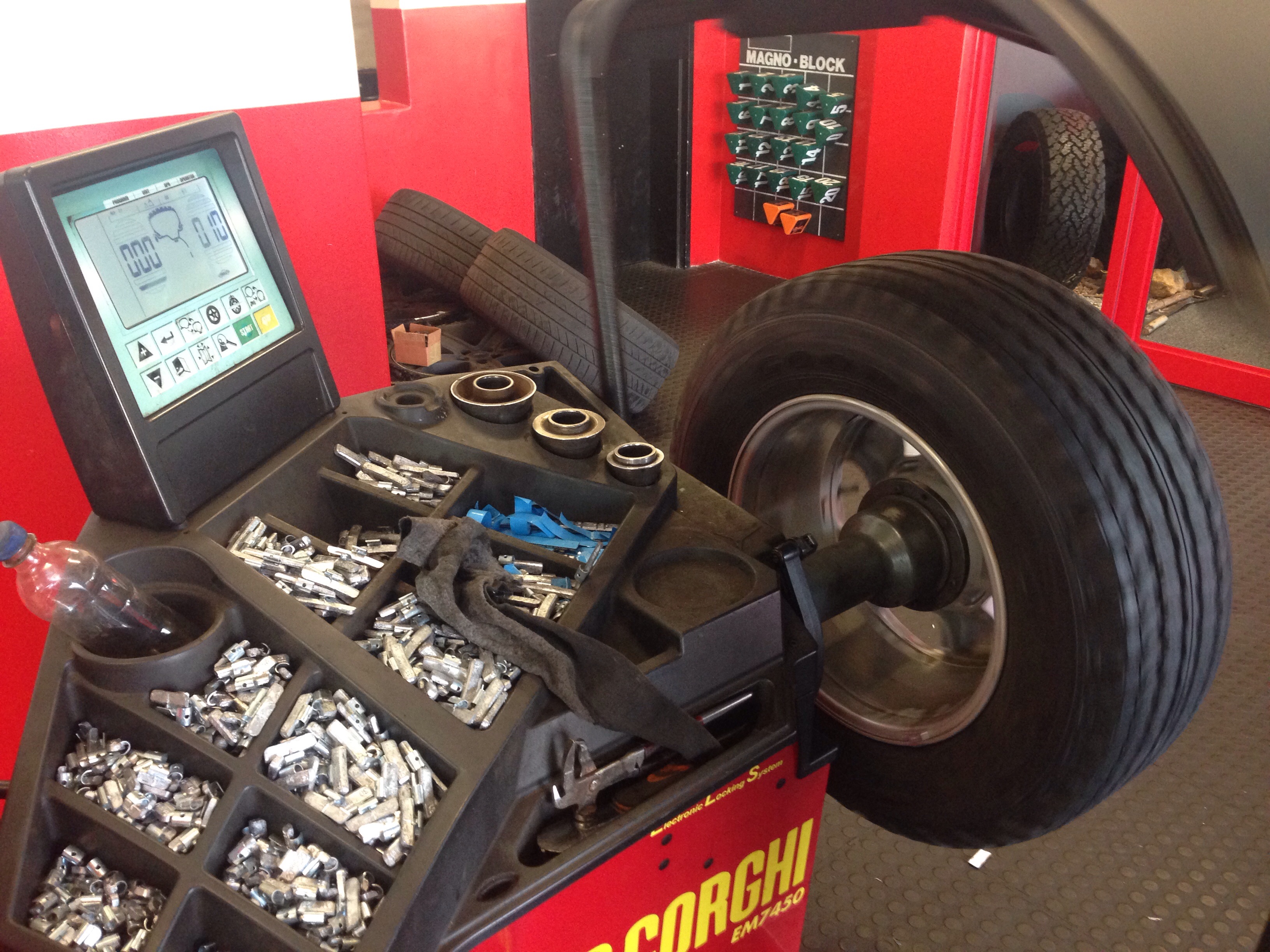

So I went back to TWT for the third time to redo the wheel balancing.
As they checked each wheel I was watching like a hawk.
All 4 wheels where out of balance which I cant understand as they balanced them last week in front of me and in that time I had not gone off road just highway driving. :think:
One of the tyres was found to be faulty, they say it had tyre hop, you could see the tyre running uneven on the balancing machine so we swapped it out with the new spare wheel.
I took it for a test drive and it was perfect , no wobble or shakes etc so very happy. :woo:
They said I must return the tyres for a replacement from Goodyear as its a manufacturing fault as the tyre only has 5000km on it. :thumbdown:
