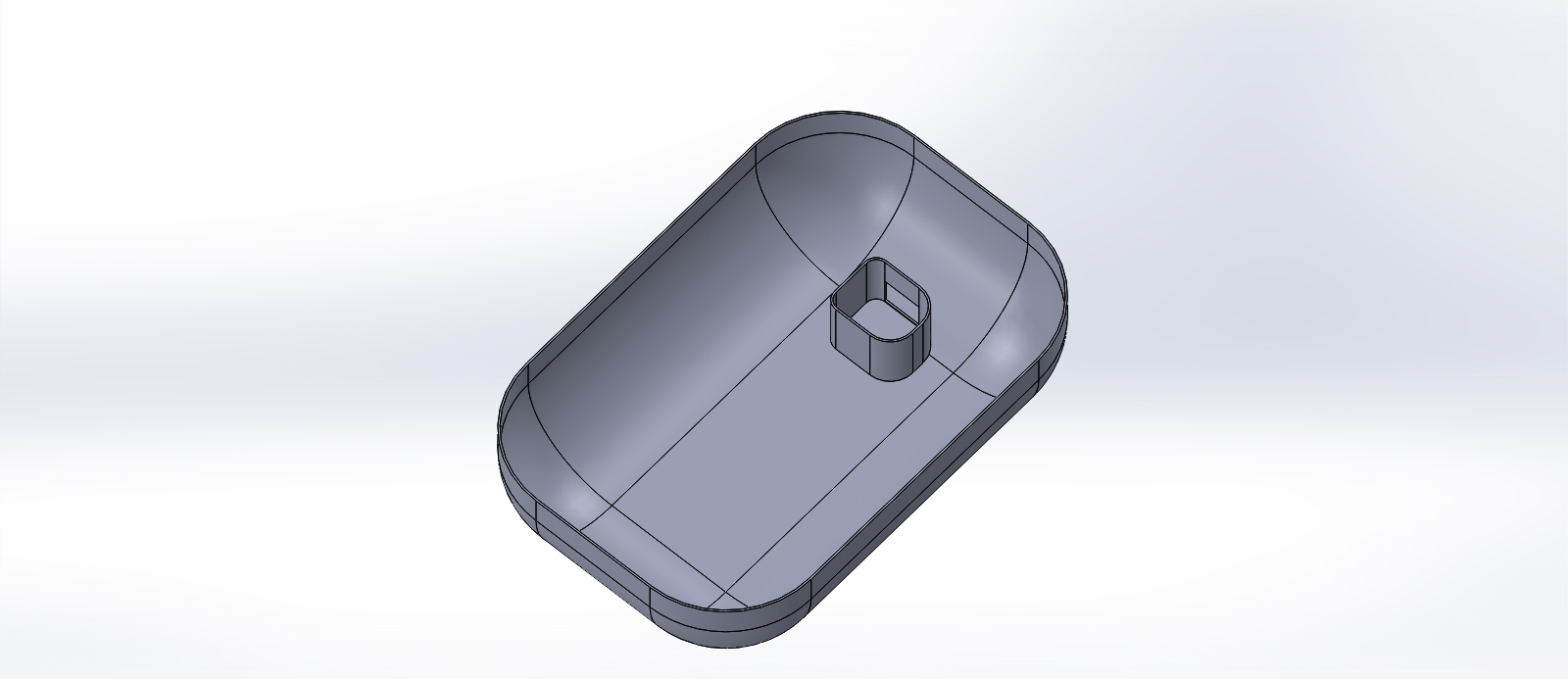

The drawing is very simplified, but the petrol pump sits in a bit of a bowl on the right hand side of the tank. This assist when you drive up hills. When you stopped, the little bowl was emptied and the engine stopped due to fuel starvation.
Petrol Tank.JPG (152.17 KiB) Viewed 3707 times
