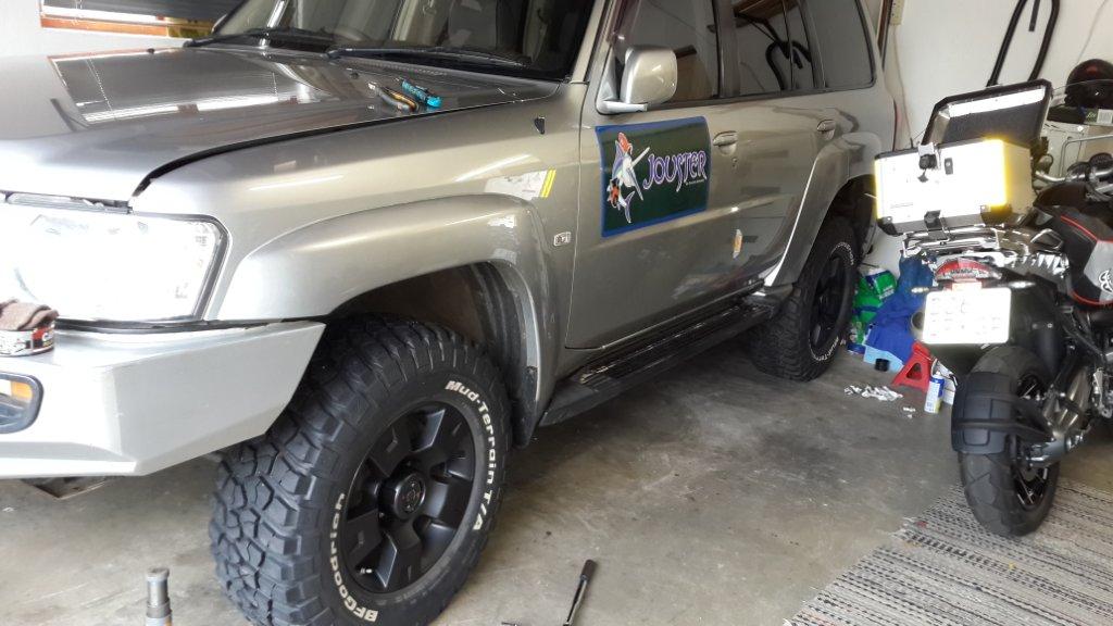

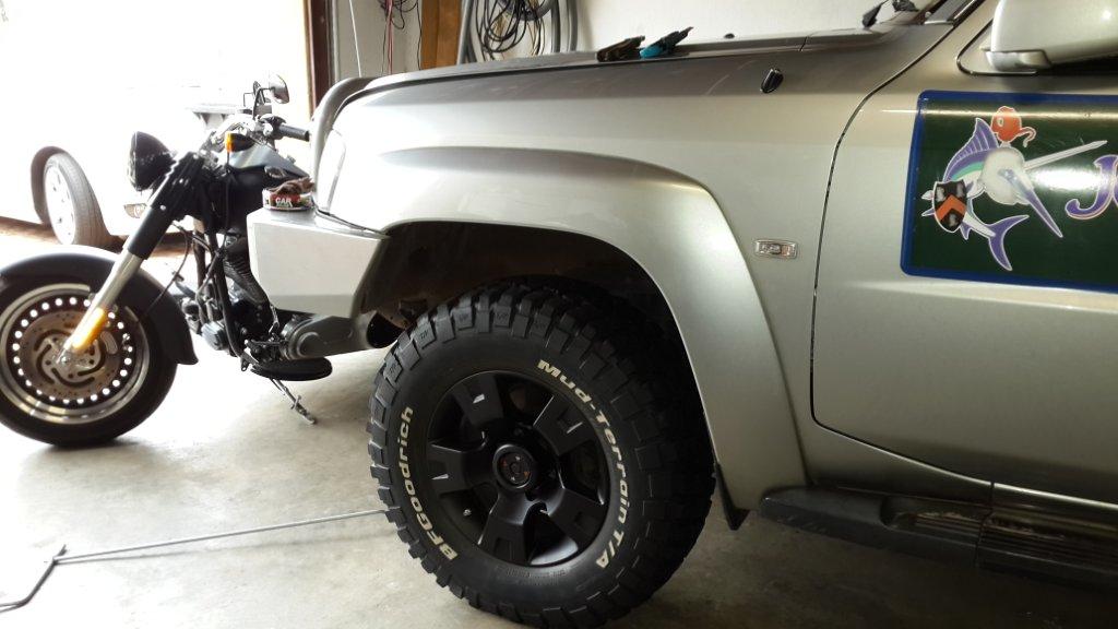

Right - 5 rims done.
I my view it looks seriously cool.
used 4 tins of matt black plastidip.
Very easy to do - just clean well, put some playing cards between rim and tyre and away you go. First layer must be very light. Do at least 5 or 6 layers, dont let it run.

I used 4 tins for 5 rims!
Obviously the more layers you do the easier it is to remove eventually by peeling it off - Frik advised one tin per rim though, but I only bought 4 initially. I managed around 5 layers which should be okay.
