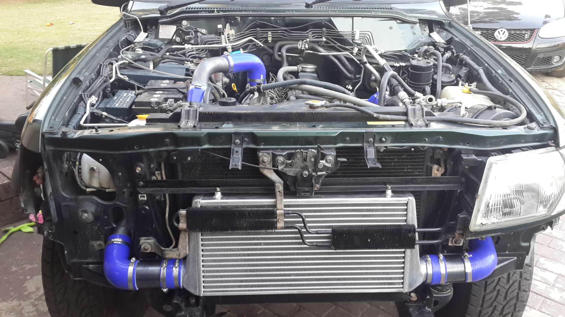

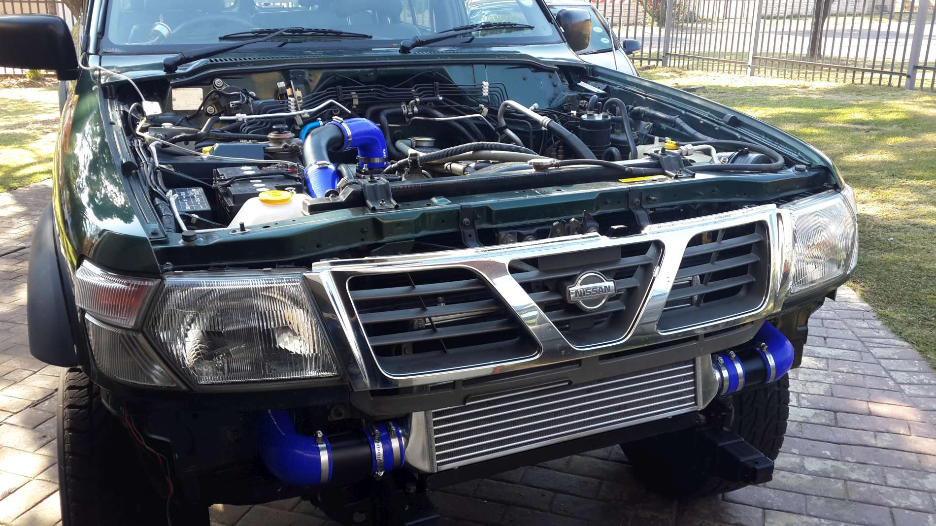

Ek gaan ook maar my opinie gee oor die top mount vs front mount intercoolers
Ek is maar n voorstaander van die front mount cooler, dit het nou wel sy negatiewe eienskappe soos die turbo lag maar op n 4.2 diesel gaan jy nie drag strip toe nie en om eerlik te wees...... die lag is nie eers merkbaar as ek op die highway is nie.
Die voordeel van die front mount cooler vir my is dat ek n baie groter cooler kan op sit as wat mens onder die bonnet kan in kry.
Tweedens verkoel hy BAIE beter op die oop pad en dit is wat ek wil he....veral op n warm dag as jy dalk iets sleep of swaar gelaai is.
Ek sal graag na die dyno tune my EGT wil vergelyk met die ander manne sin...
Hier is n foto van hoe myne uit gedraai het, dis n baie groot cooler wat nie almal sal goed keur nie, maar ek dink hy is perfek!!

Re: Intercooler
I agree with you, the top mount is a bit of a pain when it comes to heat soak. this is VERY evident in slow driving and even though mine has been ceramic coated there is still a lot of heat soak that takes place. The fan underneath does help keep the IC cooler, but one cannot get away from it compared to a front mount IC. However..... the piping from the front mount IC runs very close to the exhaust manifold and the viscous fan generally will move the hot air from the radiator over these pipes. I would recommend insulating these pipes as much as possible too as the nice cool air will be warmed up from the steel piping leading from the IC to the turbo and from the turbo to the inlet manifold. The rear of ANY motor ( Firewall side) is the hottest area.
The IC I have on my TD42 is a big bugger, bigger than I've seen on other 4.2's, and I think on the highway the IC's on both top and front are probably ( IMO ) operating on a similar efficiency as the cool outside air passes over the bonnet into the IC scoop...... this is as long as you don't have a bullbar with the round tube bit running over the front of your bonnet to mess up this airflow. That's why my Iron Maiden has the extended scoop and fan fitted
- Been thanked: 432 times
Re: Intercooler
I agree Cedric, the heat soak is really a problem plus a full engine bay doesn't help either. I have tried to keep my engine bay as "original" as possible meaning I don't have an extra battery or any of that installed yet. This is just my opinion, but I think the less you have going on inside your engine bay the better the hot air can get out of there... I also agree that on the open road I think there will be very little difference between the top mount and front mount coolers.
I will do some proper testing once my dyno is done. For testing purposes I would like to install a air temp sensor on the last rubber section on the intake manifold just to see what the actual intake air temp is. I can actually just unscrew my EGT and install it there just for testing. I would like to do a comparison between normal town driving, highway driving and maybe some highway driving while towing something.
Re: Intercooler
Yeah.... that will be interesting readings !!!
