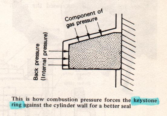

Regarding the pistons, I didn't use Nissan originals, but used "keystone" or " Alfin" ( i think that's what they were called ) pistons and rings. The rings have a bevel on the one side and the piston then matches the bevel. These were recommended to me by Tour de Frans ( the 4.2 diesel guru ), they were a fraction of the cost and apparently work better than original as the ring will squeeze tighter on the sleeve when under higher compression. Now I don't know if this will work on the ZD30, but cannot see why not as these pistons are made for turbo diesels.

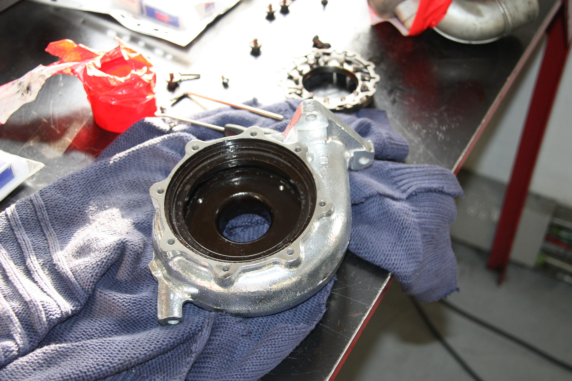

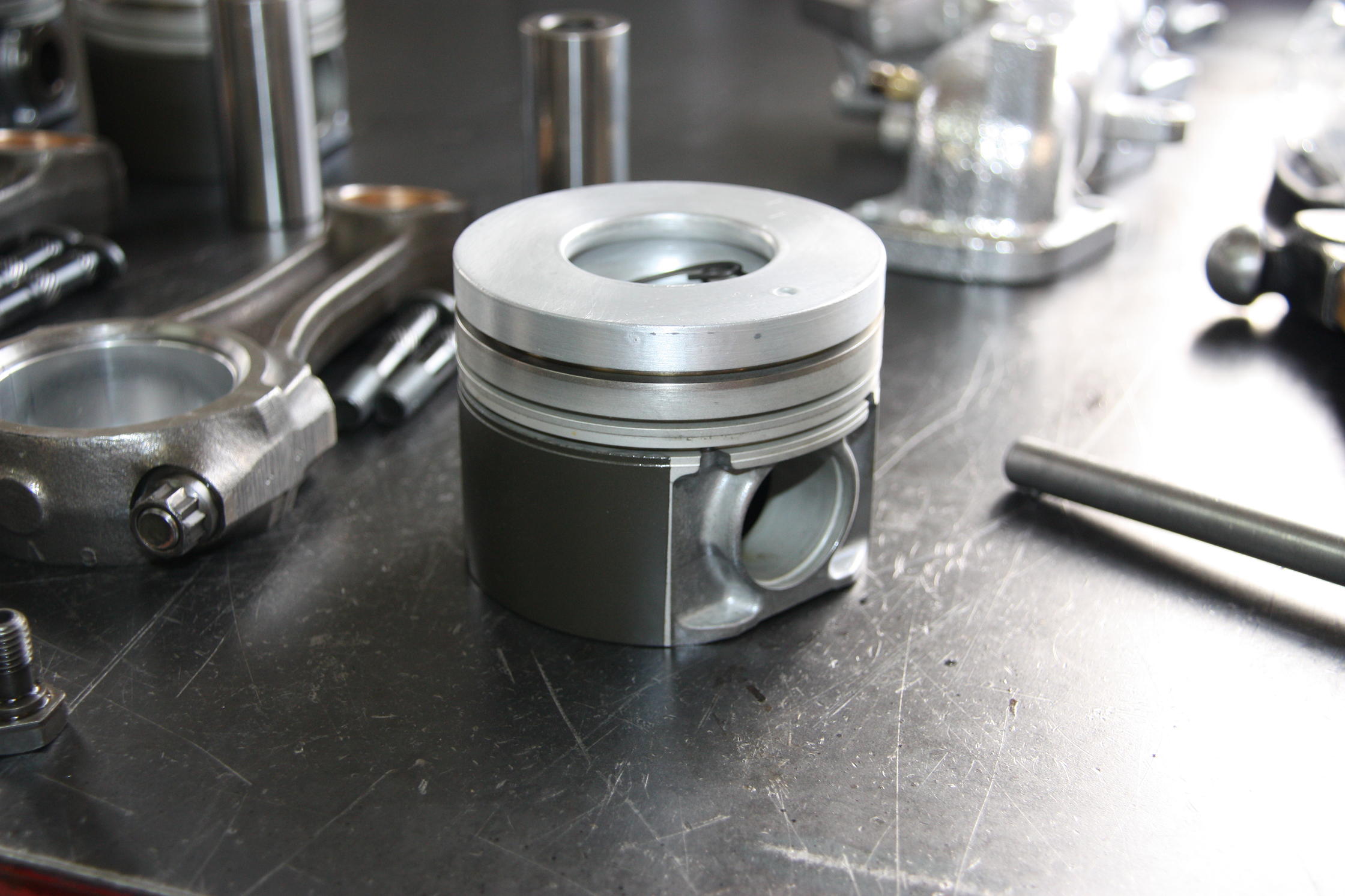

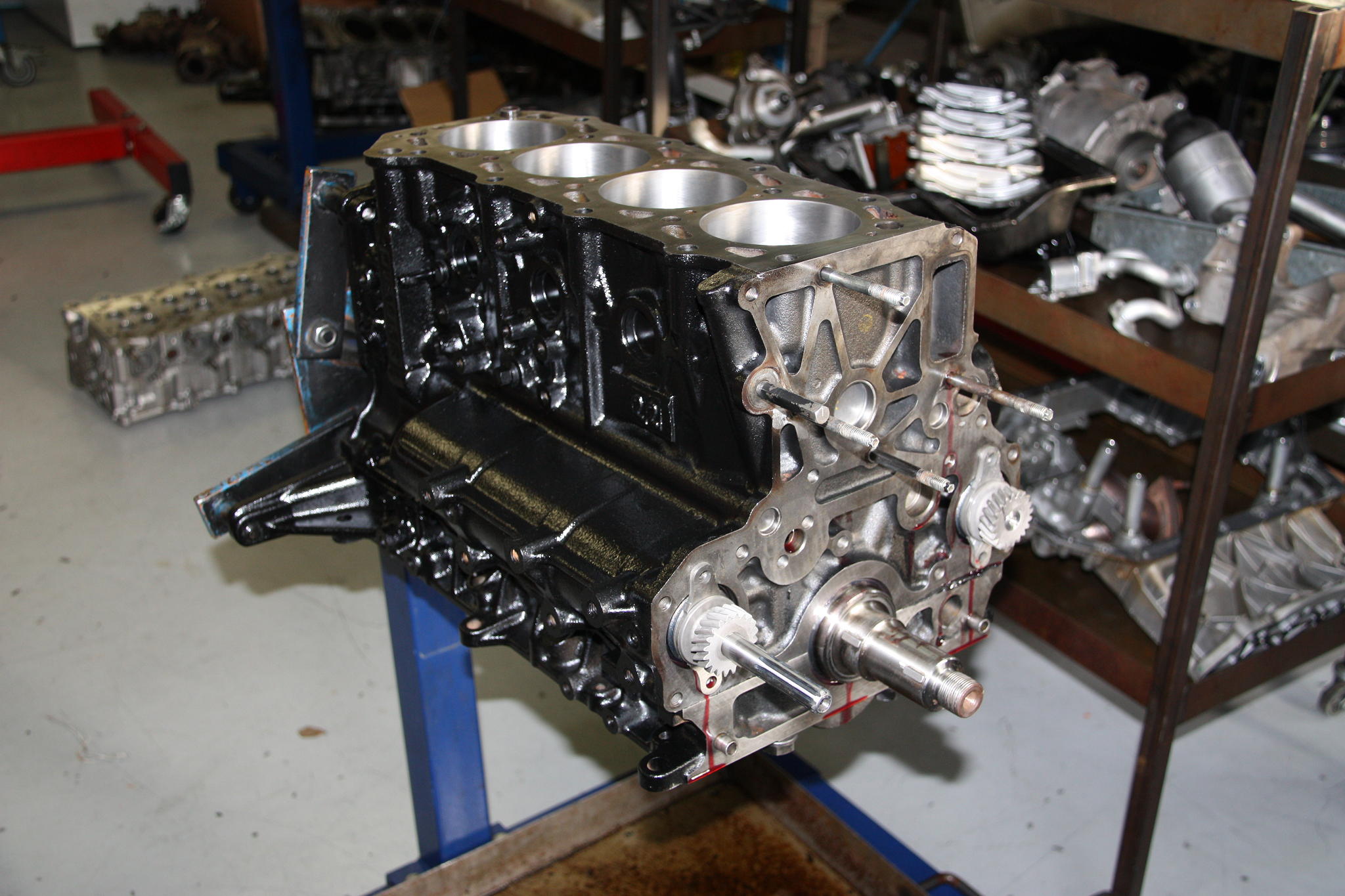

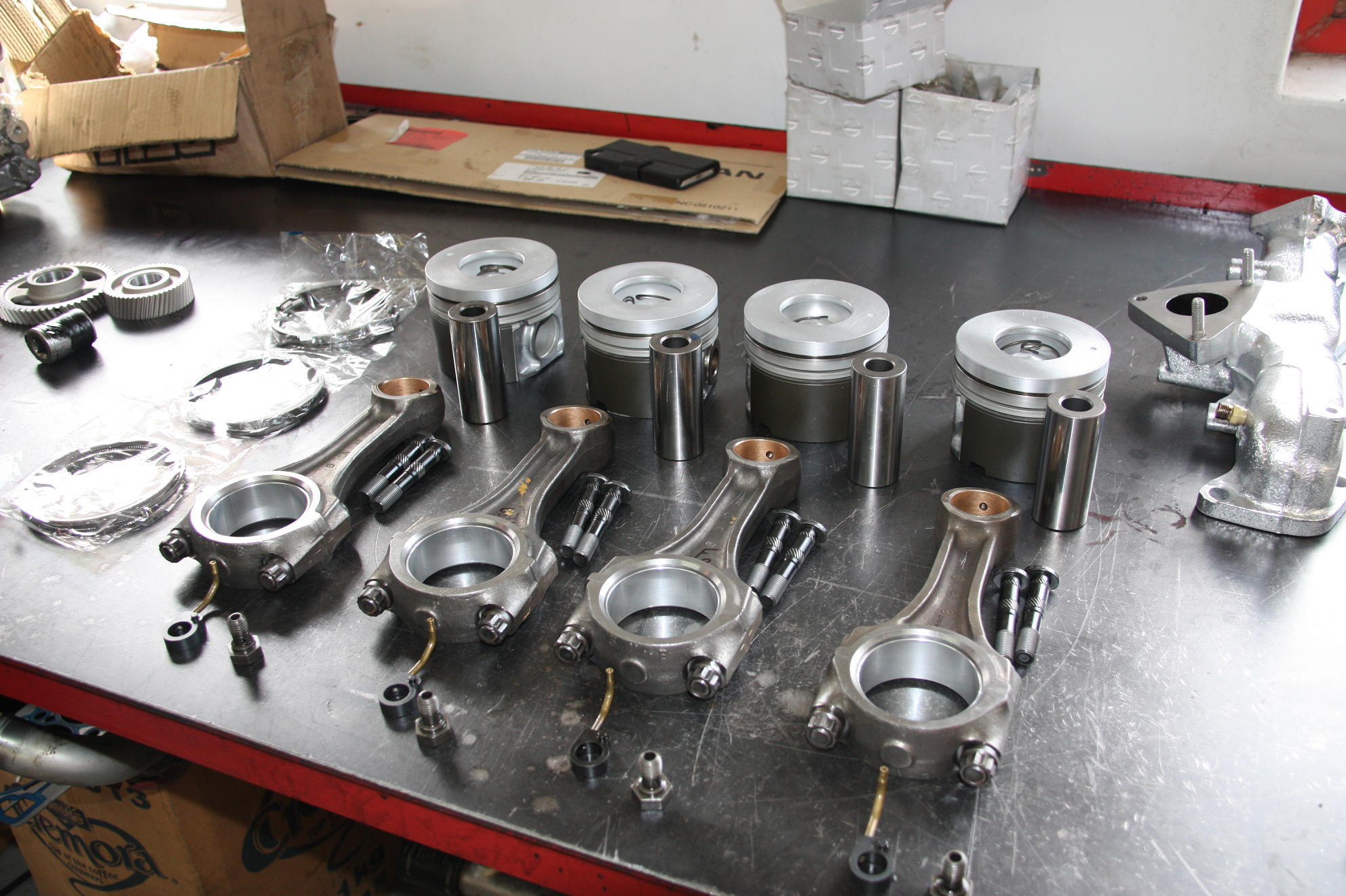

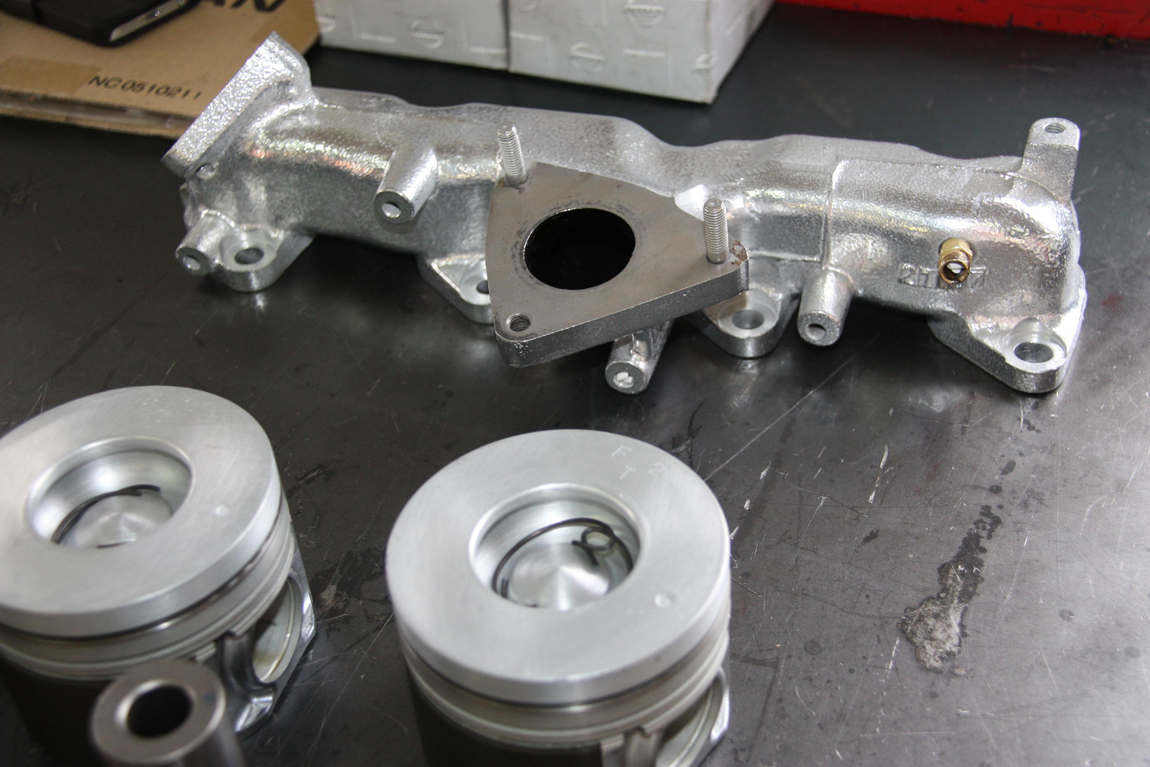

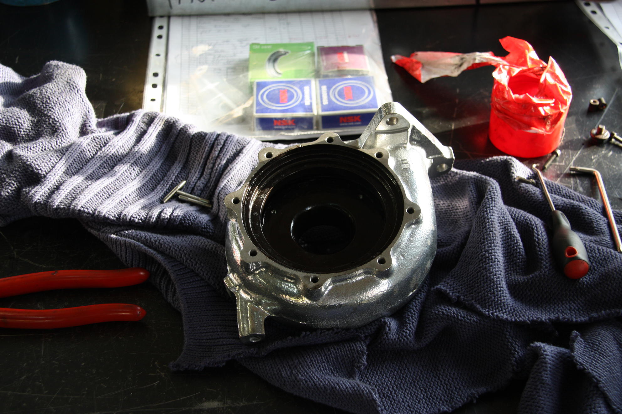

Ok, got the call today - everything has arrived except one gasket set. At least work can eventually begin! I popped past this evening to take some pics of the new parts:
The Cylinder Head was still wrapped up so I never took any pics of it.
Turbo inside coating (teflon) I think.
Turbo Ceramic coated (outside)
Pistons coated & ready to install.
Pistons - Ceramic tops & Teflon sides
Ceramic coated Exhaust Manifold
Rebored Engine Block
