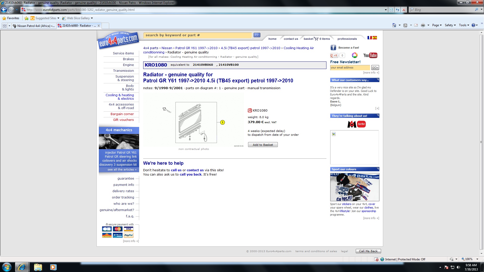

Johannes
Another option is Euro4x4parts.
The big problem is to get it to SA.
Patrol 4.5 GL 1998
Terrain 4X4 Parts
