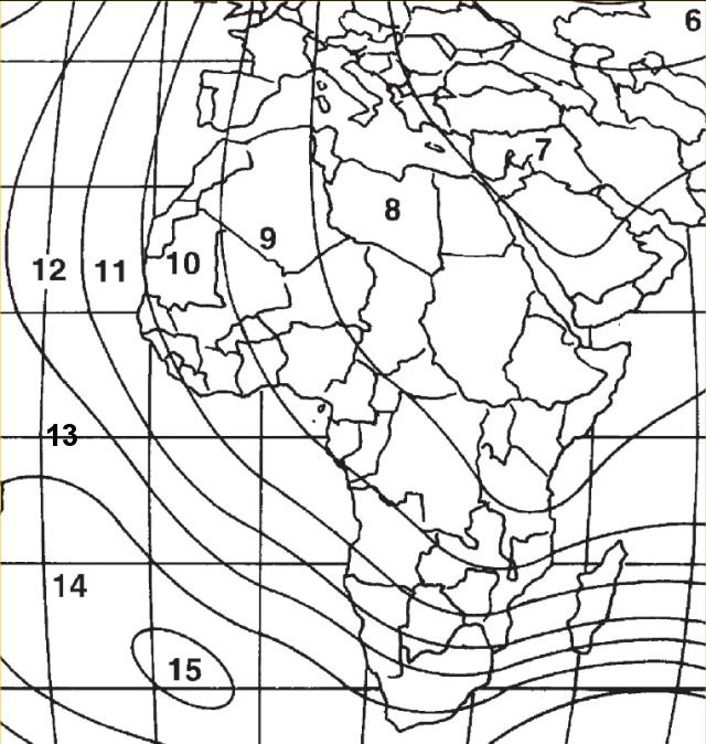

Dunno where you live, but South Africa falls between zones 11 and 14.
Press the Mode switch quickly to toggle between degrees F, degrees C and display off.
Press & hold the Mode switch for 5 seconds to enter zone calibration mode. Leave the switch for a while to accept the currently selected zone.
Compass zones
Compass zones
If it stil misbehaves after selecting the right zone, try perfroming an initial calibration. Press & hold the Mode switch for 10 seconds until the direction bar starts to blink, then drive vehicle slowly through two complete turns to perform initial calibration. In my case the initial calibration & blinking display ran for about a week, during which the compass spun around on its own mission! YMMV, as I did repeat the procedure a few times to try and force a calibration during that period...

Thanks Christo, a most informative reply :thumbup: live in Capetown so will check if it's set to that zone.
