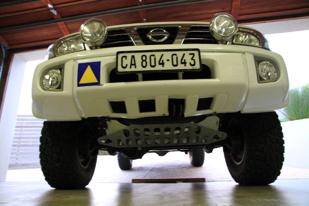

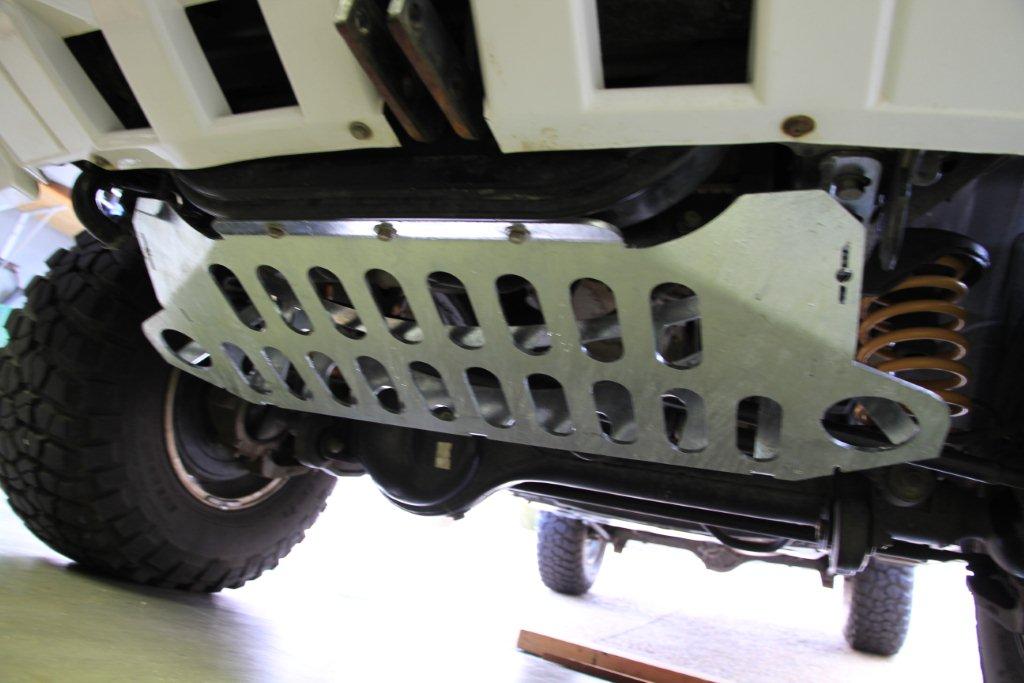

Re: Bash Plates
I did not like the way that the bashplate went so low near the ground (Not that it went any lower that the diff). Granted when I can afford a upgrade it would have been better and Peter planned the hight with my wish for a upgraded suspension in mind but still I did not like it and thus made some modifications.
Thanx Peter for all the help and advice.

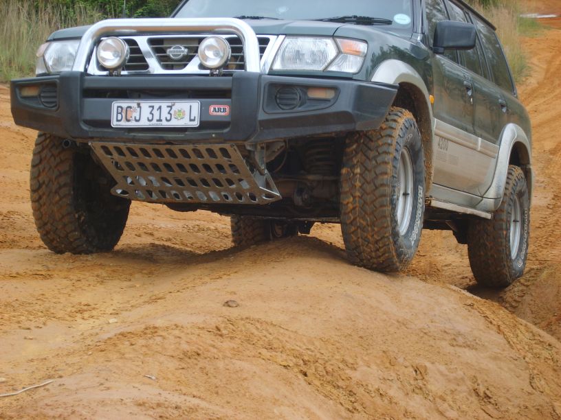

Re: Bash Plates
Hi All
At last i managed to get a picture of the Bash plate installed. A couple off us went out last weekend to Mahem and got this picture.

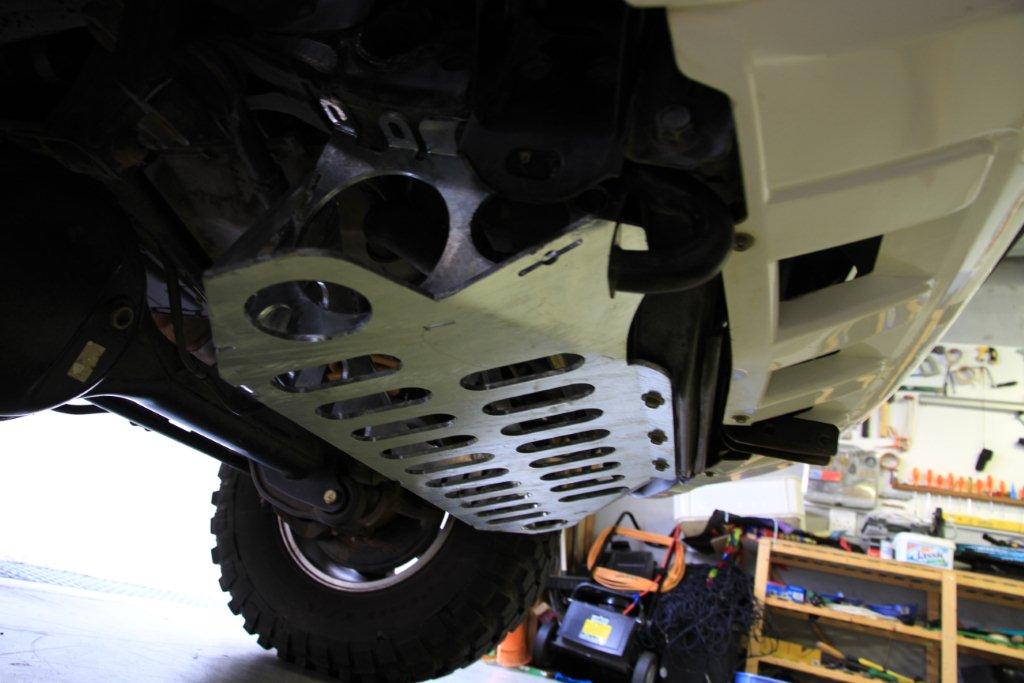

Re: Bash Plates
Bashplate fitted today after collecting from Stefan (thanks!). Just having a small problem with accessing the M14 bolt at the front of the right side recovery point which when fitted makes it very tight to get in there with a 19mm spanner but will try tighten some more in the morning, possibly may cut a little of the bash plate away to make more access for a socket but as is galv so am reluctant to cut...
Looks great on and feel I can now tackle some of the heavier rocky stuff with less chance of a ding ending my day out prematurely! Cheers Peter

Re: Bash Plates
I had the same problem but it helps if you loosen everything and just tap the bash plate slightly more to the right to create more space as it has a few millimeters playwanderer3 wrote:Bashplate fitted today after collecting from Stefan (thanks!). Just having a small problem with accessing the M14 bolt at the front of the right side recovery point which when fitted makes it very tight to get in there with a 19mm spanner ...
