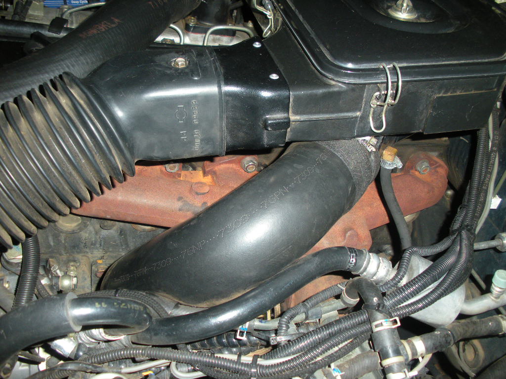

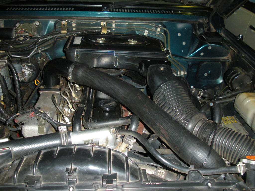

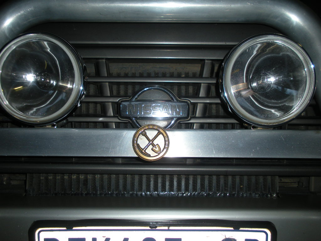

Hi Guys,
See pics of set up
Grant
See pics of set up
Grant
