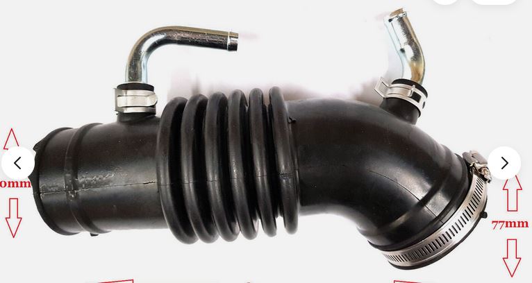

1. Is this an agent only part or available Aftermarket, Troll has been going really crap lately and today I discovered this pipe has a massive tear in it on the underside,like 5mm wide.
Intake hose.JPG (36.75 KiB) Viewed 233 times

Th pipe may be available from Partsouq (on the net)?
