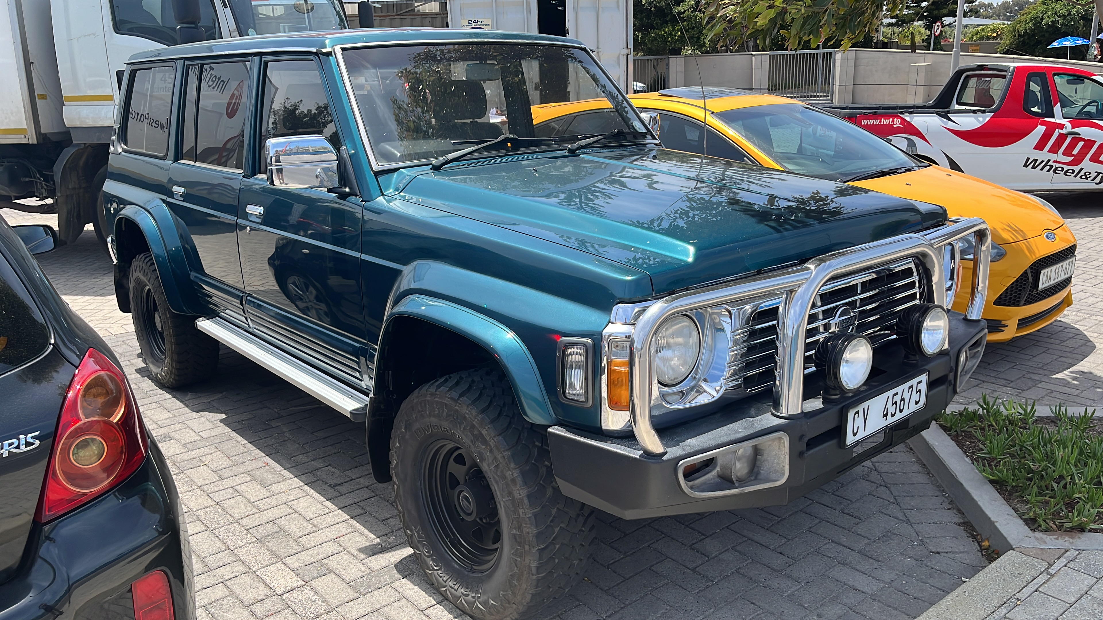

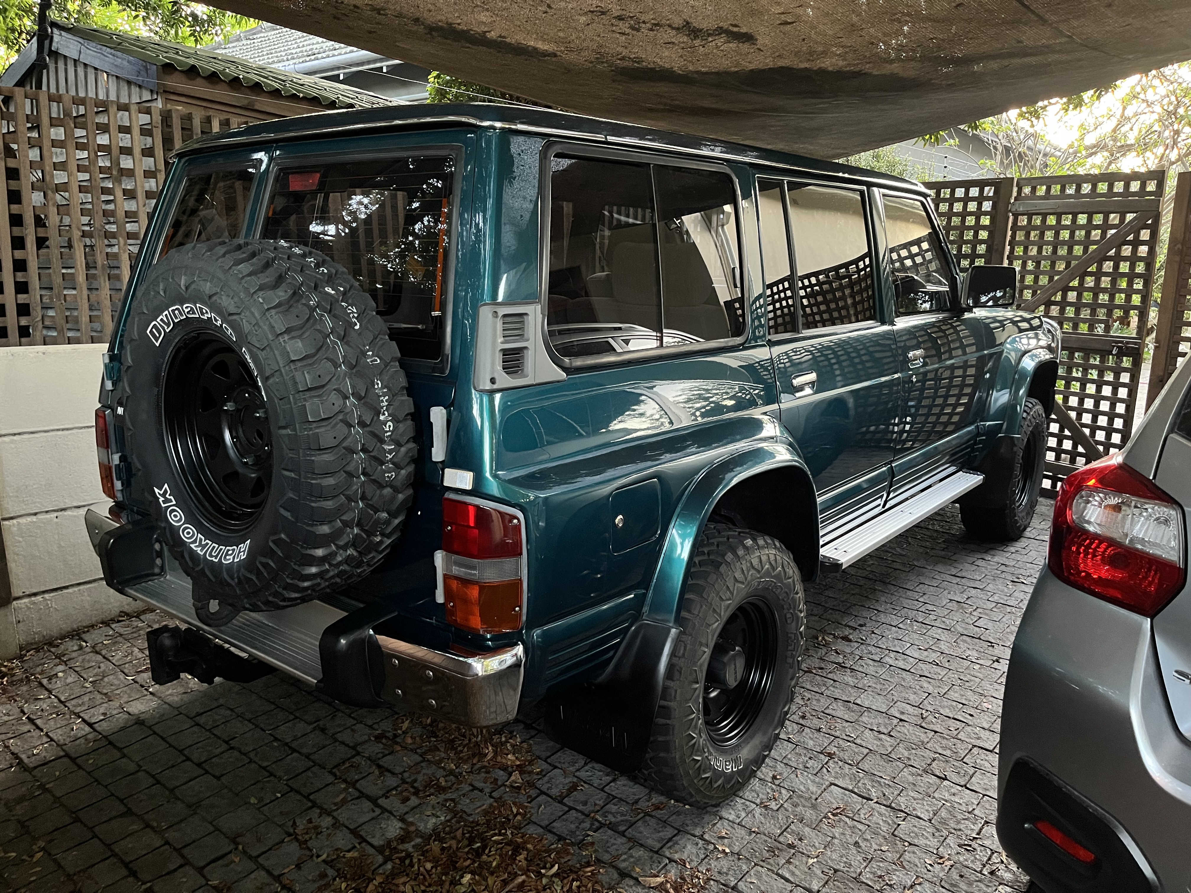

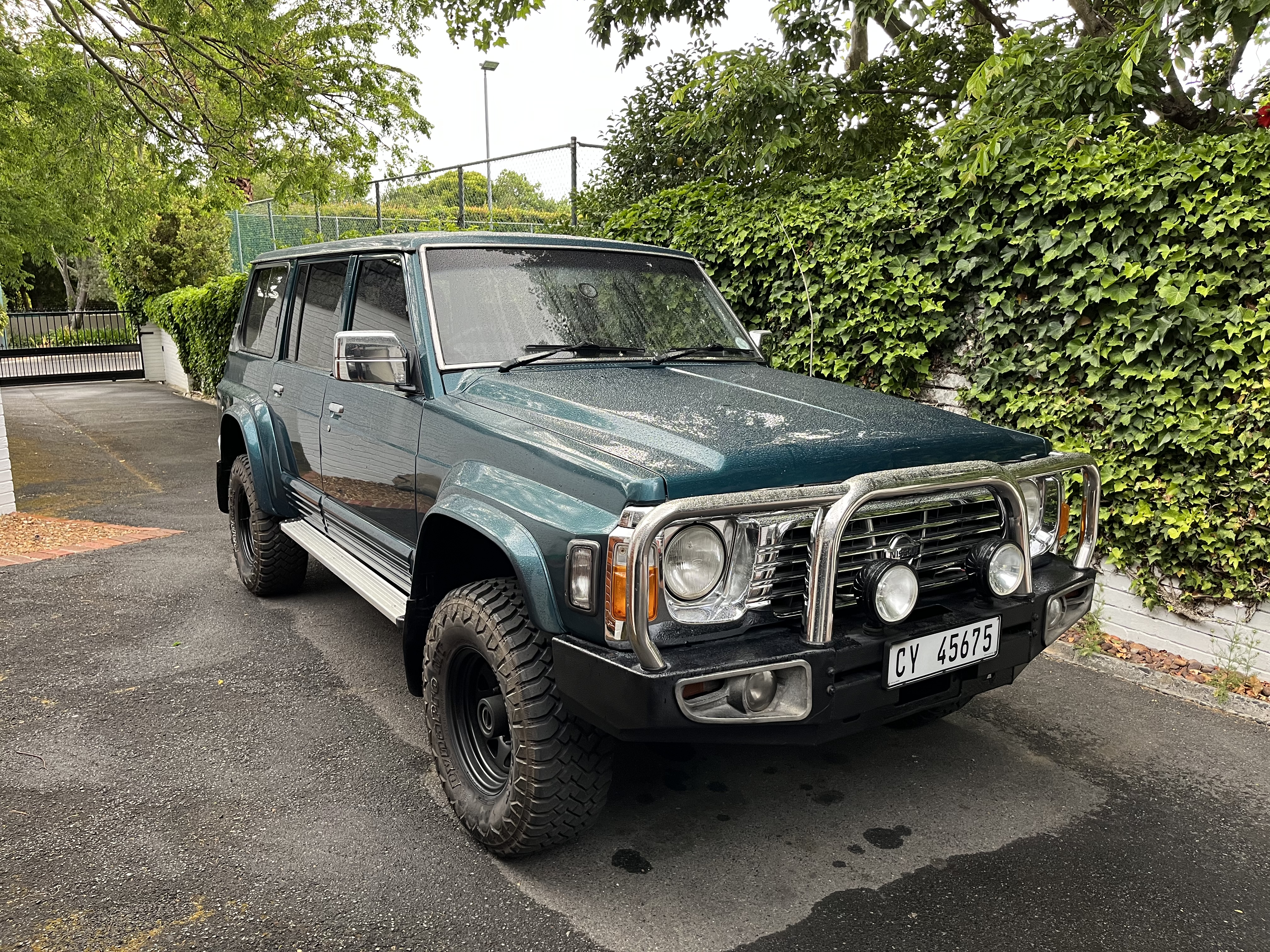

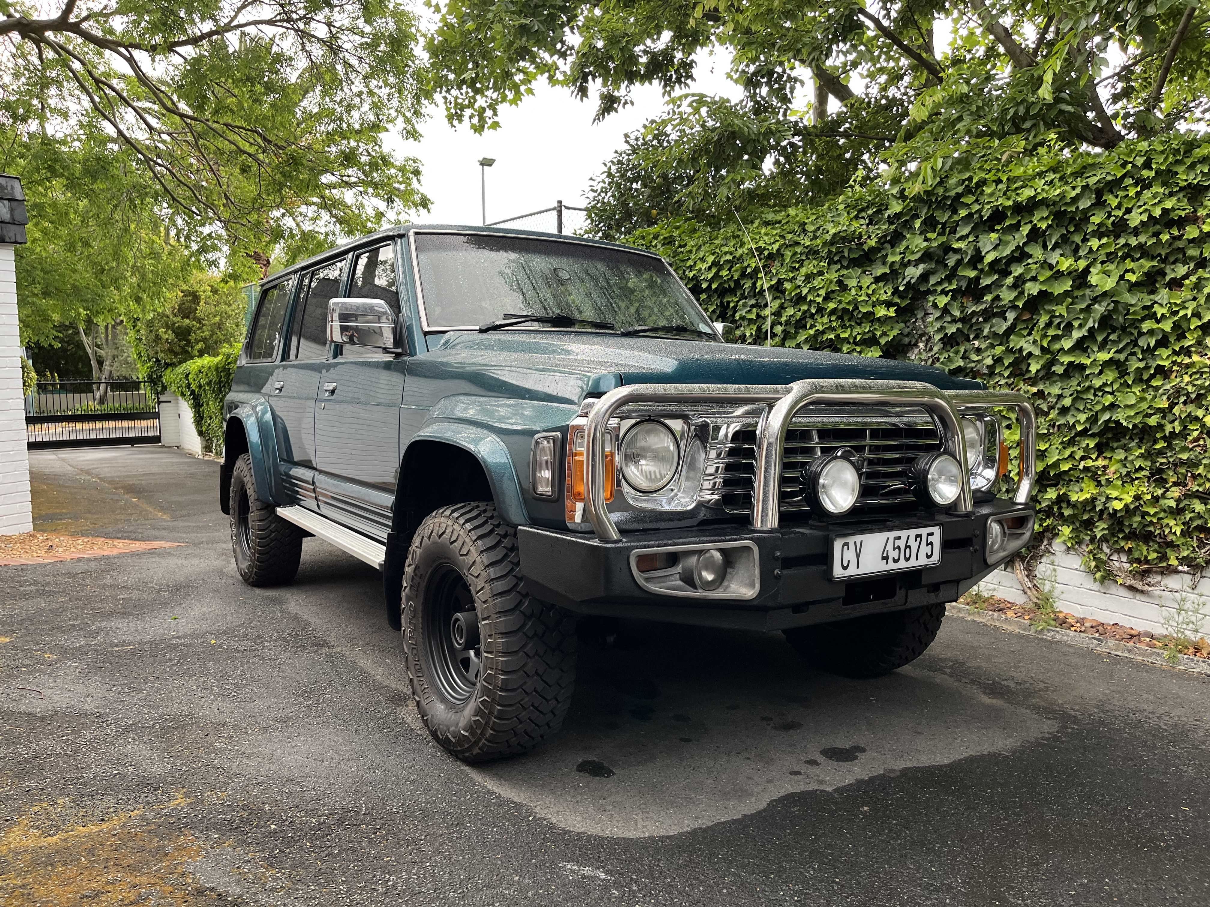

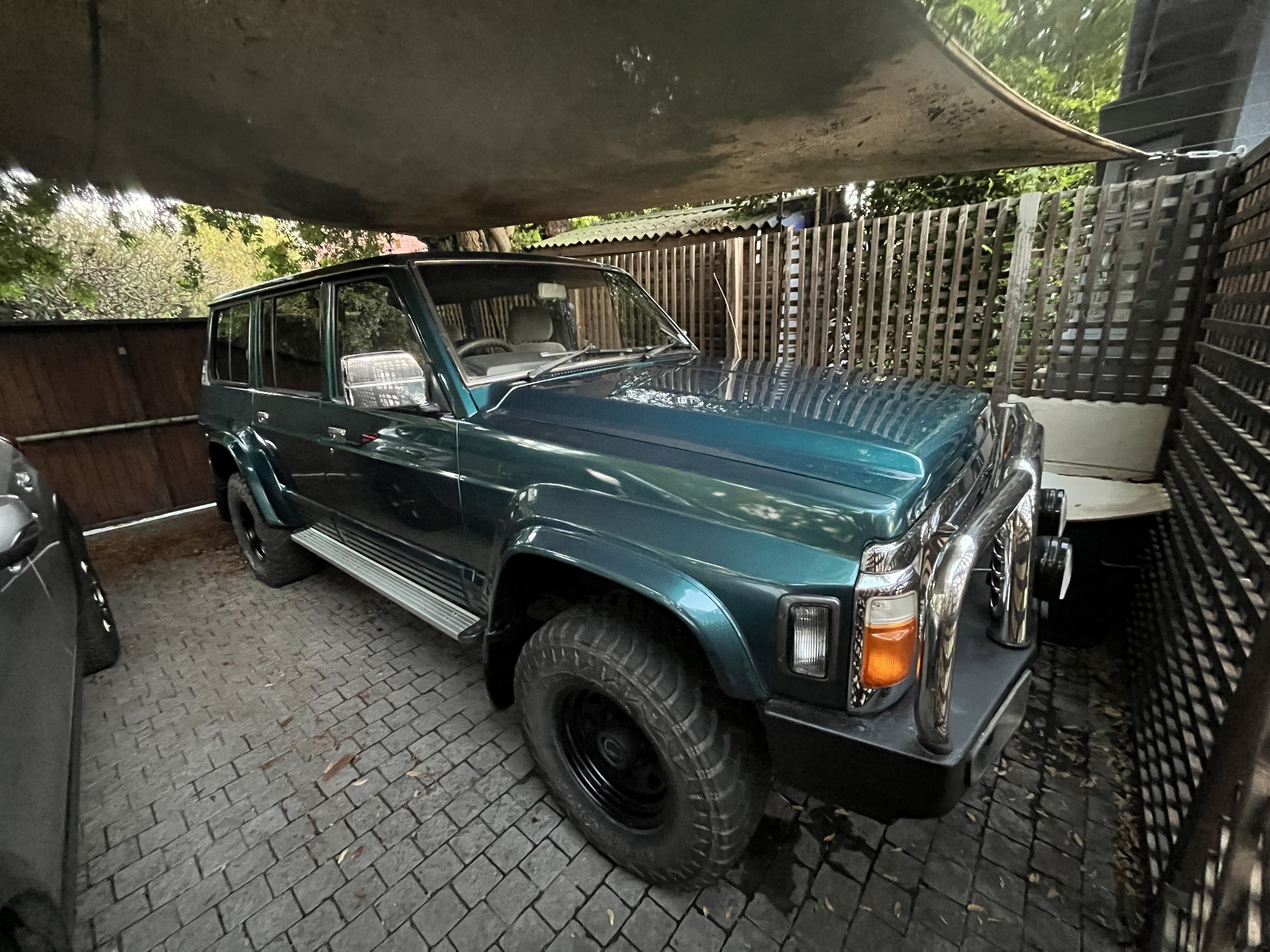

Hi everyone,
Just a short introduction, my name is Andreas, from Cape Town. Hi :salute:
I picked up my Patrol this past friday, 11/11/2022. Here are the details:
Nissan Patrol 4.2 SGL
1997
TB42s/Carb
Manual
Metallic Green
Cloth Interior
No third row
Rear Diff Lock (need to fix/check)
232xxxKMS on the clock (Speedometer wasn't working when I got it, so the odometer wasn't either, actual mileage may vary, will do an eNatis vin check to get a rough idea of last sold mileage. Speedo fixed now)
15' Black Steelies, 31x10.5 R15 Hankook Dynapro MT
EFS Shocks and steering damper
no idea on the springs, but the rig looks about stock height
The car is in pretty good condition for the age, little niggles here and there as to be expected, but overall I am very happy with it!
This is my second 4x4, I let go of my fantastic 2000 Mitsubishi Pajero LWB 2.8TD NL Blister Fender (Long Travel Bilstein shocks, 3" Lift, 285/75 R16 BFG KM3's, Custom Steel Bumper) in order to purchase the Patrol, so far not regretting it one bit, though I still do like and miss the Pajero, it was a solid rig!
I have a YouTube channel documenting my 4WD adventures, builds, trails, DIY's etc. Any support, subscriptions, views, likes etc there would be much appreciated:
https://www.youtube.com/channel/UCklYHs ... MNnx-BttzA
Nissan Patrol content to soon follow!!! :woo:

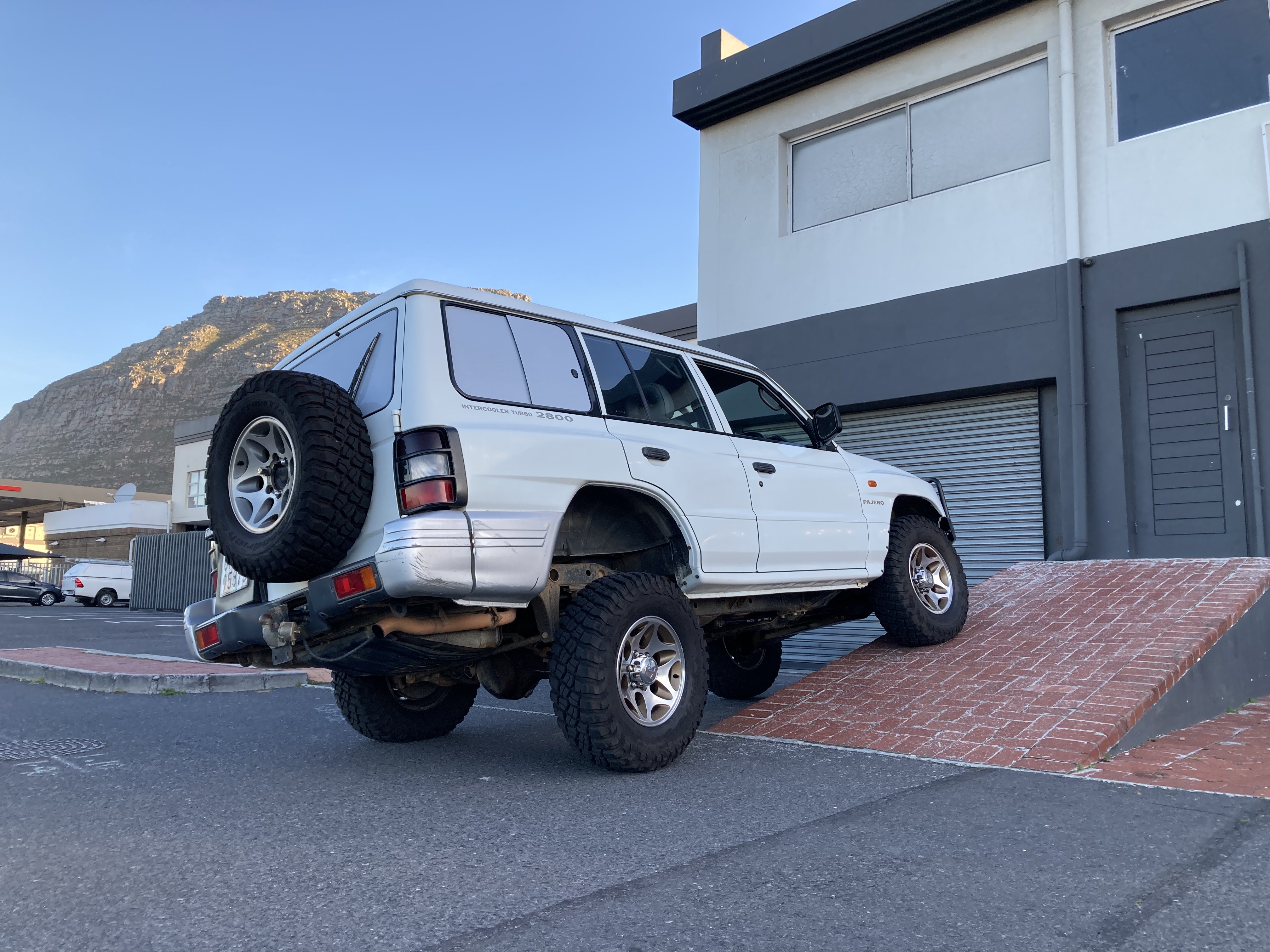

The old rig:

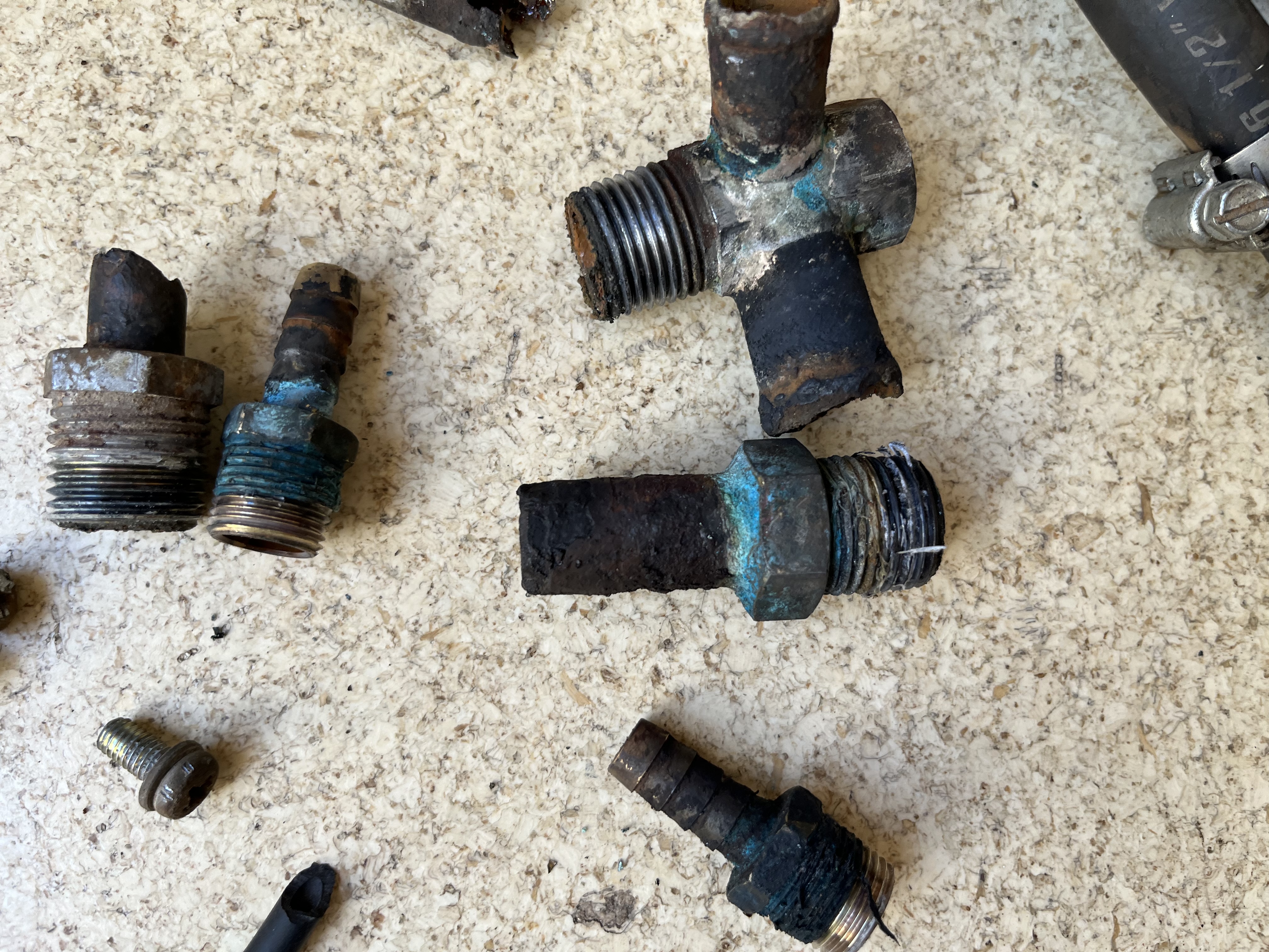

A little update on the build with some maintenance I carried out over the last week:
- Replaced all heater hose fittings on the engine, old ones were nasty!
- New fabricated intake manifold water hose pipe
- Replaced all the heater hoses, made up my own from the right ID/OD Coolant Hoses
- Replaced the fuel hoses
- Replaced quite a few vacuum lines, also put them in their right places, as they were a mess before
- New Coolant Temp Sender, Temp gauge now works
- Fixed wiring on the Transfer Case speed sensor to get the Speedometer working
- Fixed and cleaned up some bad earth's in the engine bay
- Fixed some wiring on the Transfer Case selector indicator
- Car was running super rich and lumpy after completing all the above, must have messed with the carb mixture adjustment screw by mistake during the work, tuned the carb a bit, and changed the spark plugs, all good now
