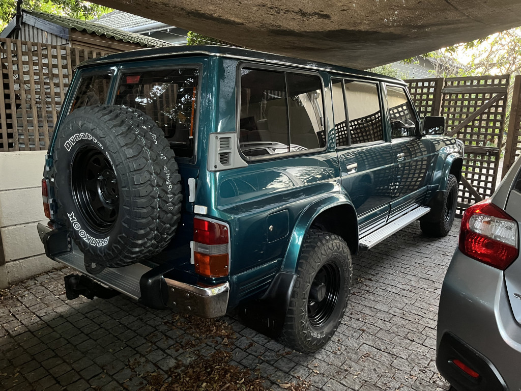

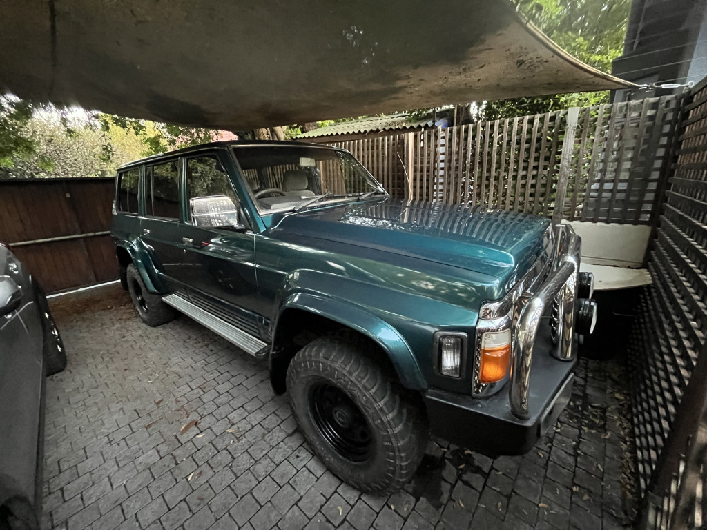

Here are the few pics of the new rig:

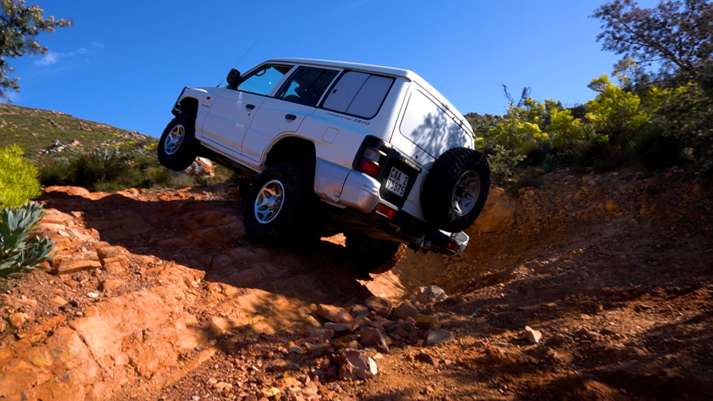

The old rig:

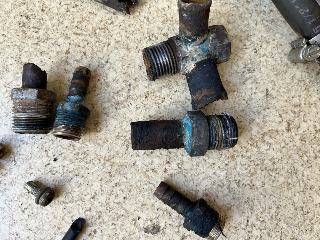

A little update on the build with some maintenance I carried out over the last week:
- Replaced all heater hose fittings on the engine, old ones were nasty!
- New fabricated intake manifold water hose pipe
- Replaced all the heater hoses, made up my own from the right ID/OD Coolant Hoses
- Replaced the fuel hoses
- Replaced quite a few vacuum lines, also put them in their right places, as they were a mess before
- New Coolant Temp Sender, Temp gauge now works
- Fixed wiring on the Transfer Case speed sensor to get the Speedometer working
- Fixed and cleaned up some bad earth's in the engine bay
- Fixed some wiring on the Transfer Case selector indicator
- Car was running super rich and lumpy after completing all the above, must have messed with the carb mixture adjustment screw by mistake during the work, tuned the carb a bit, and changed the spark plugs, all good now
