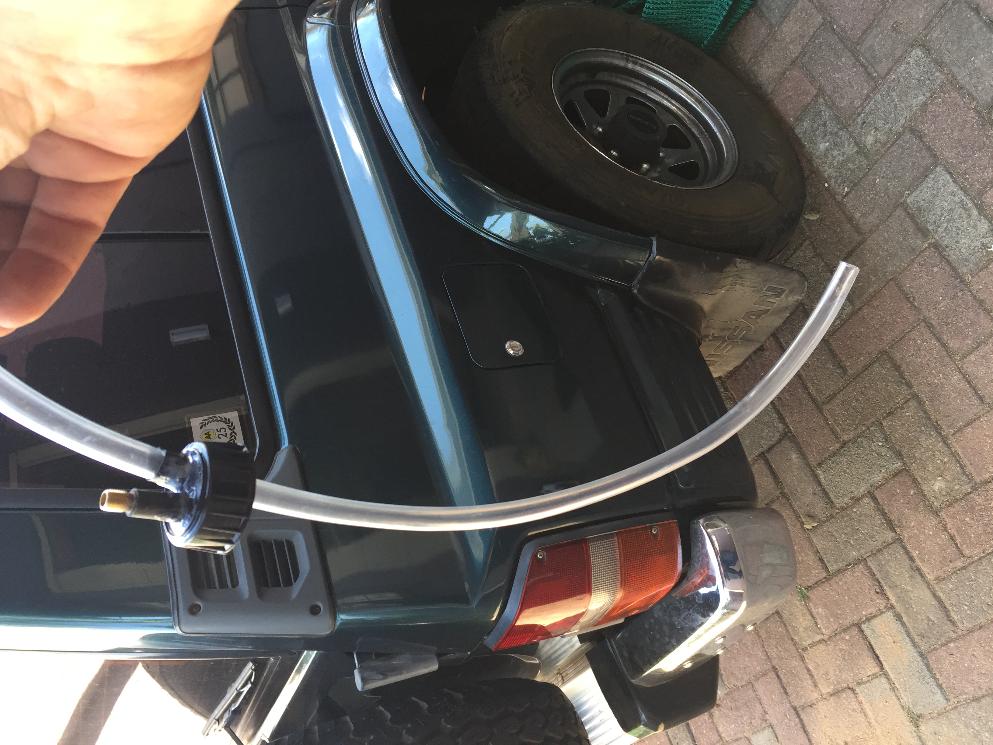

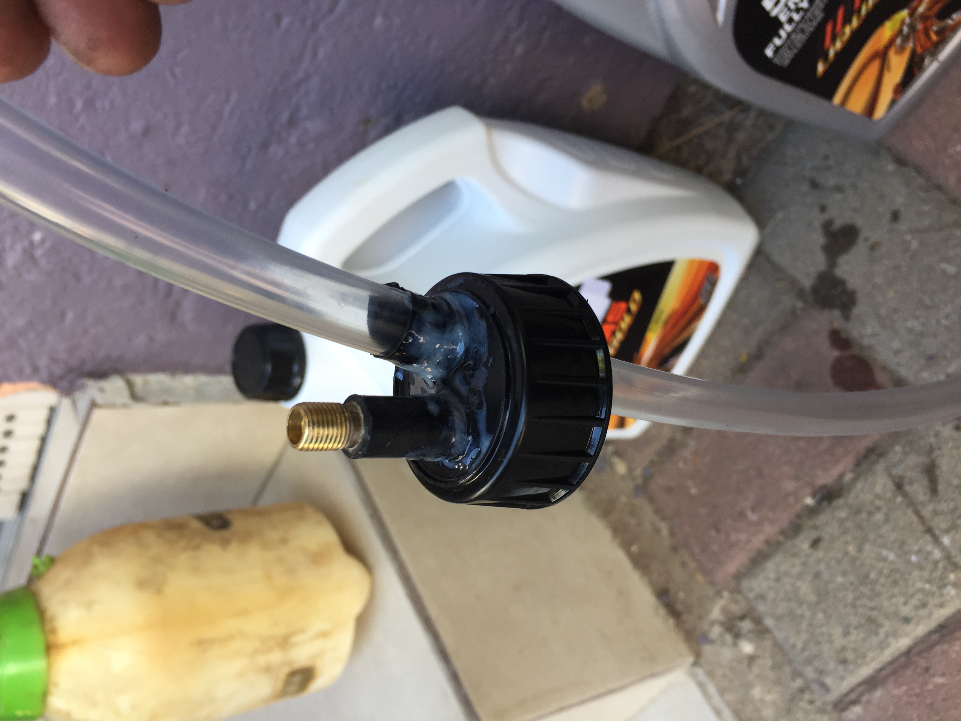

Constructed a lid with valve and pipe to pump the oil into the gearbox..

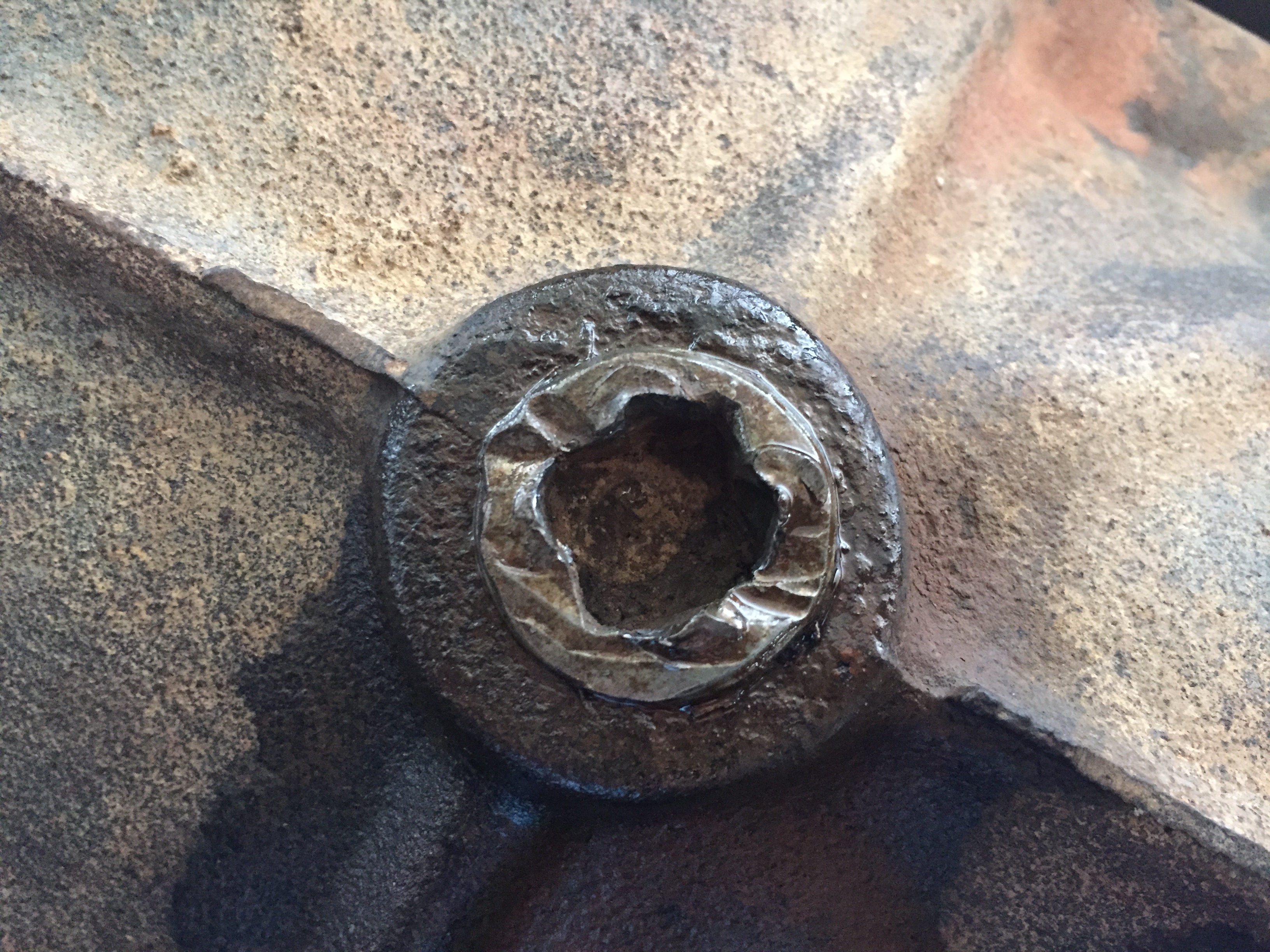

Then i discovered this.. :surprised:
Think i must first source a new gearbox drain plug incase i cant get this one back on again...that is now if can manage to open it without stripping it more than it already is...

And now Nissan cant find the drain plug from my vin number... :redface:
Is there any difference between tb42, td42, tb45 gearbox drain plugs?

SJC wrote: 24 Jul 2021 13:27 And now Nissan cant find the drain plug from my vin number... :redface:
Almal is dieselfde

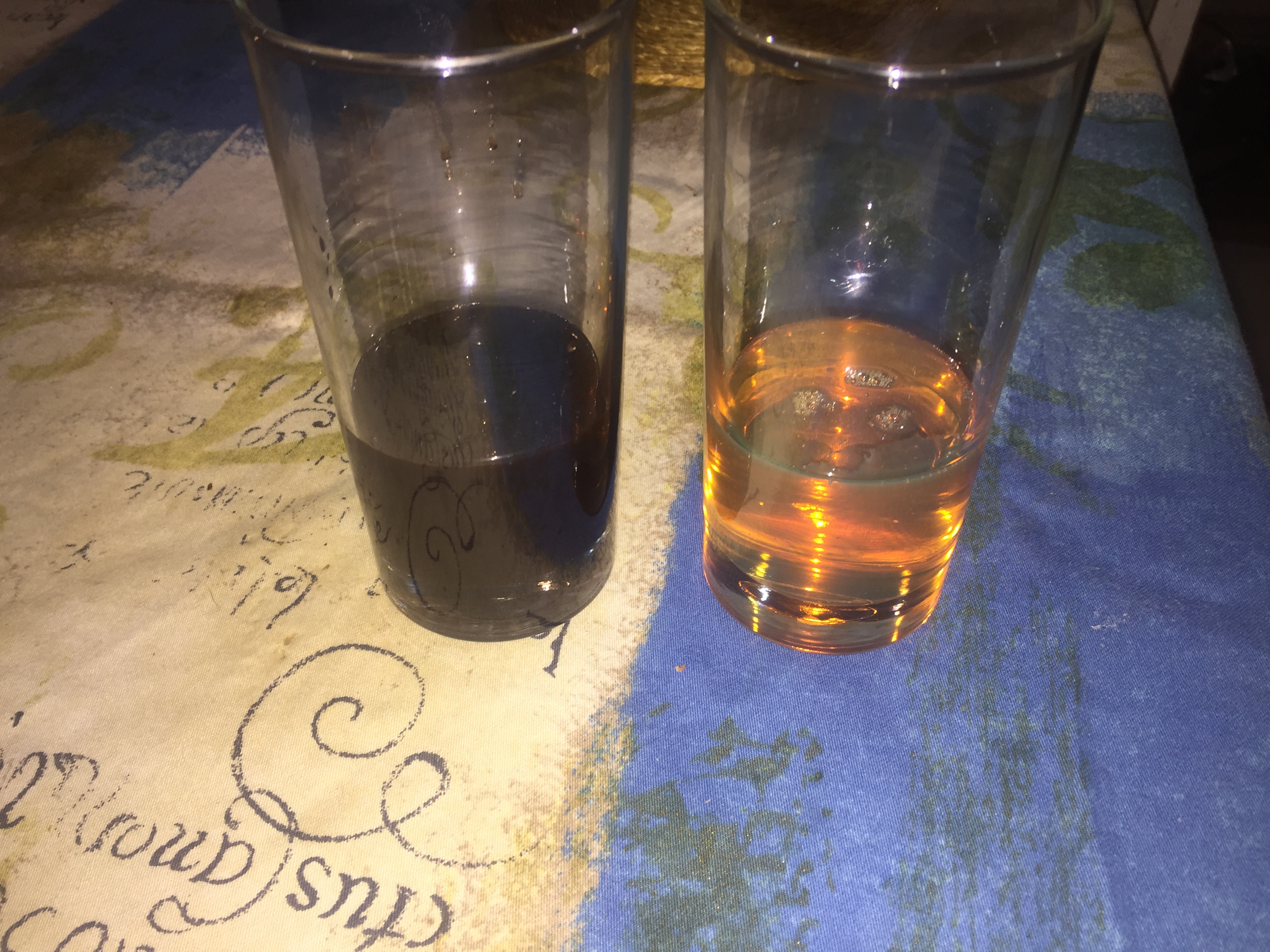

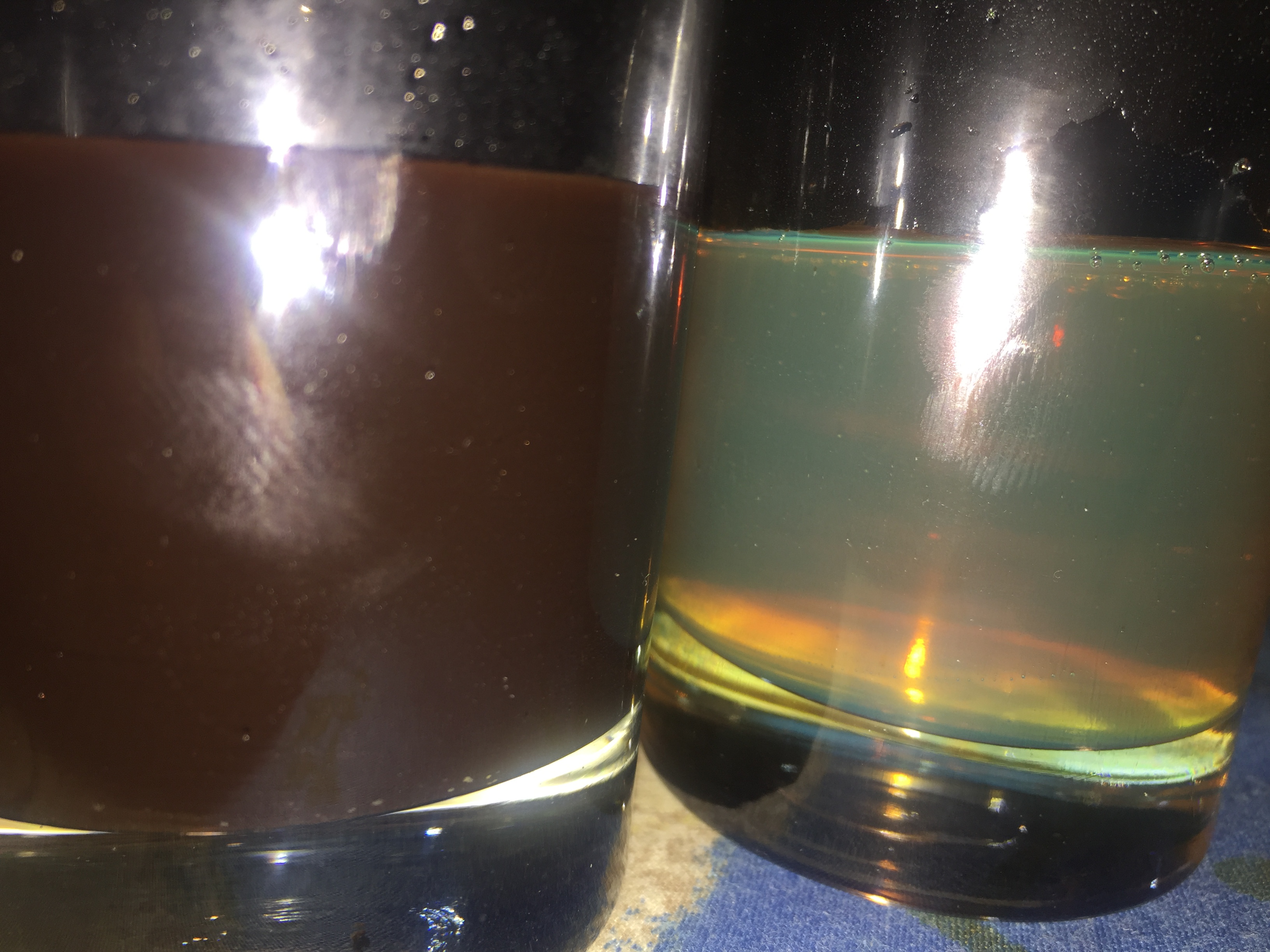

Old vs new.... :surprised:
Old oil ran out of the filler plug, can still not get the drain plug loose...
Been thanked: 473 times
Re: Gearbox Oil change
old vs new???..... no ways that's Beer vs Brandy & Coke.... :rolling: :rolling:
