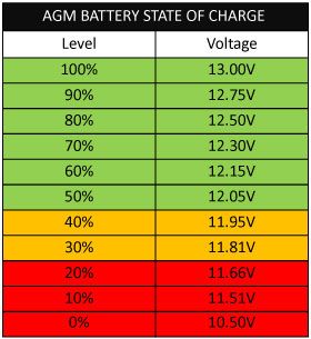

At what voltage is the AGM and or the GEL batteries fully charged and at what voltage should it sit 2 hours after being fully charged, with nothing connected?

Well on all 12v batteries - fully charged is 12.6v (let the battery stand for a few hours or overnight disconnected to normalize).
From 12.4v to 12.6v is considered "charged". 12.39v and less is considered discharged.
Lead Acid batteries: 12.2v is considered DEAD! Which would equal 50% of the voltage charge left.
Gel batteries: 12.35v would equate to 50% voltage charge left.
AGM: 12.3v as above.
BUT Gel can be discharged lower than 50% and still be able to be charged up to 100%. AGM batteries can also be discharged deeper than conventional L/A batteries with no damage, and have a lower internal resistance so can charge up very quick from empty - within a few hours, plus they have a VERY slow discharge rate.

Regarding my question about max voltage on GEL and AGM batteries: https://www.energymatters.com.au/compon ... discharge/
and also this on this
