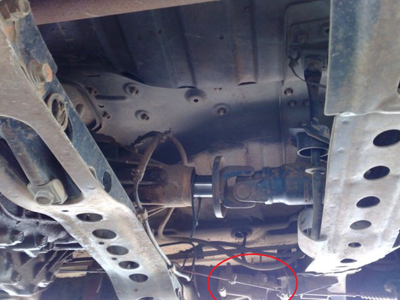

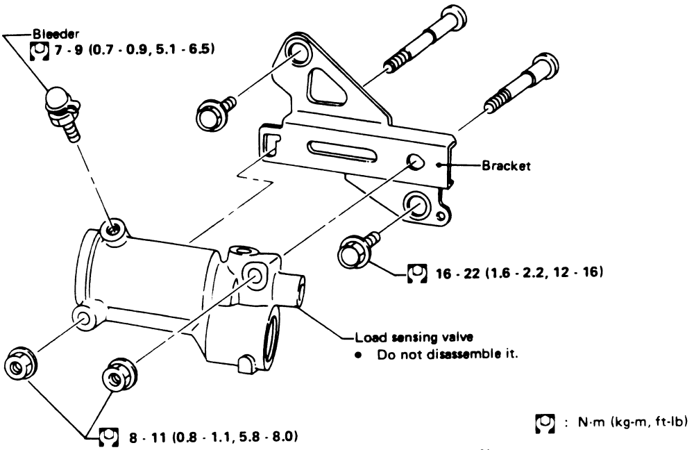

Peter, I do have a question though. On the Sani, there is device midway down the chassis in the braking pipe line. I was told that this device measures the angle of the vehicle and controls the pressure accordingly to the rear brakes. Is this possible, and if so, how sensitive is it, and I suppose it could be out of calibration if your vehicle is no longer standing level. Do you know anything about it?

David, unfortunately I haven't spent any time under Sanis.
In concept, it is possible. I would assume it would be possible to make it just as accurate as the system in the Y60/Y61, but that doesn't mean that the setup in the Sani is.
I also think it could be affected more by momentum, again, this depends on how it works, and having not seen one, I just don't know.
Changing the relative height front to rear would definitely affect such a system, but I also believe it would be possible to "recalibrate" it.

My friend Google has one or two articles of it. It is an alternative to that spring type that measures the distance between axle and frame. I can't find out exactly how it works, besides that it's not a serviceable item like the spring type, and can only be replaced if faulty. Out of interest, $320 plus postage and duties (OUCH). I can not find a picture online of the thing, besides this schematic and an accidental shot in one of my pics.

It looks as if the bracket allows some adjustment in angle, but of course there is no obvious reference on the body to set it up by.
Sorry, not being much help here. But it sort-of sounds like you have probably already solved the problem, although it would probably be a bit "safer" if the front end locked up before the rear (on the basis that a car that plows straight on is less likely to roll than one that over-steers and then slides sideways).
There are a couple of possible ways to gyppo it that might be a lot cheaper and simpler than trying to find disc brakes that can be made to fit:
1) Substitute the proportioning valve from the a Y60 or Y61 (or something else).
2) Have the slave cylinders sleeved down to a smaller size. This will reduce the force on the shoes,

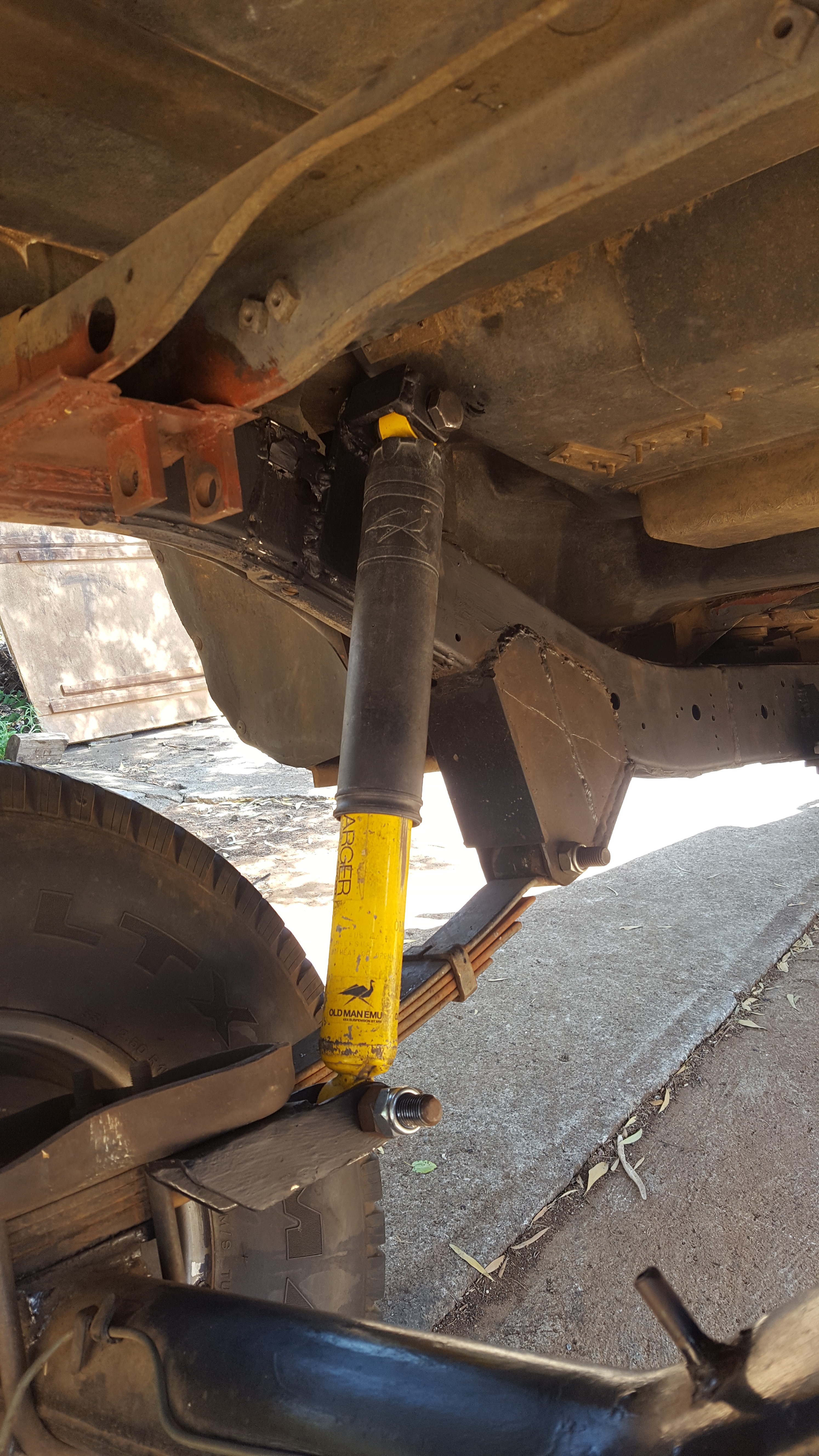

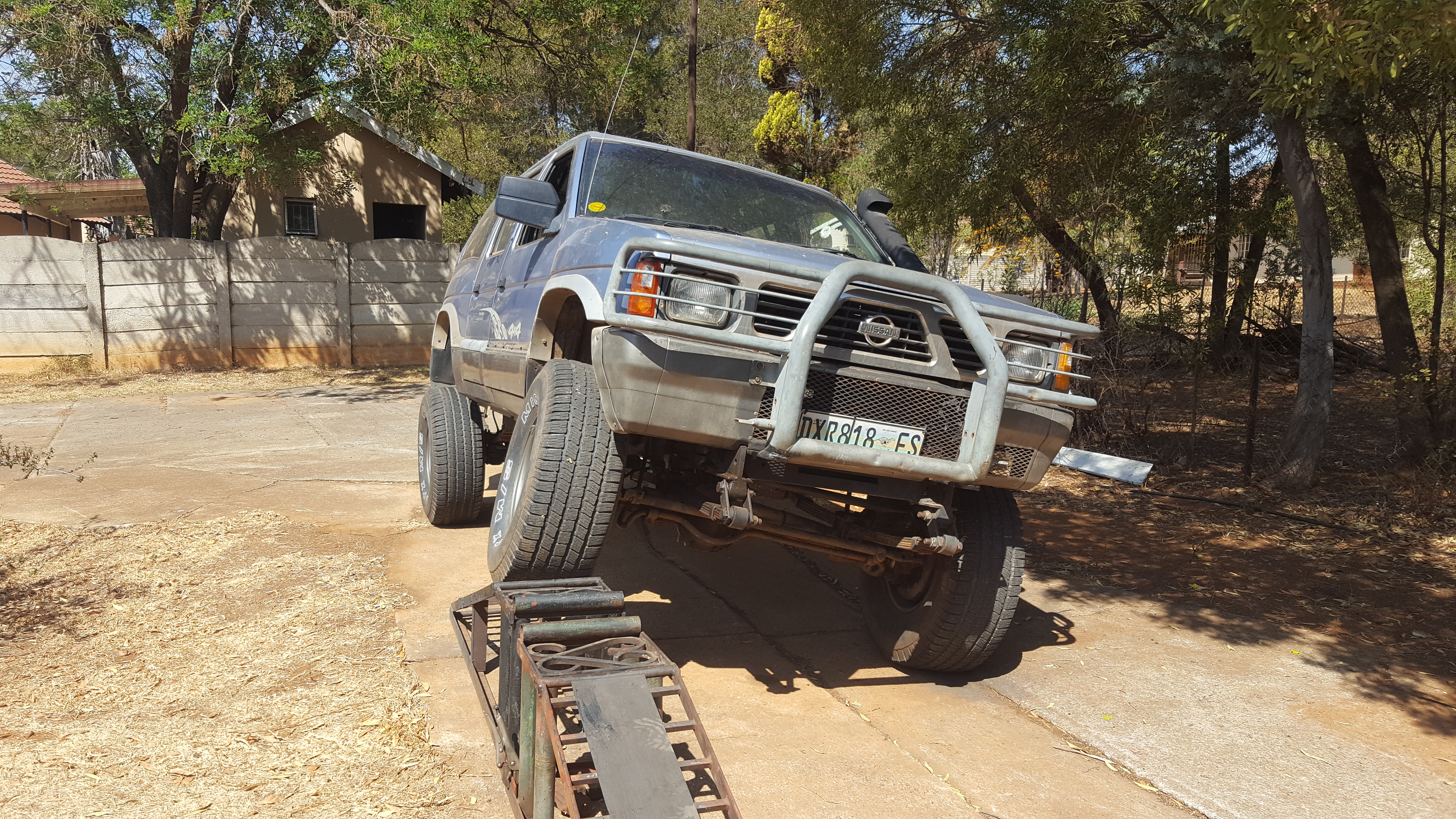

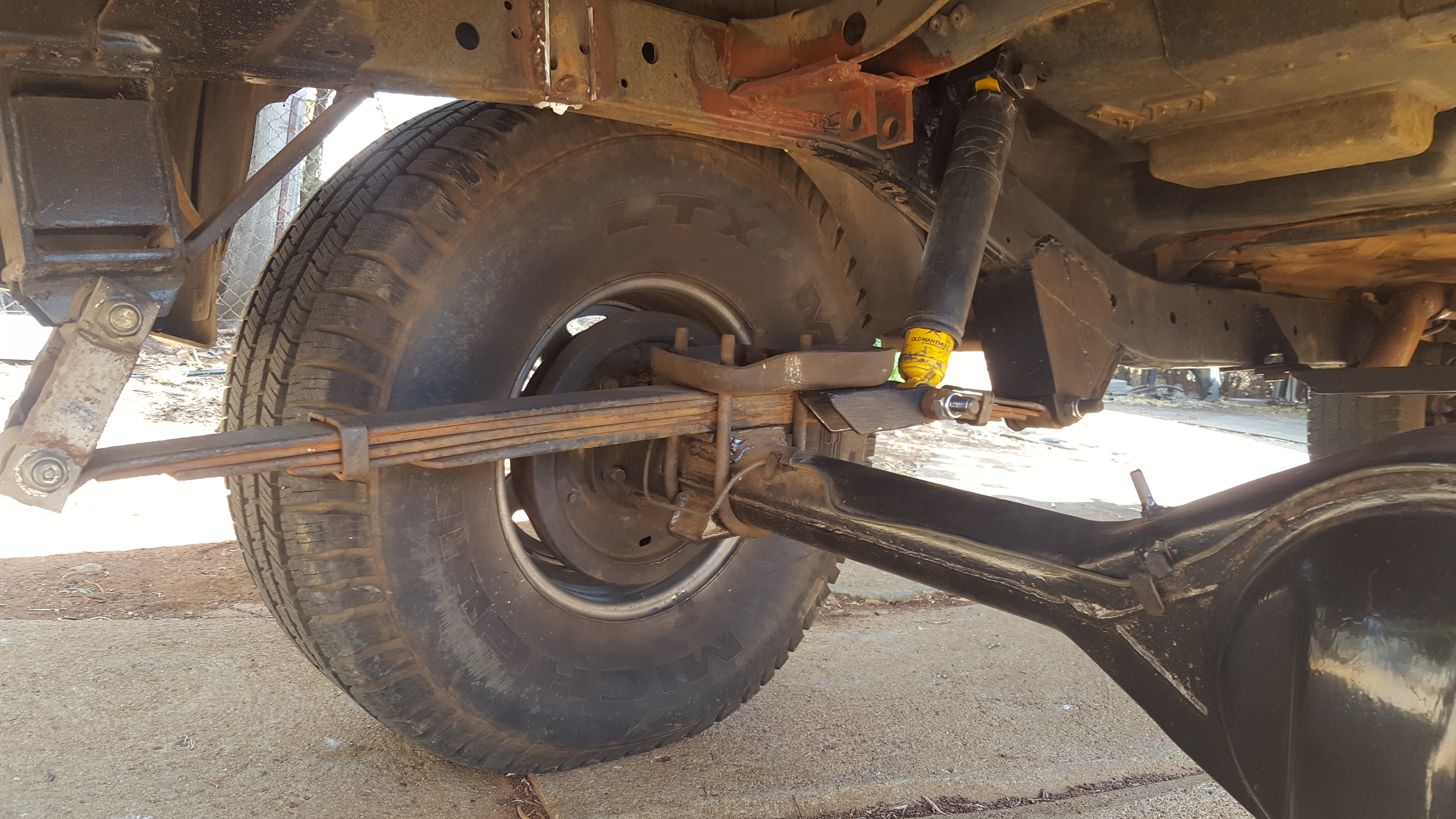

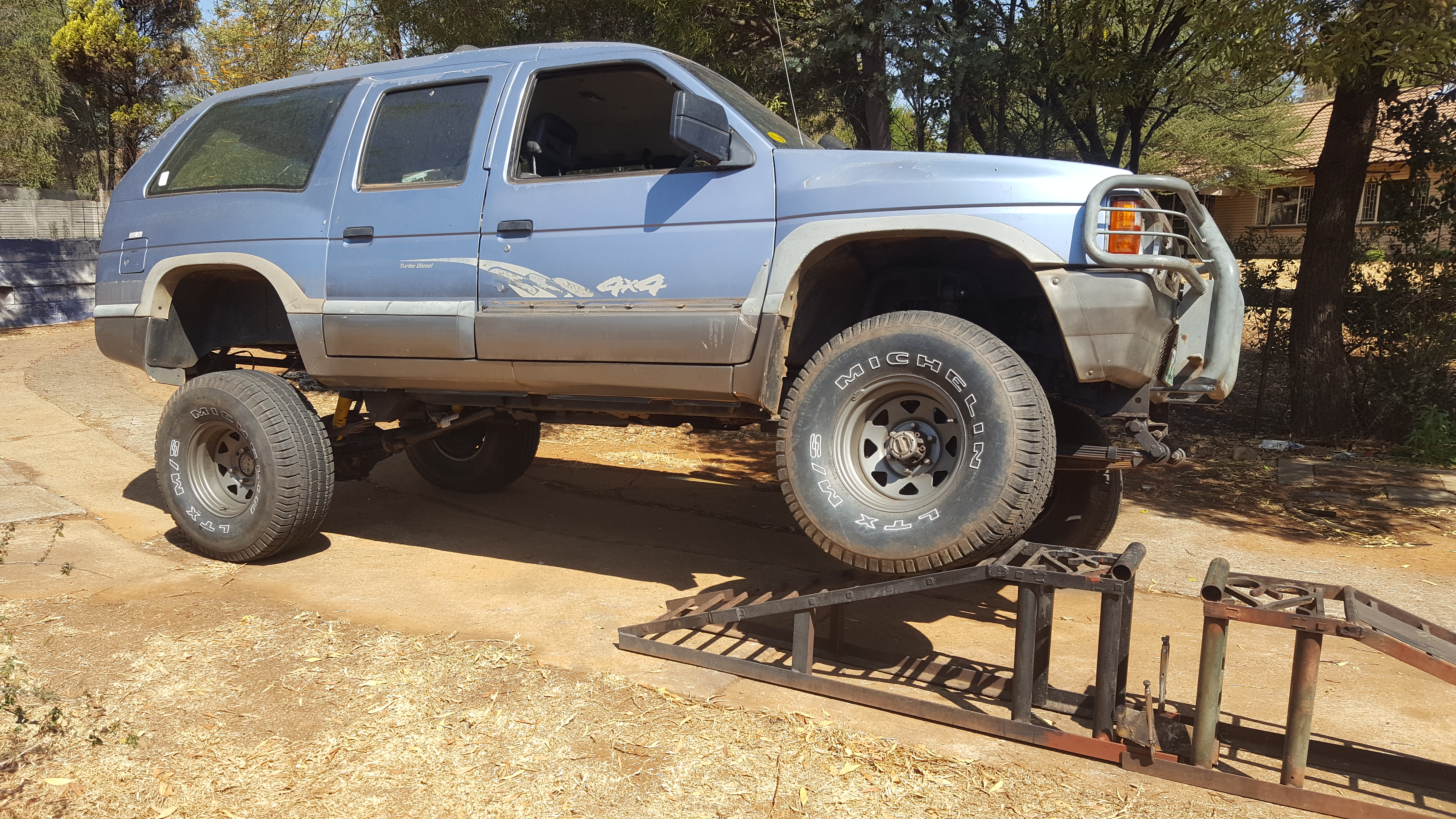

Today the Sani got it's rear shocks sorted. I kinda tried keeping in mind that the suspension would change later (agian). The chassis side will hopefully not change again. The axle side is bolt on at the moment, juts bolting into the standard Safari pin type shock mount on the leaf spring plate. I went with the OME shock that was donated long time back to the project. I don't remember who the Patrol owner was, but thanks, they work a treat. A bit stiffer than the Safari shocks that that I was running before. So teh OME must be way stiffer as they are at a fair angle compared to the Safari that was virtually straight up.

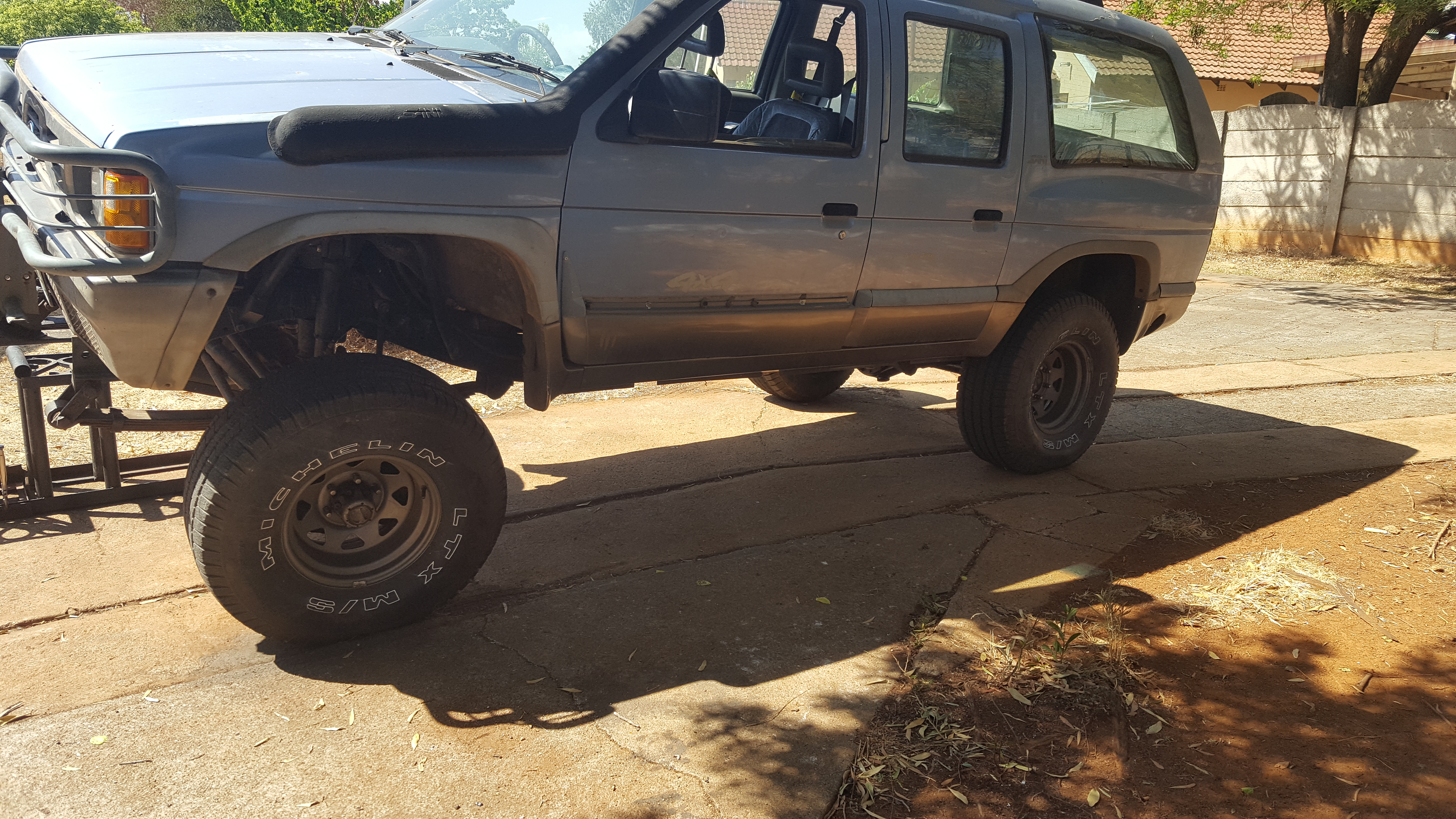

and some more flexi pics for good measure

I also put the rocksliders back on so that the wife can get into the Snai again without a coke crate. She kinda finds it embarrassing.
