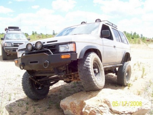

Lots of planning, and I am sure we have missed some stuff. When I last took to it with a tape measure, I realised we would also have to cut the sump or end up with a 30cm suspension lift. So now after all done, I will need to evaluate the capacity of the sump. My diesel mechanic tells me you do not want to go under 6L of oil on that motor, and that is already border line to include an oil cooler into the system.

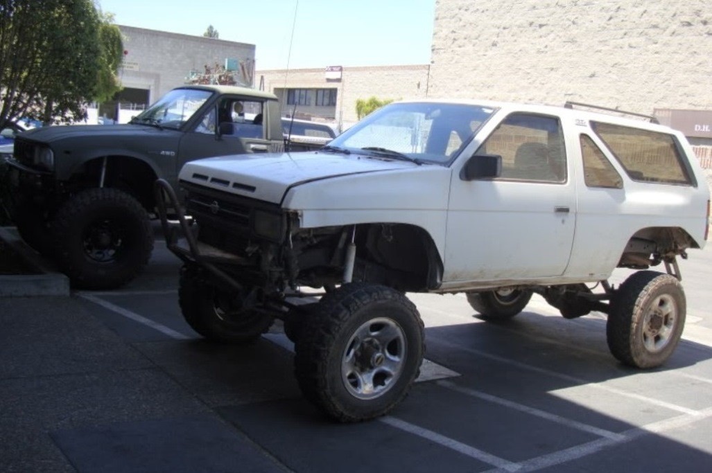

This is about a 300mm (12") lift :surprised:
I am hoping for something more like this...around 100-150mm (4"-6") lift.

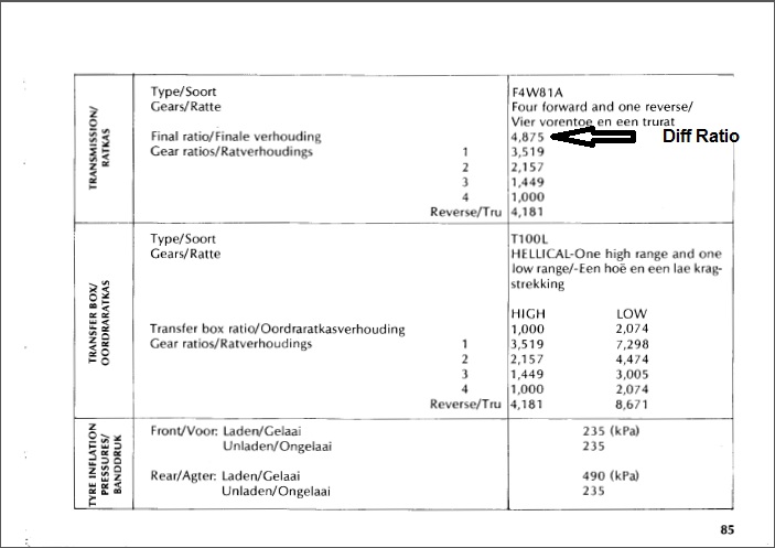

The Safari's diff is 4,875 :oldtimer:
Check the Owners Manual:
Diff Ratio.jpg (62.98 KiB) Viewed 19435 times

Thanks Kobus, I saw that page that you posted on my thread on the Nissan forum.
That helps us a lot with having diffs that are already matched ratio, and take the rims I already have.
