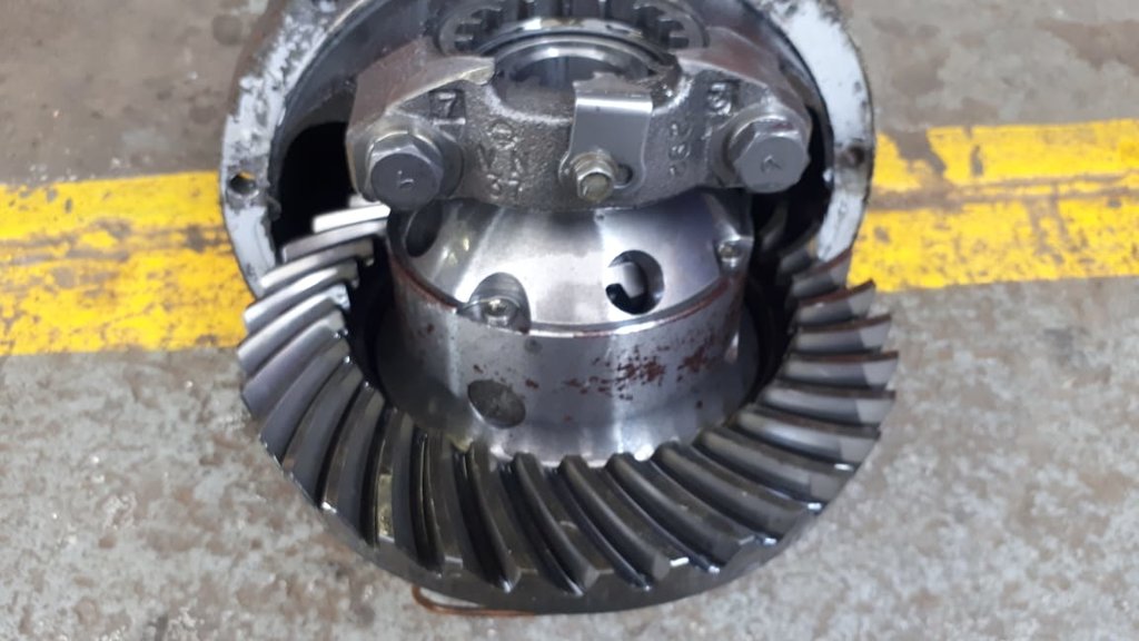

Hi Guys..
I recently sent my Diesel in for a front locker fitment, I had planned on fitting a LOKKA.
The fitment shop called me last week to let me know there was a problem with the installation...
"Good day sir, we are unable to fit the locker you supplied because there seems to be an ARB Diff Lock already installed"
So because the ARB is a complete carrier replacement I am kinda stuck with it (not that I am complaining), so I have decided to get it operating again.
Does anyone have any good ARB parts knocking about that may be for sale? I need everything from the diff to the switch - I am particularly looking for a compressor as this is a costly item.
please let me know if you are able to help.
Cheers
J

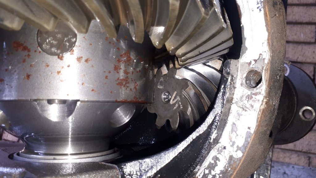

Fingers crossed the unit is ok...
Some surface rust on it... hope the seal faces arent pitted.
Been idle in there for many many years.

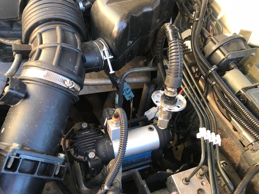

Re: ARB Compressor
I have an ARB front locker with the compressor mounted in the engine bay. Two switches mounted under the 12V cig plugs under the aircon dials. One for compressor and one for locker. Just like Kagiso - switch pump on, 5 sec, switch locker on. It switches off almost immediately (compared to the back and forth of the standard rear diff lock)
I reckon the ARB compressor is well worth the expense. it is t he smallest one of the range and you were going to put a lokka in anyway! I have run an extension from the engine bay to the rear tow hitch so that i dont have to open the bonnet to inflate tyres and no longer need an extension to get to the trailer.
I have never had the compressor overheat and I regularly pump from 0,8 bar for all 6 tyres. MTCW

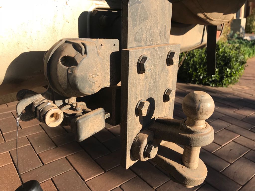

Re: ARB Compressor
For interest ...
Connected a standard ARB orange extension hose and ran it under the car
So that it exited at the tow hitch. used a simple door stop as a cover Internal switches
