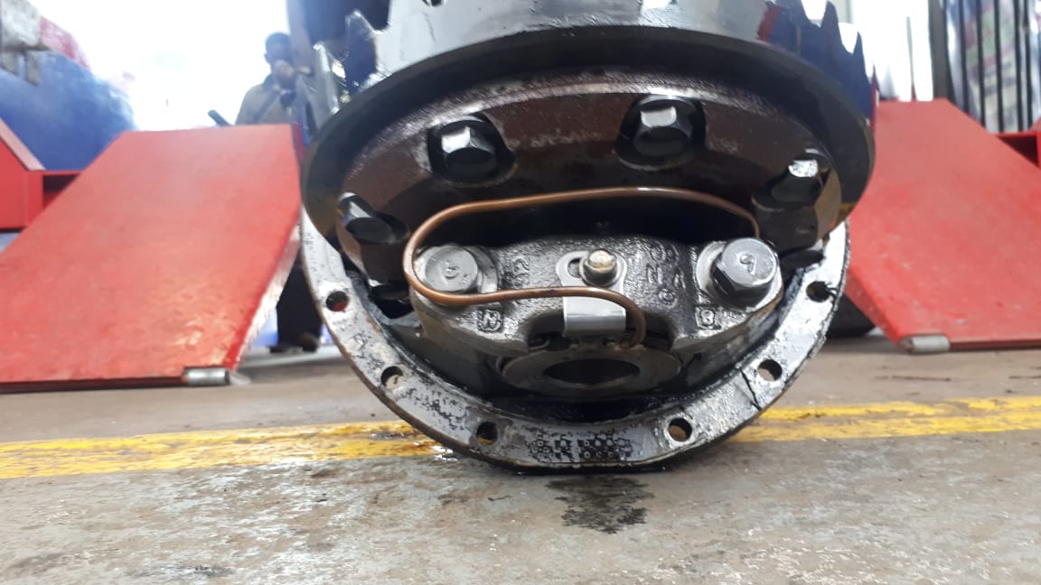

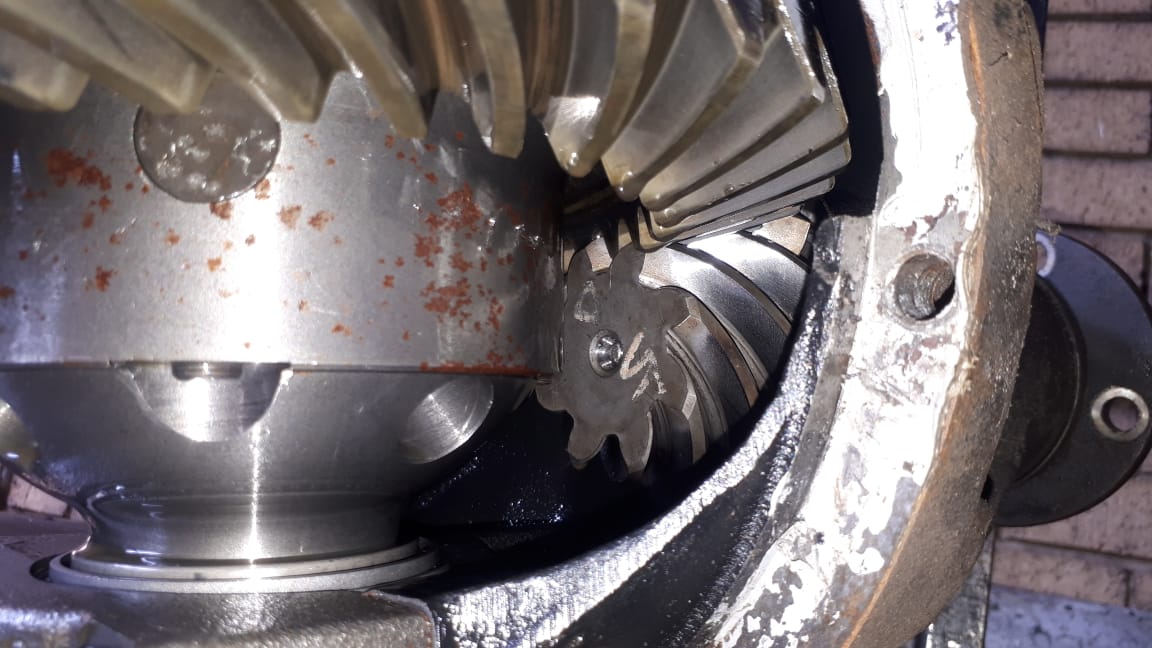

Hi Guys..
I recently sent my Diesel in for a front locker fitment, I had planned on fitting a LOKKA.
The fitment shop called me last week to let me know there was a problem with the installation...
"Good day sir, we are unable to fit the locker you supplied because there seems to be an ARB Diff Lock already installed"
So because the ARB is a complete carrier replacement I am kinda stuck with it (not that I am complaining), so I have decided to get it operating again.
Does anyone have any good ARB parts knocking about that may be for sale? I need everything from the diff to the switch - I am particularly looking for a compressor as this is a costly item.
please let me know if you are able to help.
Cheers
J

Re: ARB Compressor
Fingers crossed the unit is ok...
Some surface rust on it... hope the seal faces arent pitted.
Been idle in there for many many years.
